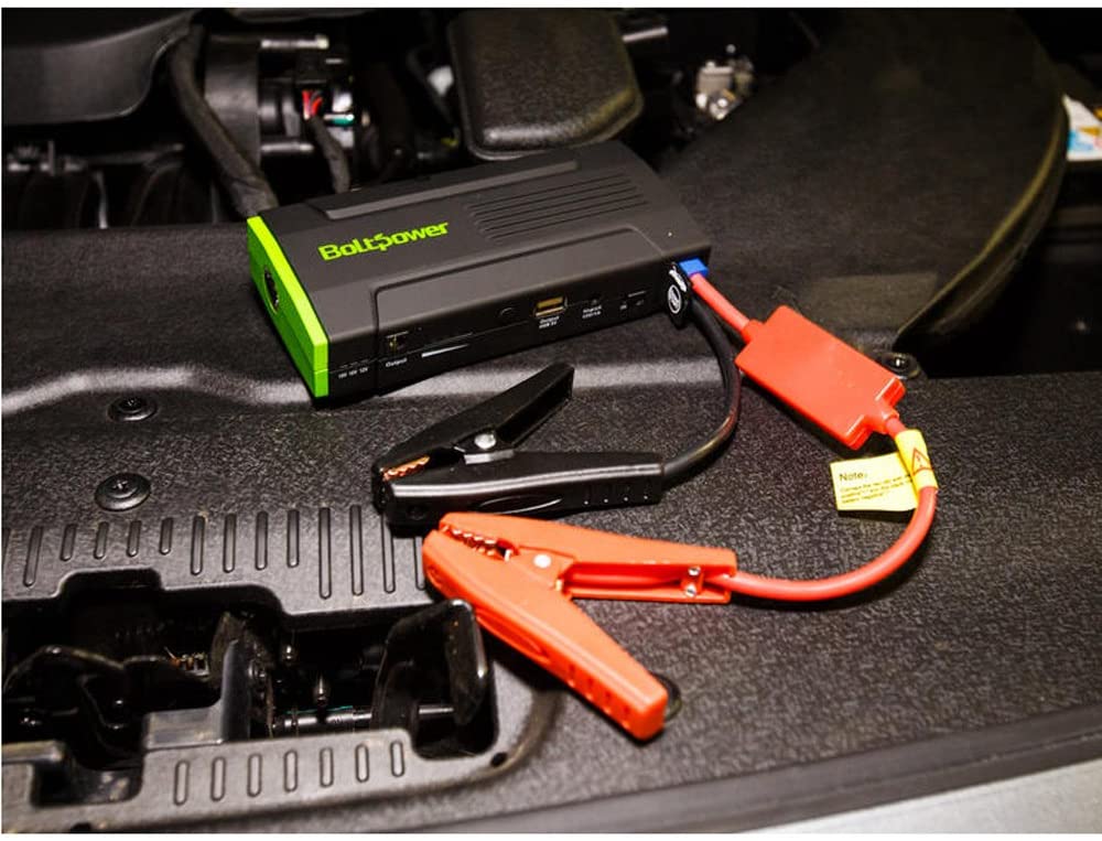

Up until my battery went flat and I went to jump it with my BoltPower D28, I was well impressed with said Bolt Power. It's a still a great bit of kit and as rare as hens teeth now (and mine is new and unused!!!) so it seems however the jumper leads are not long enough to reach the battery connection points in the Ducato engine bay.
So whilst it is a nifty piece of kit its not much use for the MH...or at least the Ducato based MH's.

What model Ducato do you have? I'm struggling to understand how you can't reach the jumper points.
The D28 has very short leads. The distance between the earth point and the remote +ve terminal would be a stretch. d28a.jpg

It doesn't quite reach: short by a few inches.
I had a look to see if there were extended leads available but couldn't find anything. I emailed Bolt as well but don't hold out much hope tbh...
FWIW, I was going to recommend the Noco GBX45 pack I bought from Amazon a few months ago. Although it's now priced at £134.96, it was quite a bit less expensive then. However, I suspect you won't get any real additional functionality as it has short cables also.
I wonder whether getting a decent set of jump cables and using one to extend either the +ve or -ve of your Bolt Power would work...

Couldn't you get it on the remote positive and the negative on a large lump of engine nearby?
Possibly, if I knew what I was doing....
GMJ he has a good point. All of the chassis and all of the engine are good earthing points. So find something that is bare metal and that will do the same job as the earth point. I'm exercising my memory but can't recall what is near that remote terminal, butr there must be something. Just don't use anything with paint on it or less than a cm thick.

If the leads are too short for engine bay connection you could probably do it directly to the battery.
On a X250 the two jump start connections are 280mm apart, about same distance as the main battery, the nearest bit of 'bare' metal doesn't appear to be properly earthed, not sure on X244 or X290.
