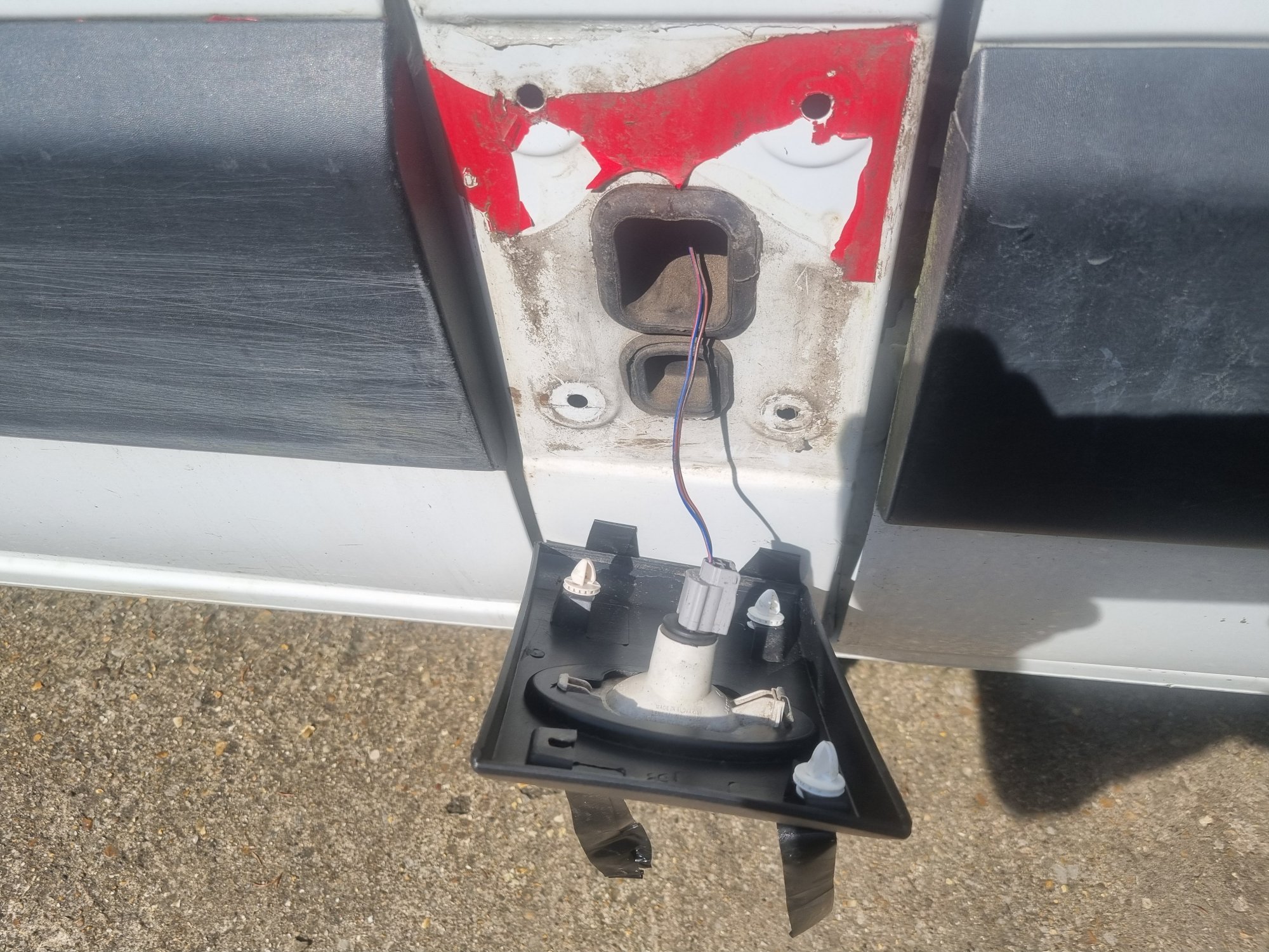

I recently bought a new panel for my side marker light on the van which is held in by 4 plastic retainer clips. Try as I might, they won't push home into the corresponding holes;
Is there a special way of doing this? They push in and fit the holes fine when not attached to the panel.

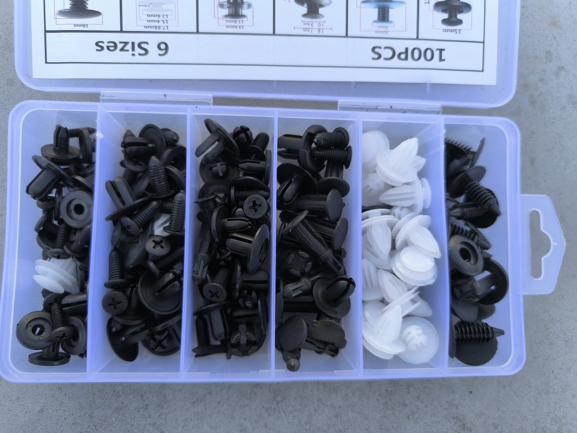

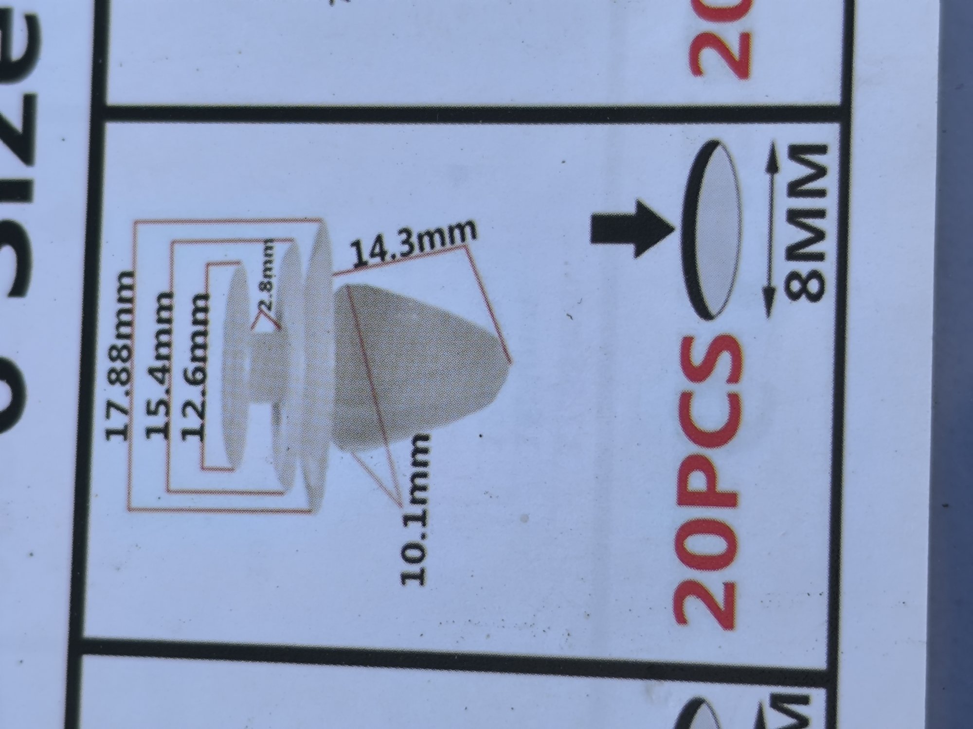

They are the wrong ones, on temu you can buy a mixed case full which i have got and you want the single compression ones with no centre plug, if stuck i will see if i have and post, but most motor shops should have them Rob.

True but almost impossable to refit, same happened when i fitted a new winder unit to my car, had to use ones with no pin, also a very hard thump with the palm of hand to get them home.

Cant find them on temu but any m factor will have a few, prob with the old ones is once fitted they cannot be reused.

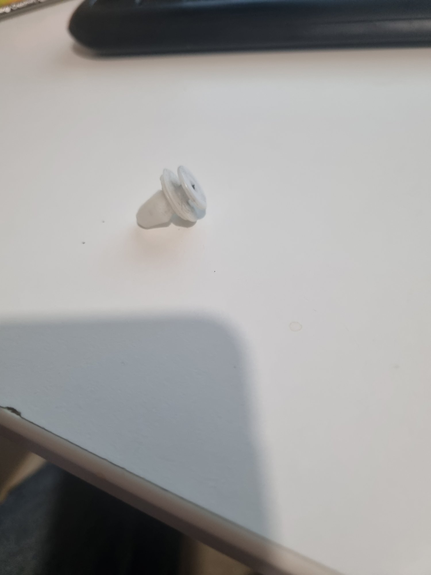

Here they are just found
Here's a fleabay link to the set Trev found - also on amazon for a quid more!
Linky

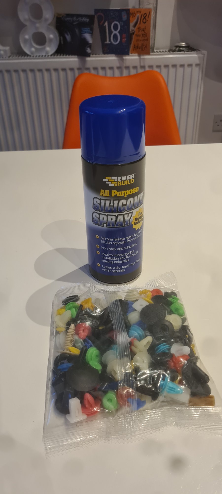

As said, silicone grease is a good idea (although silicon and silicone are two very different things!)

I think the problem is that the brackets which hold the pins inside the panel do not hold the pins flush with the edges of the panel - they are set about 5mm inside the panel so the pins won't push in 'to the hilt'. My fault for not buying an OEM panel from Renault (this one came from Amazon).
I will see what Steve and the finest brains of WC can come up with at Hereford but I suspect I will have to get another panel from Renault.
