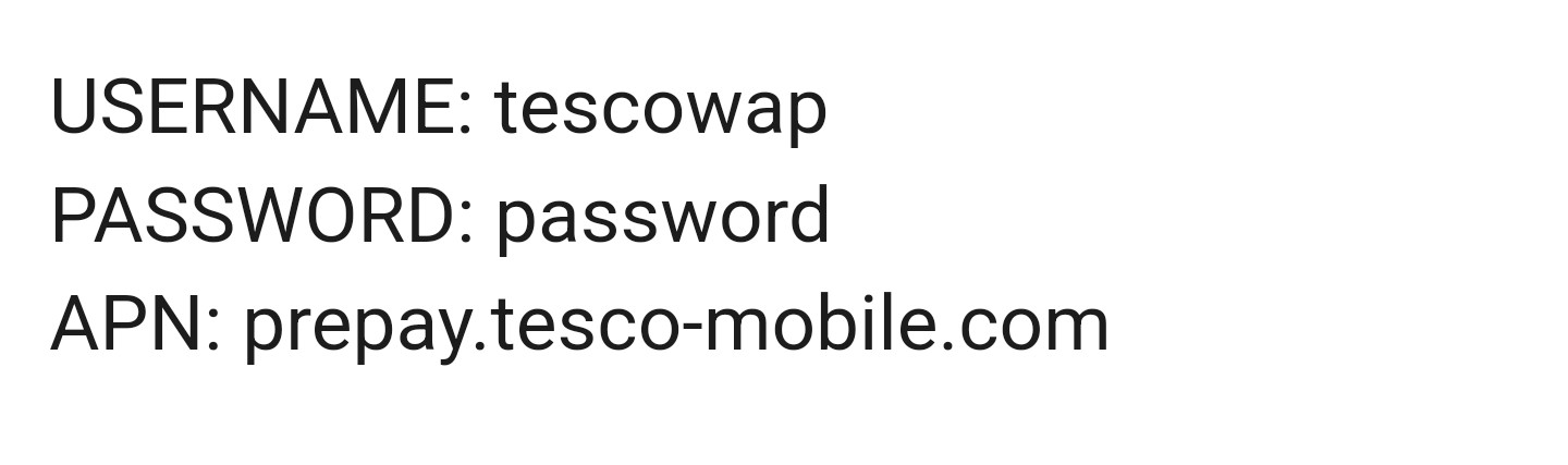

Could you log into it with the Lebara (working sim) and add another APN using the sim card settings for the Tesco sim? Then shut it down and boot it with the
Could you log into it with the Lebara (working sim) and add another APN using the sim card settings for the Tesco sim? Then shut it down and boot it with the Tesco sim in and then choose the Tesco APN from the drop down box in the settings, by default the APN is set to "Auto" but I've always had to add the APN for each of my sims. Just to say I've never used the app as I always log in using the web interface.

Wow, that worked. Thanks very much, Del, for your lateral thinking and thanks too to Canalsman for the router settings and everyone else on this forum who provided suggestions. One question remains - what if I hadn't a SIM that was recognised by the router so that I could change the settings?
