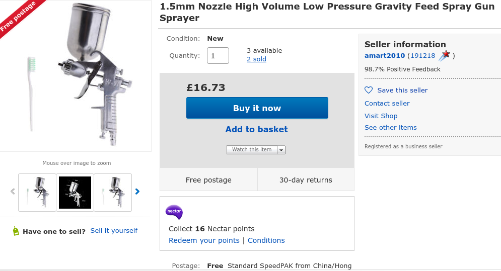

Shot blast first to get a good key,then a 10thu coat of 2 pack zink epoxy primer followed next day with 2 pack polyurathane,use juton clark or sigma if possable.
Use a gravity gun with a 1.5 w71/w77 2.5 nozel,these from china are very very good for the money with a side swivel cup,they are copy of anista iwata which are very expensive,same as i sprayed my van with.

Use a gravity gun with a 1.5 w71/w77 2.5 nozel,these from china are very very good for the money with a side swivel cup,they are copy of anista iwata which are very expensive,same as i sprayed my van with. View attachment 80281View attachment 80282
Bloody hell Trev I'm not fettling a Rolls Royce,cheap is the byword here,you've just blown my budget on a sprayer 😅when a brush/roller is already in the kitty.
