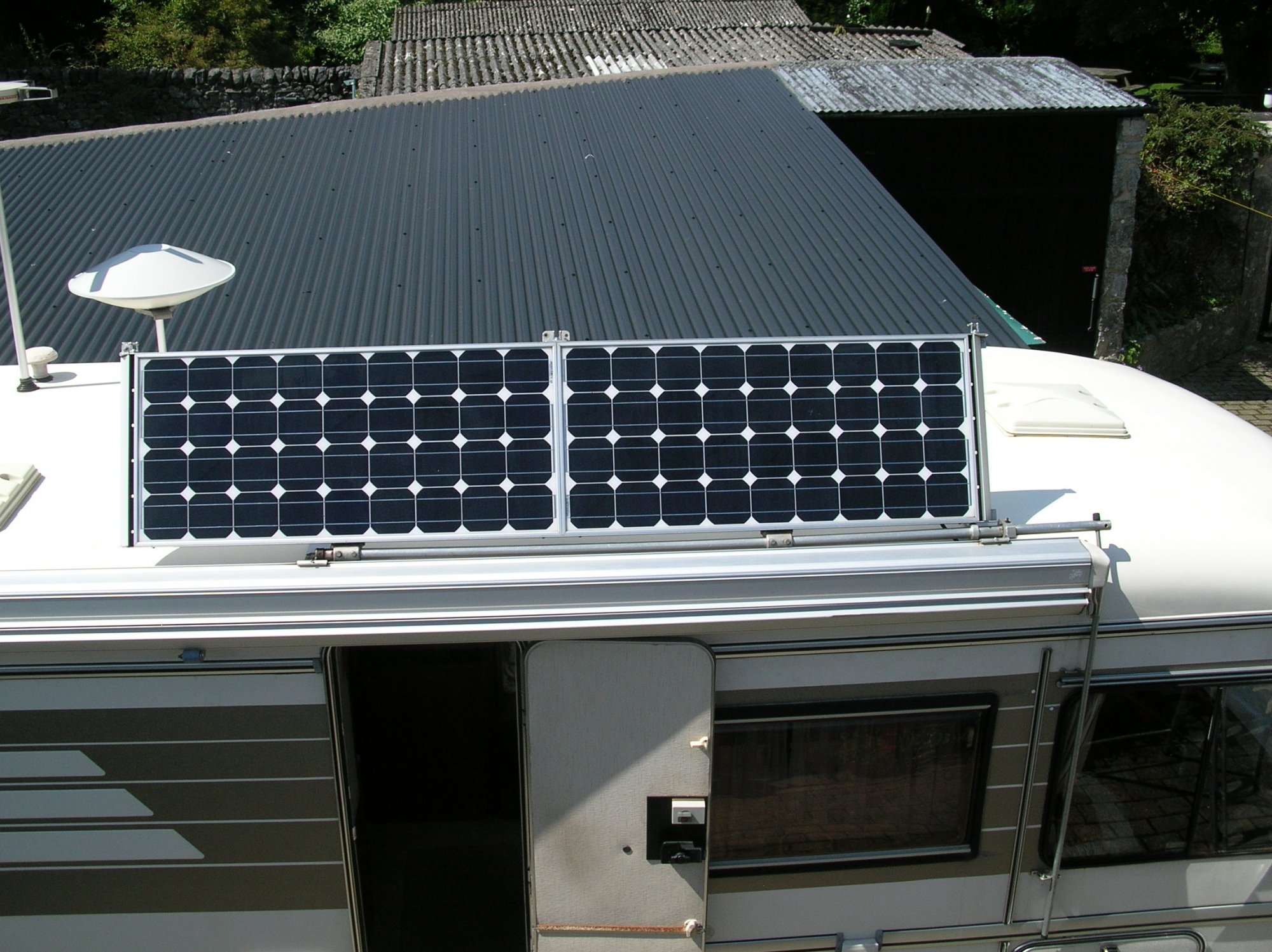

My installation is now complete. And after days of bright sunshine, ending yesterday, I can confirm,100% of nowt is nowt.🤬.
Unless of course I’ve messed up somewhere.
Amazing what a bit of sunshine can do. 86w coming from the new panel. The main tilting panels on the roof were only giving 10ish, in almost full shade. I’m happy with that, although I don’t really understand how it works. Perhaps ignorance is bliss.
My solar panels are now matching the battery bank. Almost 😬

It’s on the drive mate. Stuck at home 🙄. Great place to visit. Living here is something else. Planning a getaway asap😬

Yes sun today and my folding panels are hanging around again. I did see 6.2 amps with a heavy load on the habitation batteries. The BVM shows the additional charge, but networking the MPPT's doesn't show an improved network power. A bit of playing required I suspect. So yes it works! Going to buy another along with a pack of small Anderson plugs and sockets.
