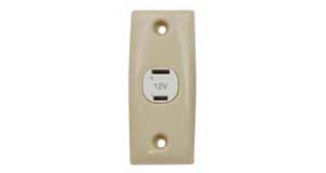

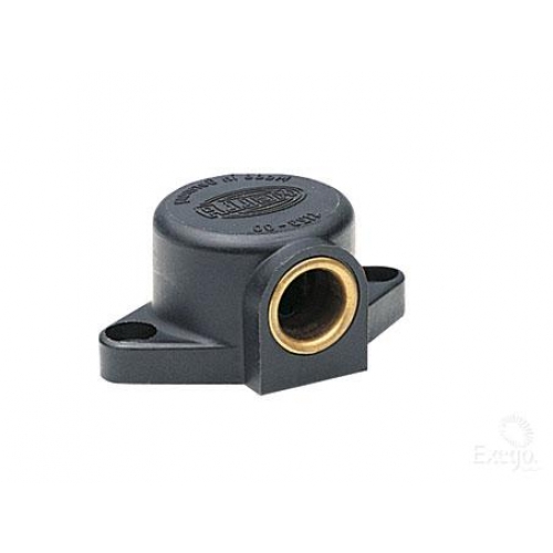

I think the confusion is because the OP didn't realise that the 12v and mains are two separate circuits and not interchangeable, this is quite a common mistake amongst folk new to motorhomes and caravans. It hasn't helped that his Hymer had European 2 pin sockets instead of 3 pin 13 amp sockets like in a UK house or motorhome.
In addition to cigar lighter sockets, I've seen these different types of 12 v sockets in motorhomes and caravans:
