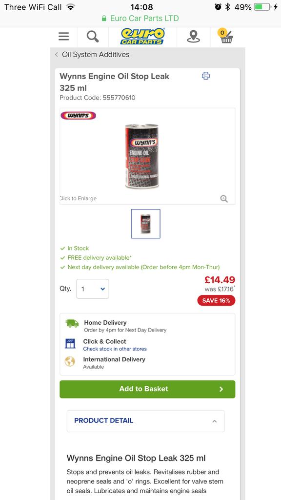

Isn’t there a Product something like ‘Radweld’ But for Minor Oil seepage Or Leaks that I can add as a temporary measure to give it a fighting chance until I can sort it properly end of Next month.
yes but thats for water leaks. Not sure if theres anything to help with your problem though as it would need to be added to the oil. Not something I would be happy to do.
Yeah, Sorry I DID mean for the OIL,
I found this -
& in like a few of the others available it kinda says it’s ok with Seals, Rubber & Neoprene Whitch is what a lot of the other products actually attack...
Any thoughts !

Oil is the engine lifeblood NZ so you are better sorting than codging if possible. That does seem a bit pricey but I have only ever bought for cars (2.5 V6 though) and that was many years ago

Would not use stuff for your failure Paul .get a oil cooler exchange and job done with peace of mind imho

Oh I agree & DO Take care off & Replace anything that is needed on The Nest, as you know it’s My Vehicle & My Home, So Absolutely won’t Bodge anything.
I was just wondering if to take care the Pressure off & worry of it worsening & to give piece of mind If i could put an Addative in as an interim measure to help until I get it replaced !

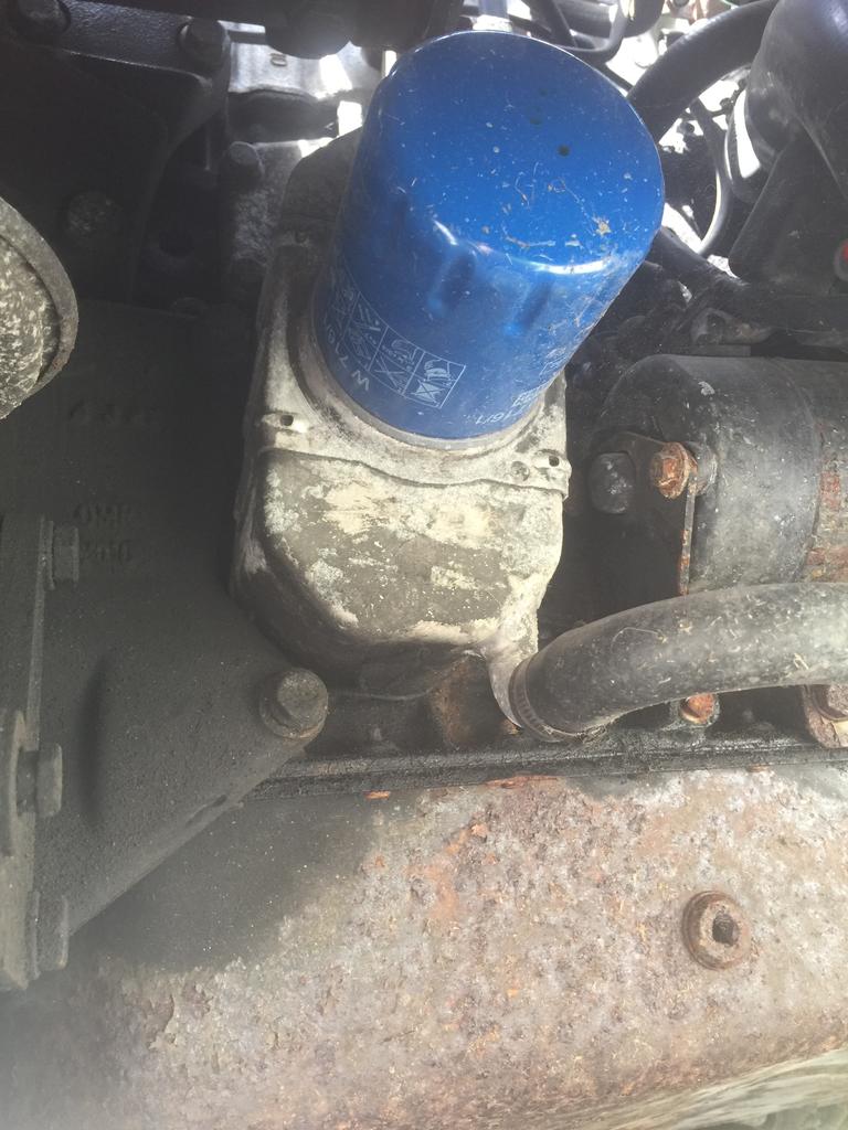

Ohh REALLY appreciate you taking the time to look, But NO The Nests one is Different -
Looking at it from the front It’s got a Top Right & Bottom Right Flow pipe connections & obviously the Filter in the Middle.
It actually looks different to the one I thought it was earlier !.

Good to see the picture, during the winter taking it easy you would get away with not having it,
just linking up the hoses together,
but it is so hot at the moment that doing that would be risky.
Yes get the garage to fix it for you if you are not sure about doing it.
Me I am too tight, after oil cooler replacement I would be washing it out with biological washing powder !
Okay ..... the only reference to this I can find is a supplier in Holland (I think) Bart Ebben. Looks like the right one, unfortunately out of stock. Cant find one listed on fleabay even.
As an aside, if you want to prove that it is the oil cooler, if you take off the two water pipes and join them together with a bit copper pipe (bypassing the oil cooler) and run the engine. If you get oil dripping from the oil cooler then it proves its dodgy.
I appreciate you may be limited in what you can do given the fact you're living in the van but it just a suggestion of a way forward.

The way these work is a bit different Nabs, The "oil cooler" is actually just a heat exchanger, transferring heat from the oil to the water which is cooled by the radiator on the water cooling system. It can be bypassed by joining the two water pipes which would obviously stop the oil getting into the water BUT then you are left with an oil leak. Oil leak could be stopped by connecting a pipe between the two connections but that would be subject to oil system pressures and would mean running without an oil cooler.
I agree with Gordon. Its the only way to go, sourcing the new part may be problematical though.
Just realised the dealer name Bart Ebben is actually a used part supplier. Its the only place I can find the part listed, which probably doesnt bode well !

Yes Matey as I said I’m going to have a New cooler fitted, No Question, It’s actually ‘Finding’ one & Trying to do what I can to have a bit of Piece of mind that I’m NOT going to be making it worse in the Mean Time !.
The Thunbnail Dave posted looks like the onevto me, But as he then says,,,Being the only supplier doesn’t bode well on the price & availability front .
