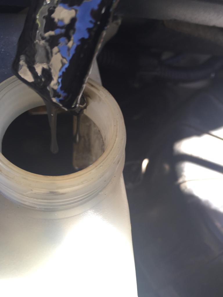

Before-
Now -
Let’s see what it’s like after the coolent has cycled a few times !.

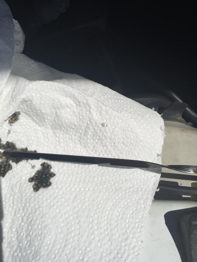

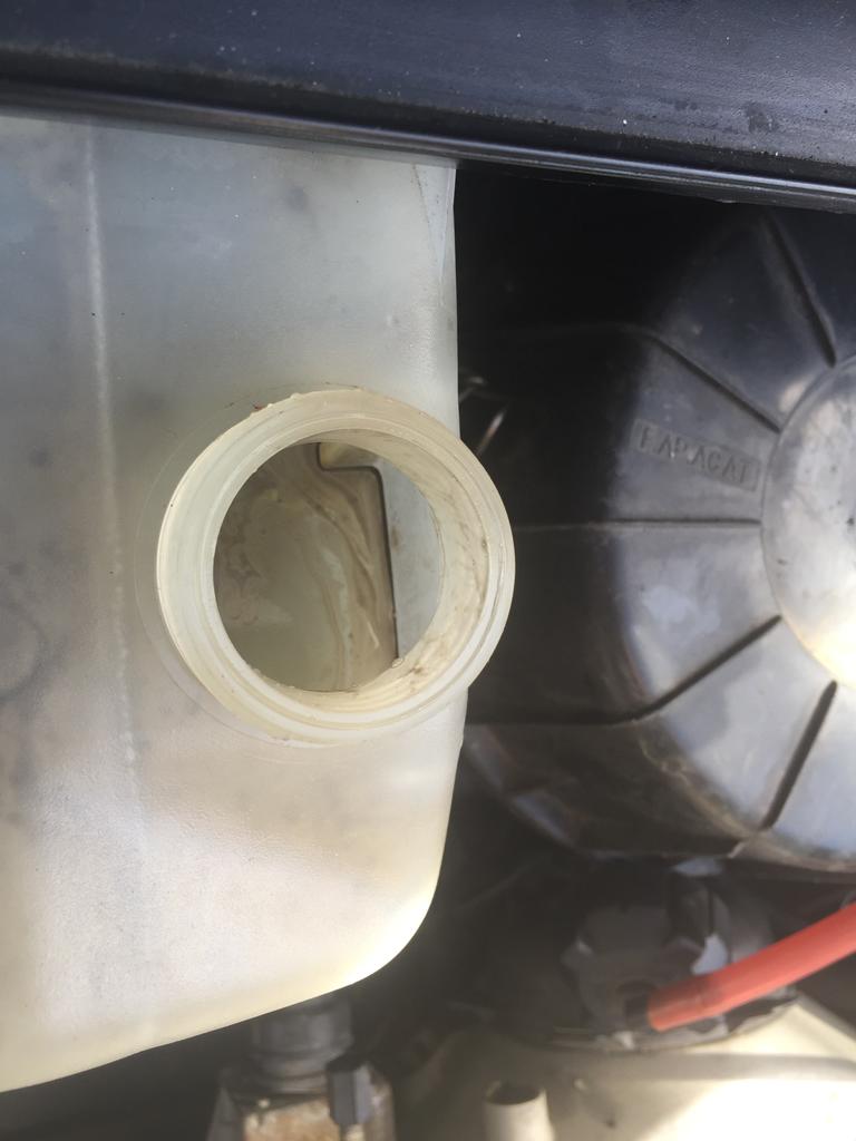

When I stopped the Engine & let it cool for 40 minuets with the Bonnet Up, I then Checked the Oil Cap -
The Dip Stick Oil Level -
& of course the Header Tank it’self -
Hmmm,,,I Know it’s only a small test that isn’t under load or strain, & Don’t Forget that ‘Some’ of that Oil is still the residue from the Cooling system it’self, But Fingers Crossed it appears not ‘TOO’ serious a problem & will give me time to earns some more money to take care of The Nest again in a few weeks !.
