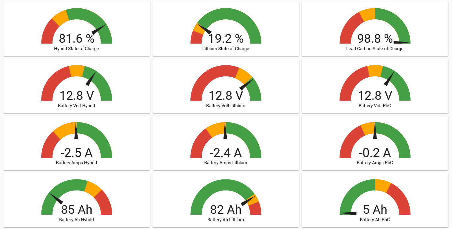

Rejigged my Monitoring setup a touch after doing a few trials over the last couple of months ...
The Cerbo GX connects to a Hwawei 4G MiFi Router (which is installed to provide in-Motorhome Internet generally). That is all straightforward.
The Raspberry Pi that I originally used in the Campervan (before I upgraded to the Venus GX and then the Cerbo GX) I have now installed Home Assistant on instead (https://www.home-assistant.io/) and added the Victron Modbus Register info (this is how you get the Victron info into Home Assistant).
The RPi is connected to the Hwawei via a little mini-router. This is hard-cabled to the Pi (and powered by the Pi also) and then connected wirelessly to the MiFi (it is a bit of a quirk of Home Assistant that apparently it does not like a wi-fi connection on the device, and as my MiFi is Wi-Fi only, I needed a workround to get the two communicating).
This adds a different kind of view to the Victron Monitoring possibilities in the Native VRM, and also in the Node-Red. Because Home Assistant is standalone, you are bringing in the Victron info just like you are bring in any other info from other kit, so the possibility to have a much more integrated solution is there. I am still currently focusing on the Victron data initially but can also look at a lot more home automation stuff as well.
And it is much more colourful, which can be handy when you want a quick look at what is going on! This is my "Battery System Dashboard" showing key data for the Battery Banks - the overall Bank to tell me what is going on, plus a drilldown to the Lead and the Lithium Banks.

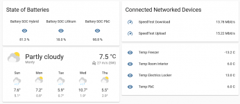

And a quick example of what mixed data is possible on a single view ...
So a simple view of the Leisure Batteries, 5 Day Weather Forecast (handy to see what to expect for both Solar Harvesting and getting out & about), Internet speed (useful for say using Firestick on TV) and a quick check on the temperatures.
