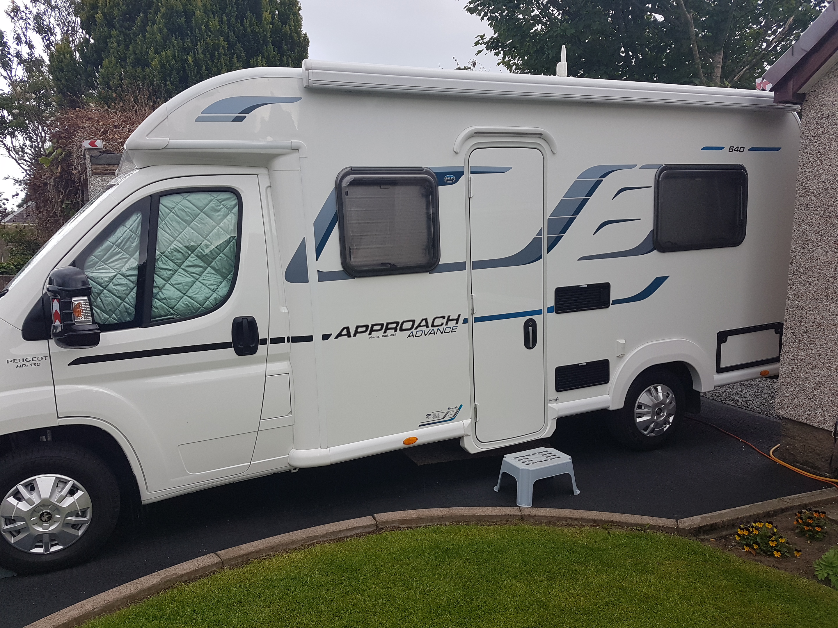

I just always thought the exterior looked a bit....White and a bit bland.
So i decided to do this. ( i will try and put pics on in sequence).

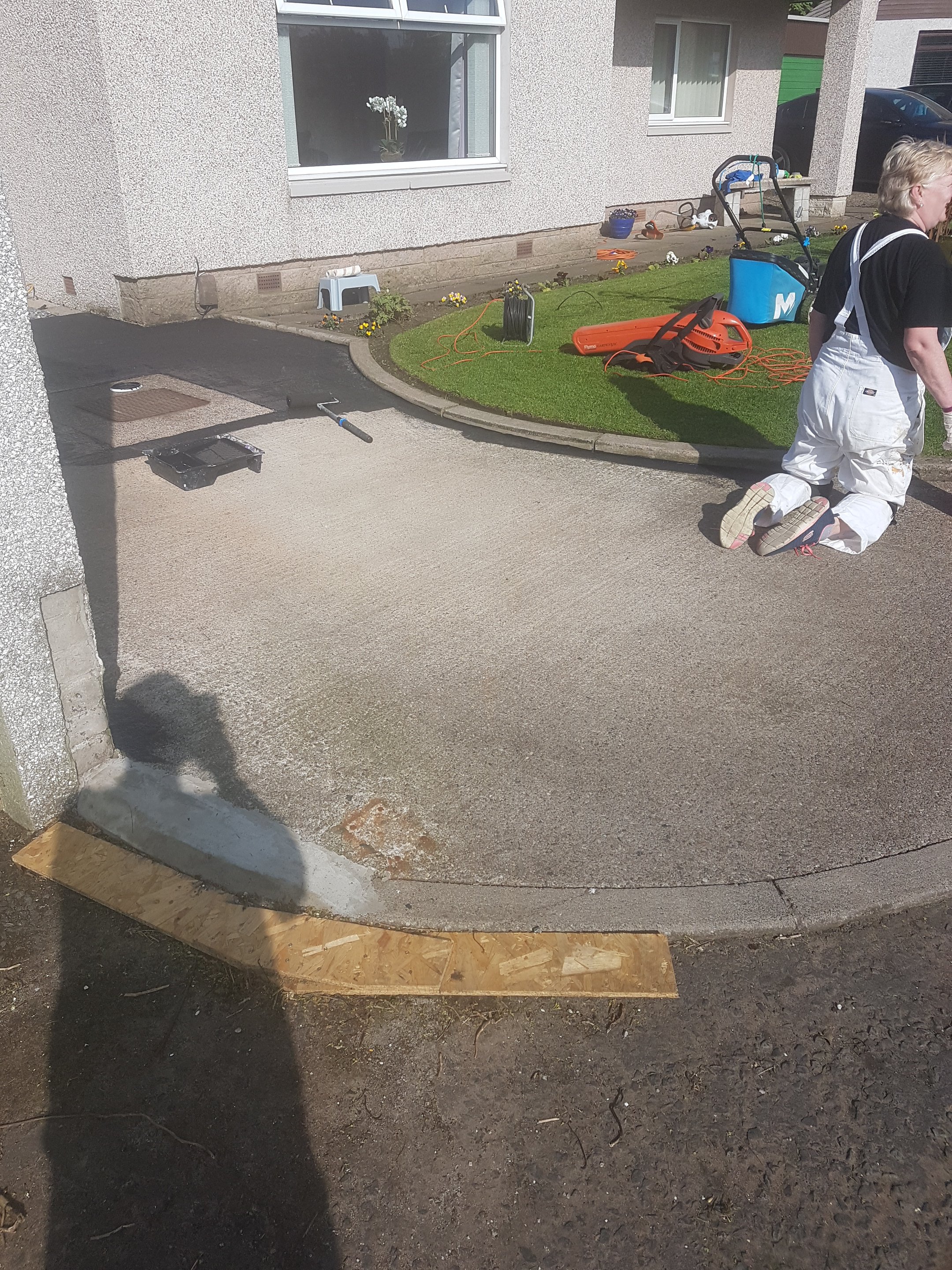

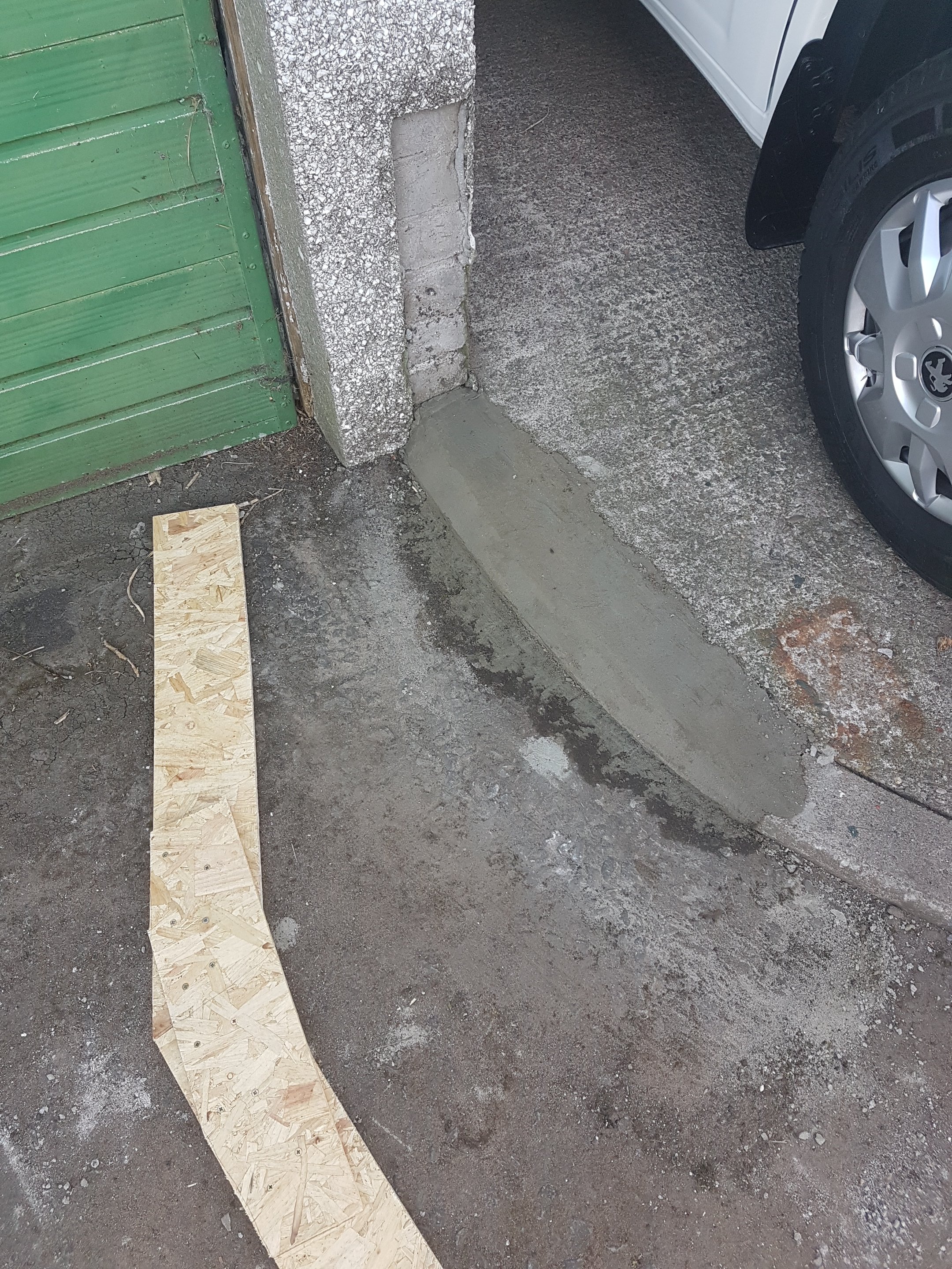

We have a drive either side of house and decided for various reasons to move MoHo to other side.

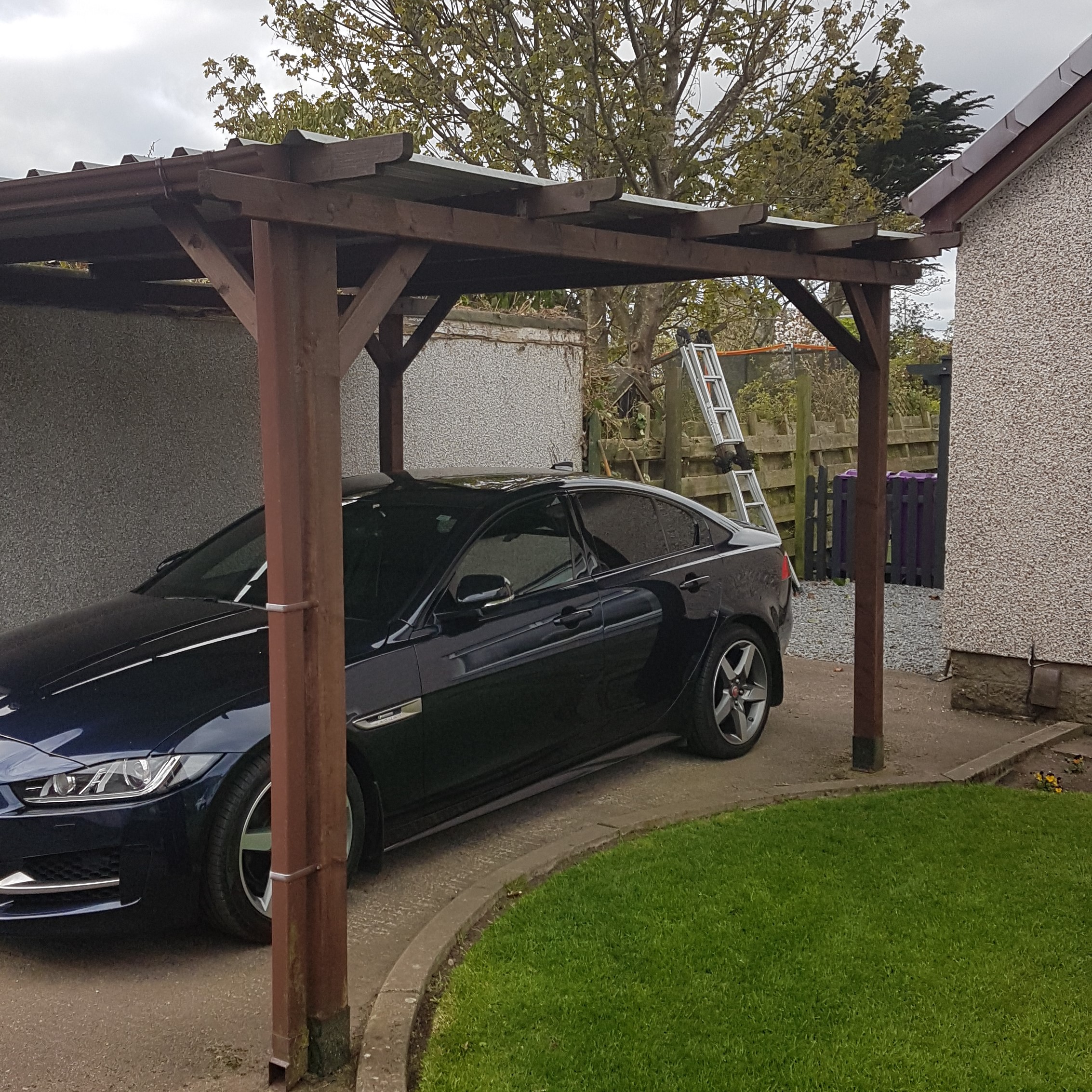

1. Took car port down.

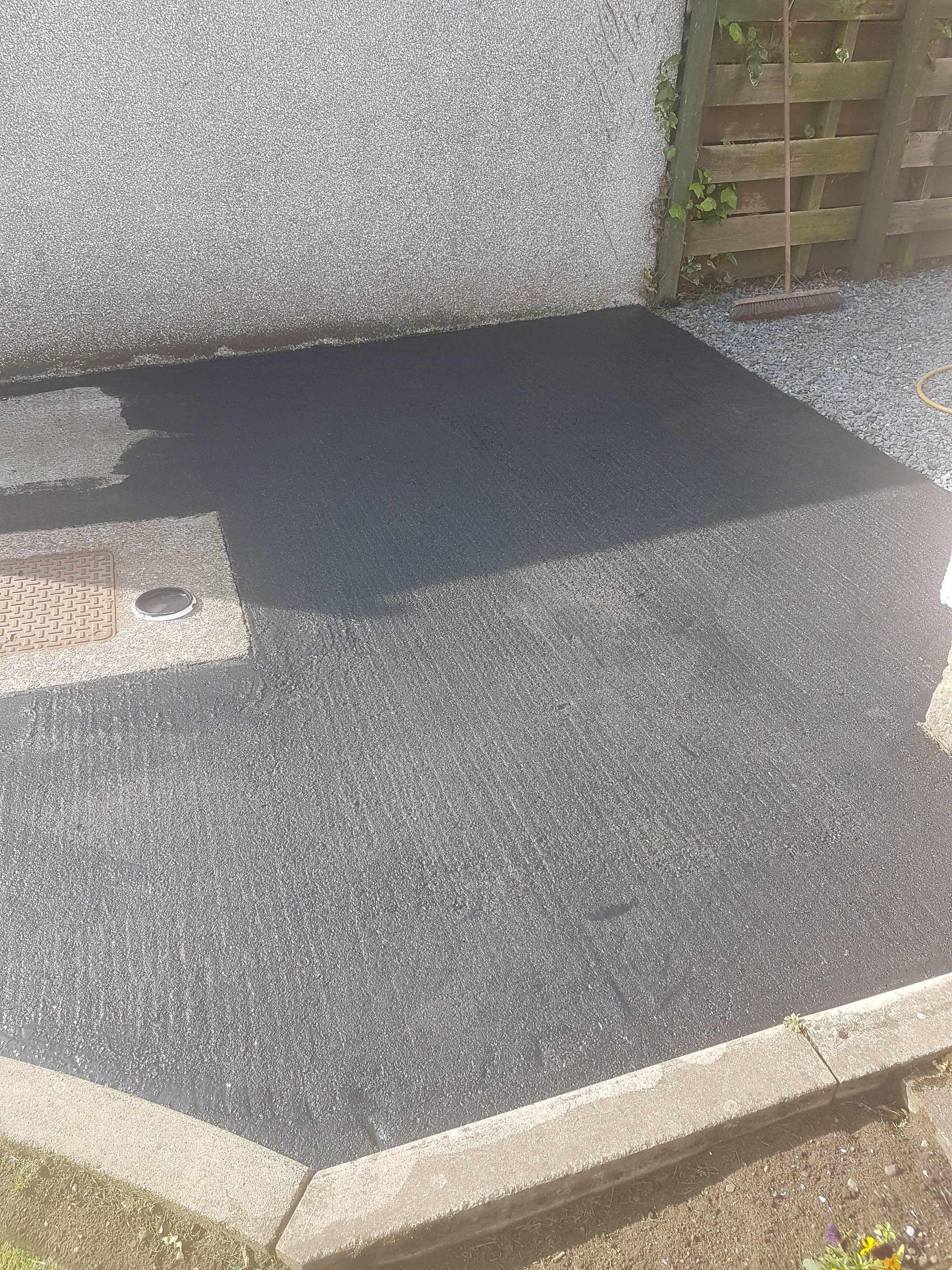

2. Painted concrete drive with Wickes Tarmacadam and Concrete Driveway Seal, Black. (I put that drive in myself a few years ago).

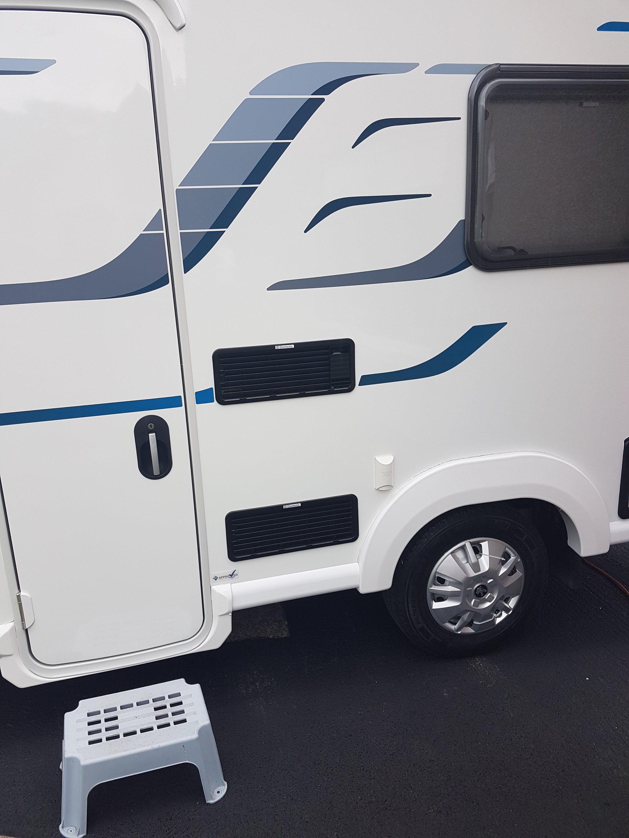

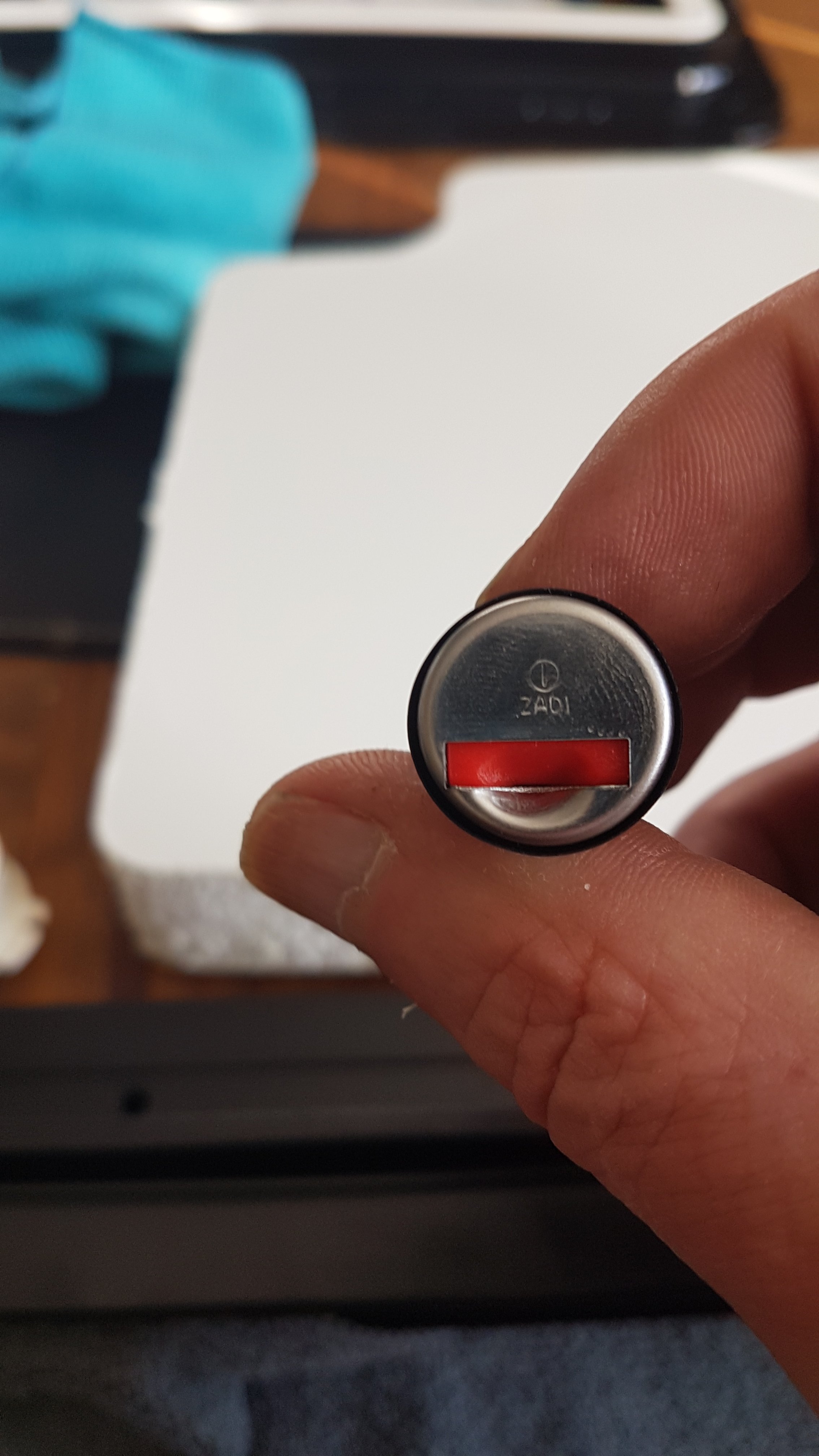

3. Bought new Thetford Doors in Black prior to lockdown. Swapped around original locker door lock barrels and housings so still useing same original key for all lockers. By this time lockdown had kicked and my door infill panels never arrived. So I bought a new white 30mm UPVC door panel and cut my own infill panels. Exactly same and cheaper.
4. Plasticoted external Dometic Fridge vents (expensive to buy in Black), Whale Vent (dont come in Black), Thetford Toilet flush filler Cover (dont come in Black) with a final Acrylic Clear Silk sealer.

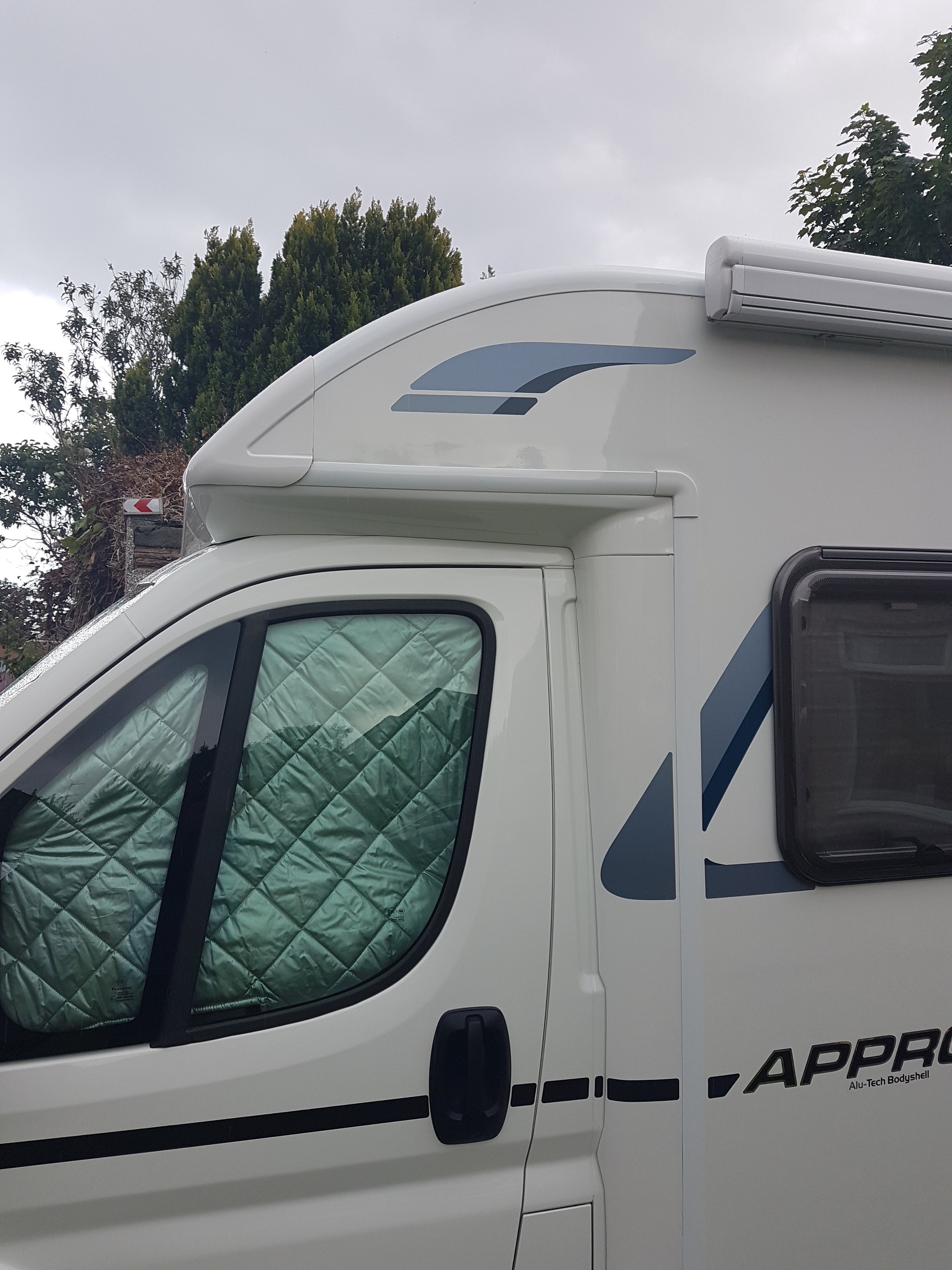

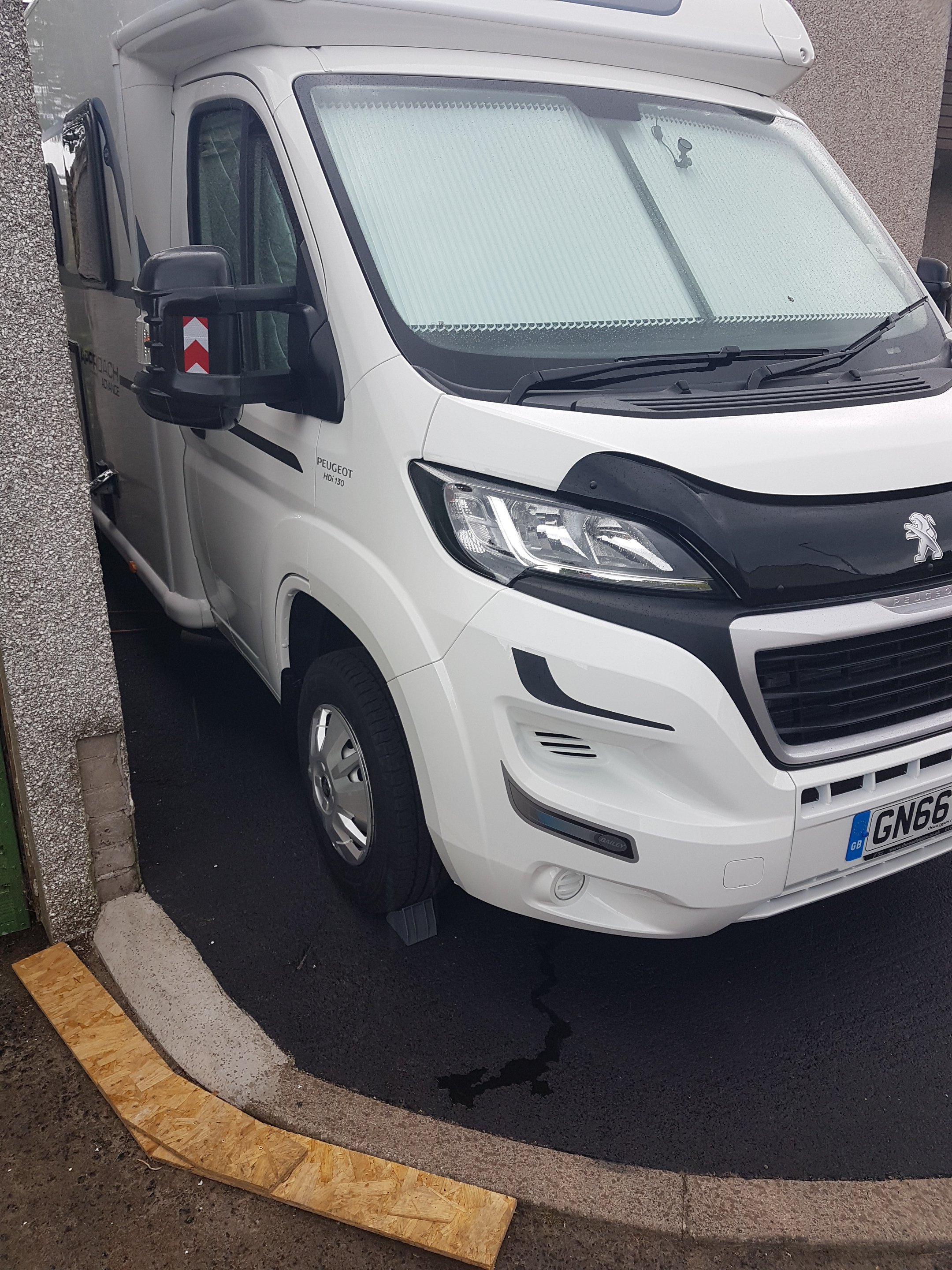

5. Applied Bailey decals (Prima Leisure) for other models in the Approach Advance and Approach Autograph ranges.
Decals I applied were to, The front n/s + o/s wing corners (They were bare), above Driver/passenger cab (again bare) and to the rear of n/s top fridge vent curving upward.
6. Removed original and fitted the new Black Thetford Doors, EHU and still to change over Black Fresh water filler neck at rear.

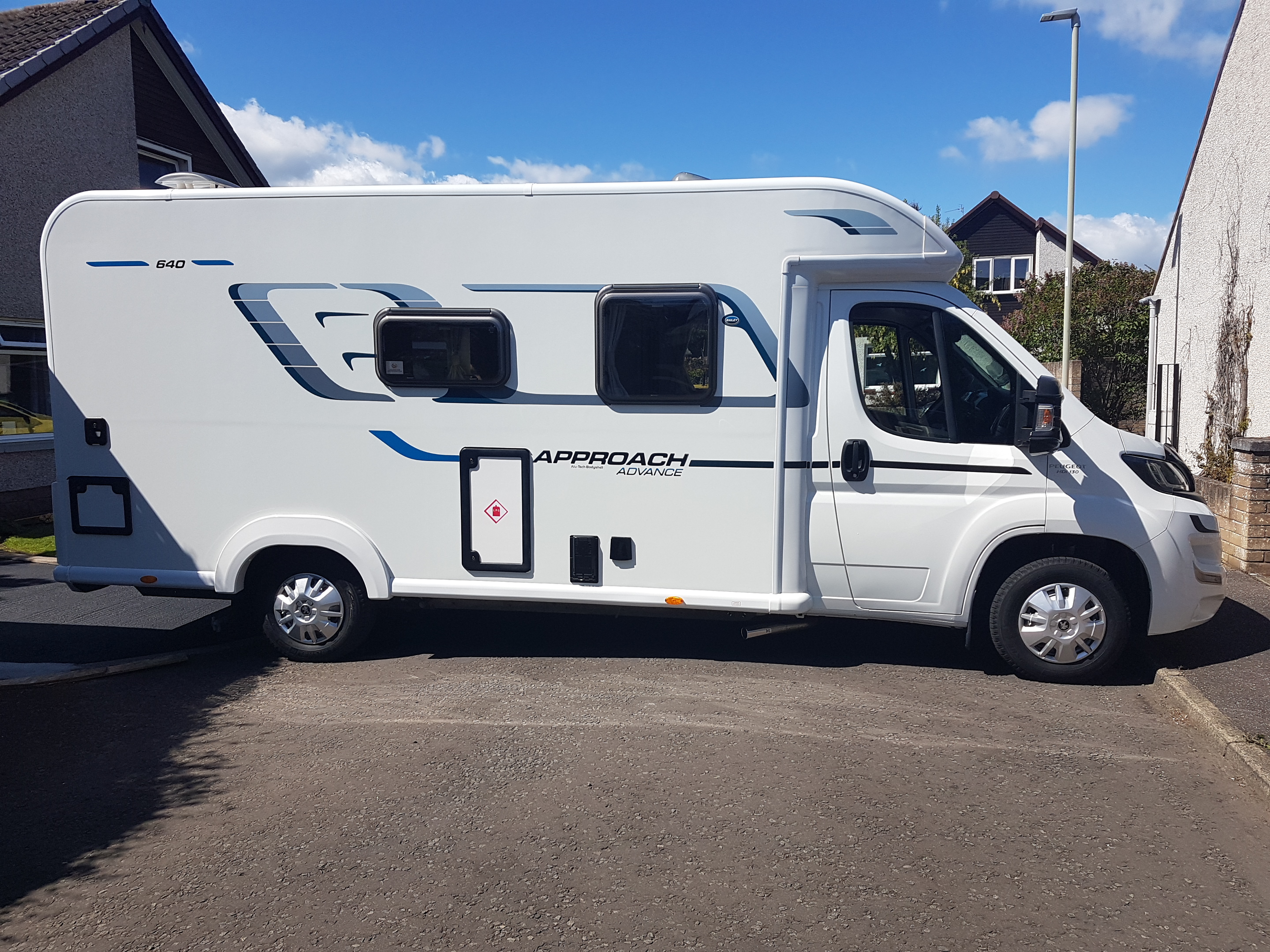

7. I have decals ordered same as `APPROACH ADVANCE` ones already factory fitted to front n/s + o/s hab of van , to be placed either side at rear of van, same level as bottom of rear windows, slightly raised higher than front ones.
They are stuck in transit with the current crisis.
8. Kind off out of cync now, but also fitted new Fiamma F45s canopy, Vision Plus Roof mounted TV Arial, additional 240v sockets in lounge areas and kitchen and additional Arial and Sat points to where I fitted TV mount bracket between lounge/kitchen. ( Have to admit a lot of this was done with the expert help of a mate of mine who works as a fitter for 1 of Scotlands largest Leisure Vehicle companies. HANDY!)

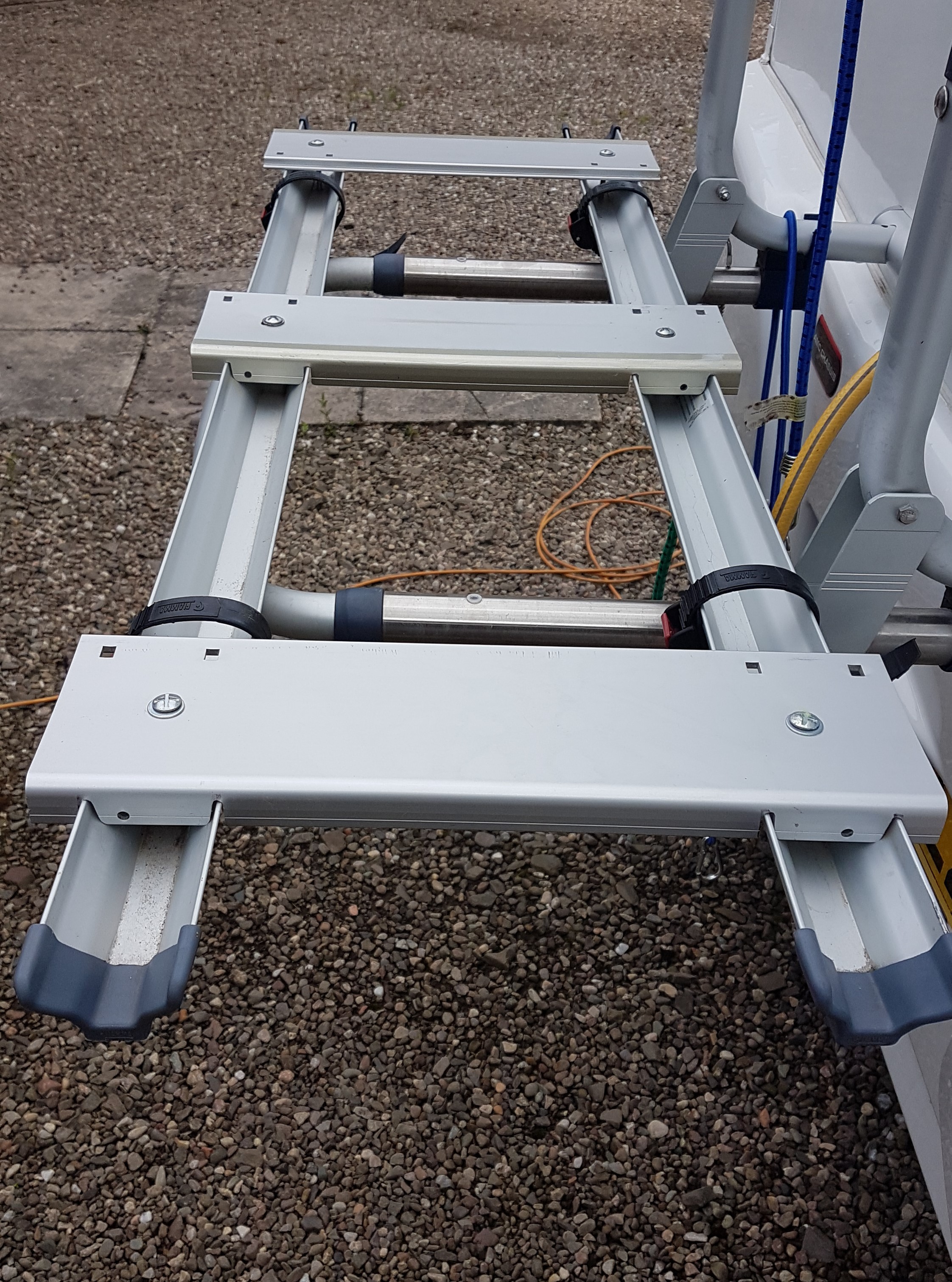

9. Fitted Bonnet Protector and adapted Fiamma Bike rack to carry soft luggage cargo bag as we are a bit restricted for storage so dont carry bikes. I used the standard Fiamma fitting brackets that come with the F45s canopy as you almost always have to additionally buy van specific fitting kit brackets.
10. I have decals cut for the doors and cab `B` Pillar Post lower recesses (normally fitted with plastic moulded trim) but not sure about them as yet.
Possibly alloys and although Remis Windscreen blinds are fitted, thinking of getting cab door ones, again only for cosmetic feel in the cab as the mouldings give a good finish. Still prefer my Polar Screen, Minster Products wrap round screen for preventing condensation though.

I don’t really know what the factory decals look like but van looks okay to me, not modified.
The black looks like it should be there as well.
What I am meaning is it looks factory done 👍
Cheers. They are all Bailey Decals, the exact same Decals for Bailey replacements are sourced via Prima Leisure as are any Bailey vehicle part. Bizzarrely some parts are extremely cheap but others extortianetly expensive. I think once i get the final decal for the back it will finish it off. Thanks G
Regarding carrying luggage on the bike rack, you are aware of the load limit (60kg if same as mine) of the rack and how that loads the rear axle? Only mentioning in case you don’t do ignore otherwise👍
I just get in with handcycle and Caz’s electric bike if we ever get both on together.
Hi yeah, its just the chairs and aluminium tables in the Fiamma bag. I ran over the local calibrated fixed plate (GVW only) weigh bridge last year. Full tank of fuel, water, everything we carry, a Kampa Motor Rally Air 260XL and acccesories, good lady and myself.
The van is plated at 3500kgs and it came in at 3060kgs! Doesnt give axle weights but an even load distribution and still well under. Cheers. G
