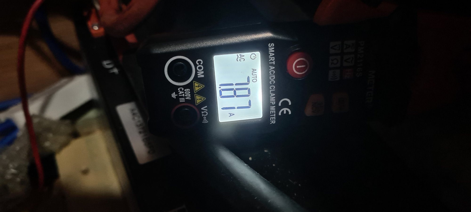

Well I dunno anyfin about a Coczow OR referral fees officer BUT I did notice that the Mustool doesn't display DC current correctly IF you use the Auto function, it auto selects DC current correctly BUT the reading is inaccurate. To read DC current correctly you have toggle through the options and manually select DC current.I bought the COCZOW and it doesn't work
Reading 8A AC when the inverter was pulling over 70A. So that's going back lol.
Interesting to see if you still get your referral fee...
Serves you right anyway.....I mean ....COCZOW! The clue was reading the brand backwards.
"I bought a Coc-zow but it Woz-Coc.
Try manually selecting DC current Steve and see if that does the trick![]()
Going by the feedback it's a common criticism, you don't appear to be able to manually selectLOL. I didn't see any way of turning the auto off, it's gone back anyway. I should just get a proper one![]()

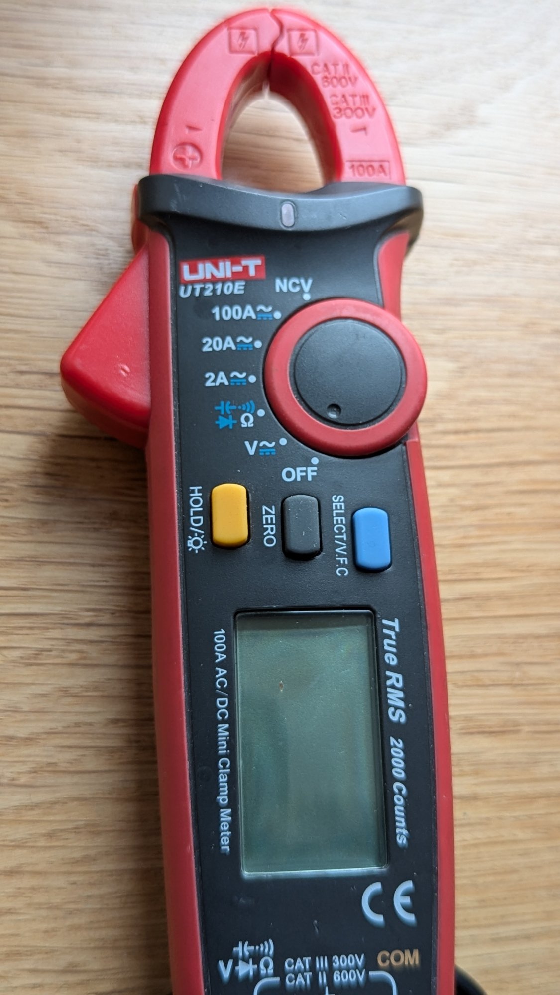

This one, UT210E. I've had it for a few years now so I'm not sure if they still do the exact same model. As mentioned it only goes to 100A which was high enough until I went lithium/inverter/ leccy cooker. It's very sensitive on the 2A range, if you're careful you can detect down to a few milliamps, it's obviously not particularly accurate at these tiny currents but it'll pick up low parasitic loads which is very handy.@merl Which model of UNI-t?
