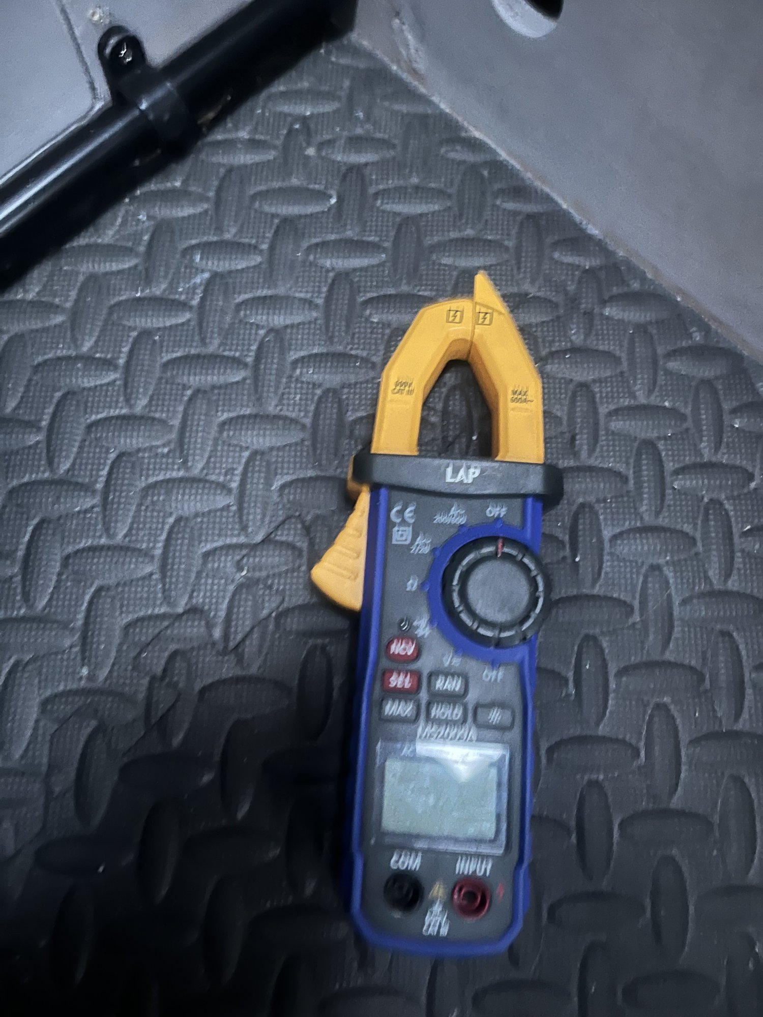

My cheap but non the less very useful one one 🤔,
In fact it’s SO old, it’s going all Blurry 🥸

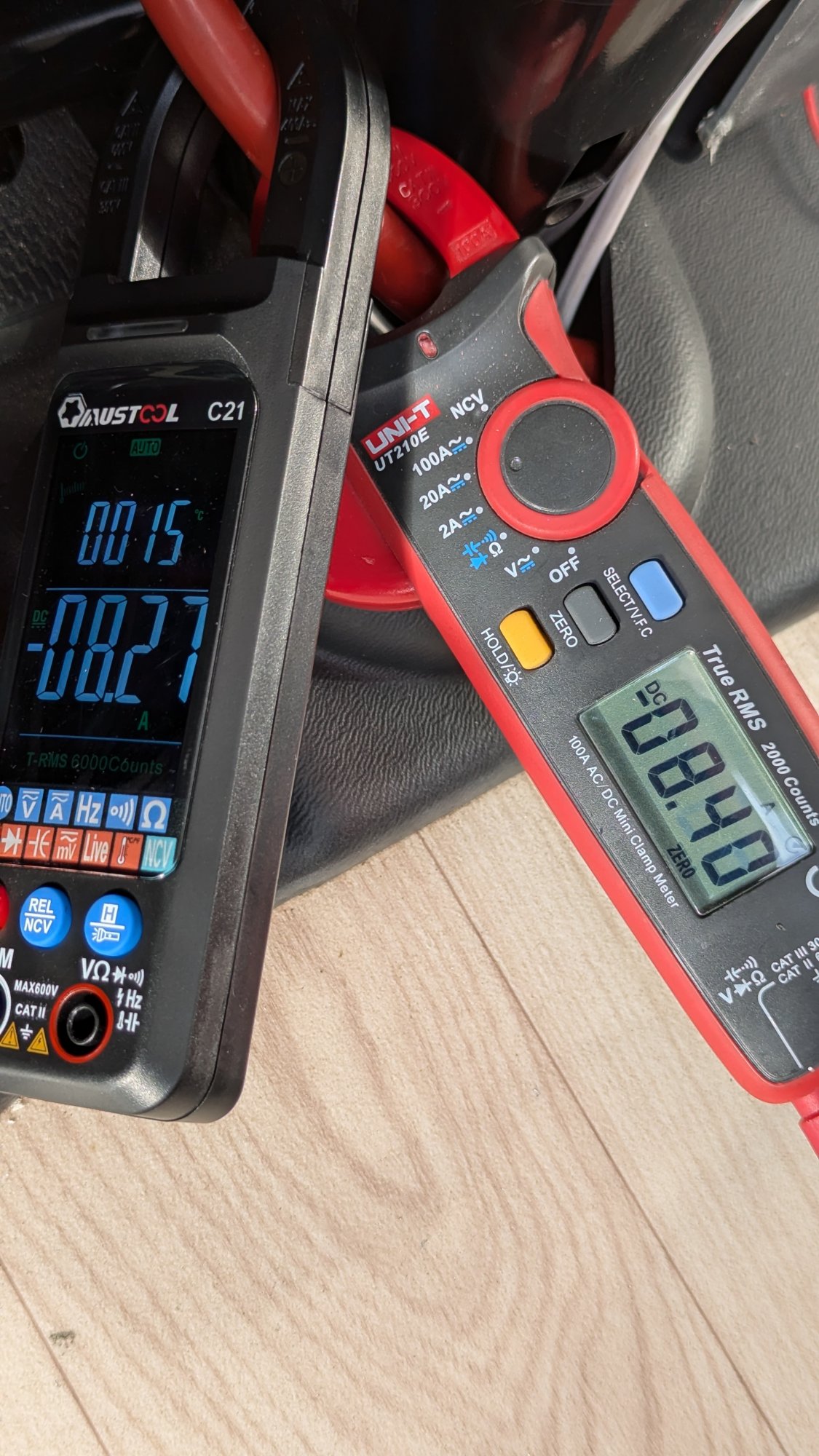

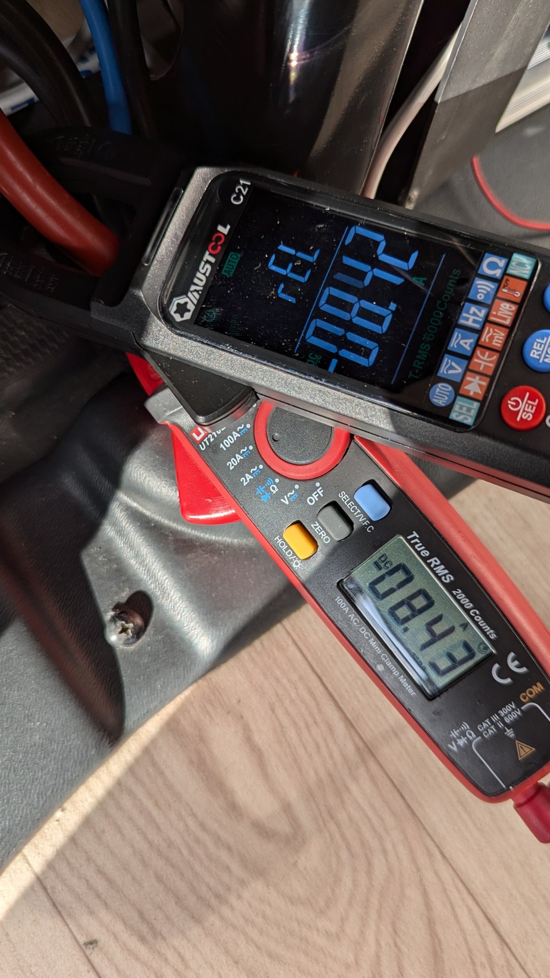

Just compared the readings with my Uni-t. The display on the latest one wasn't quite as steady but it's accurate enough to see what's happening for sure.
