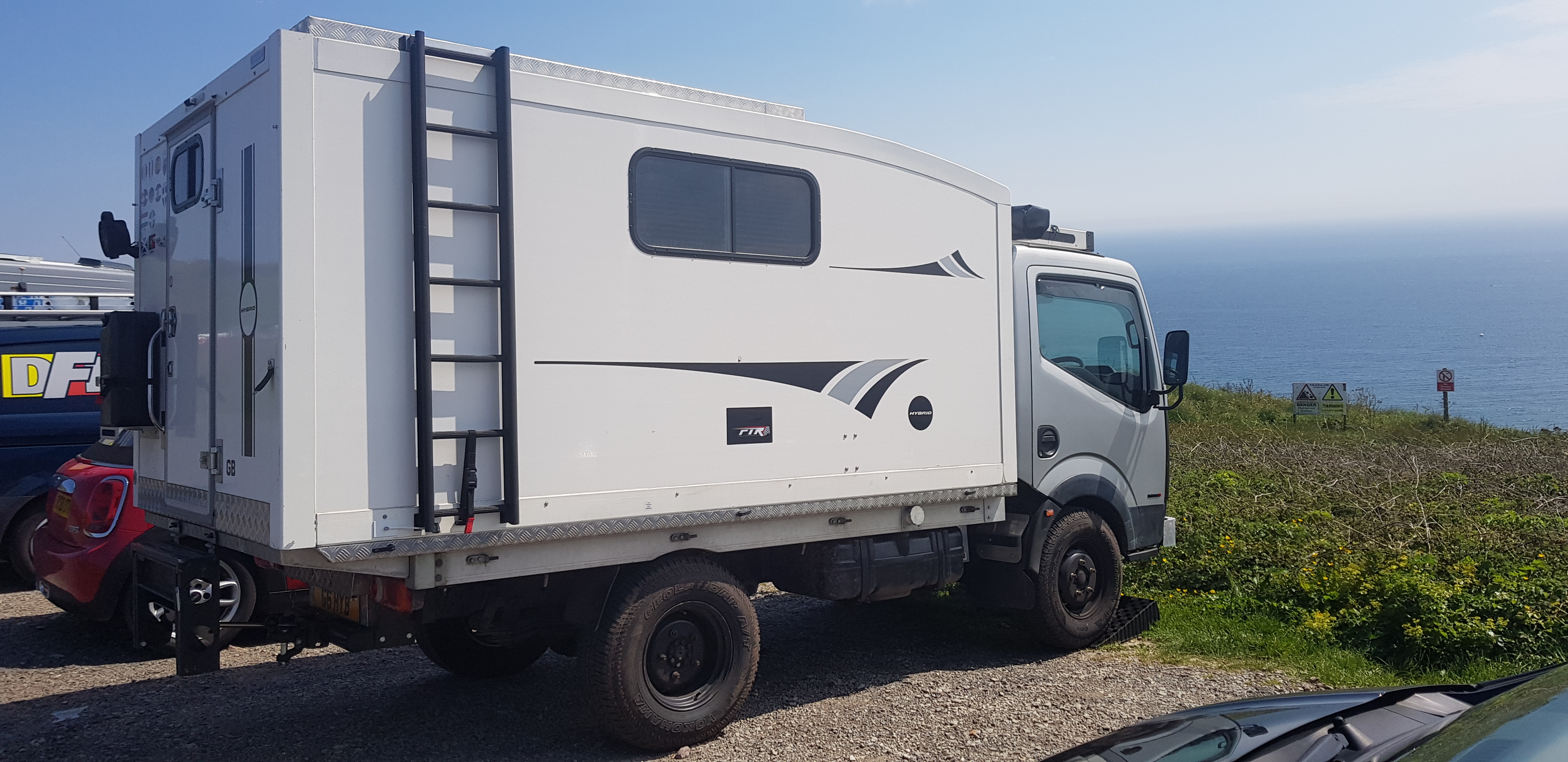

Looks very good :)
But I have to admit the decals on the side make me think of a Police Incident Vehicle :D
What incident vehicle!!was going to change them anyway😅

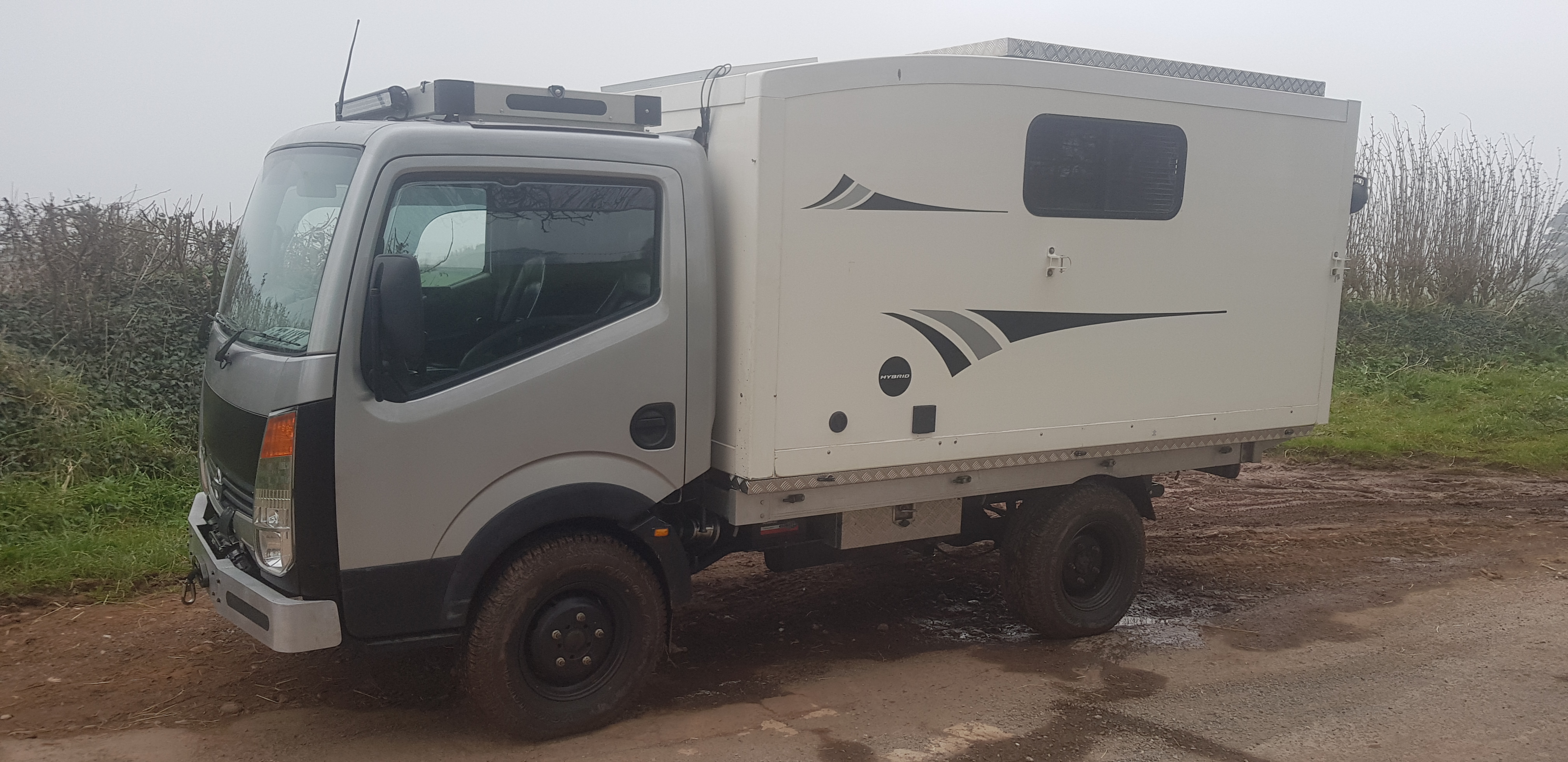

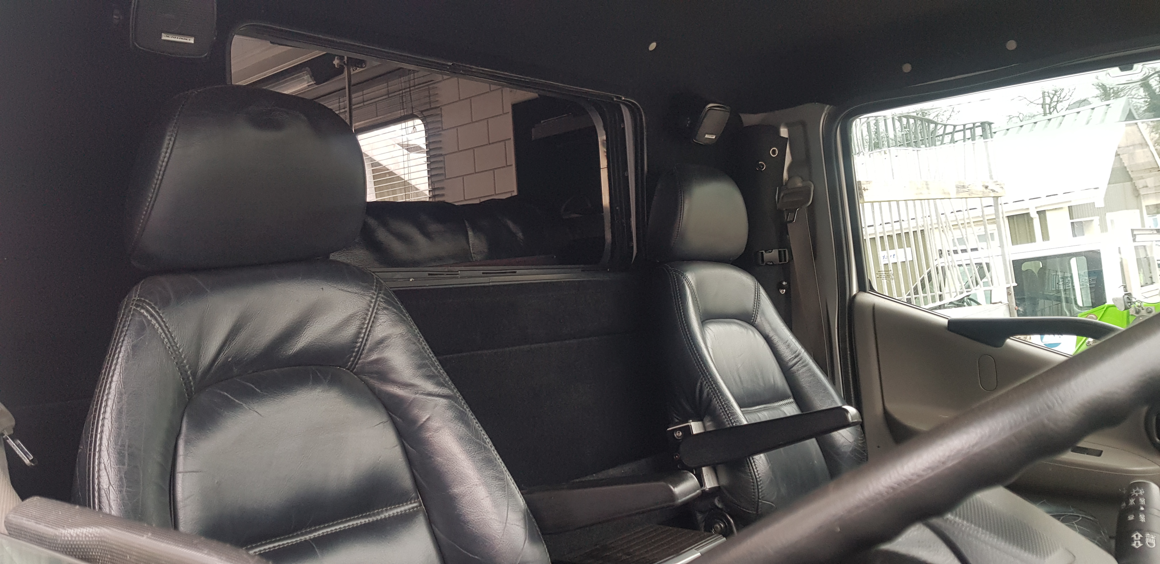

I haven't read back through all the old posts but I seem to recall you thinking of you having an access hatch through from the cab, did you do this and has it worked out as you had hoped?
By the way I honestly do believe your truck is the dogs danglies of a conversion!
Phil
Hi Phil, yes there is an crawl throught between cab and pod....with slide out windows when pod is removed. .i Have a flexible rubber bellow between cab and pod which is water tight and works well

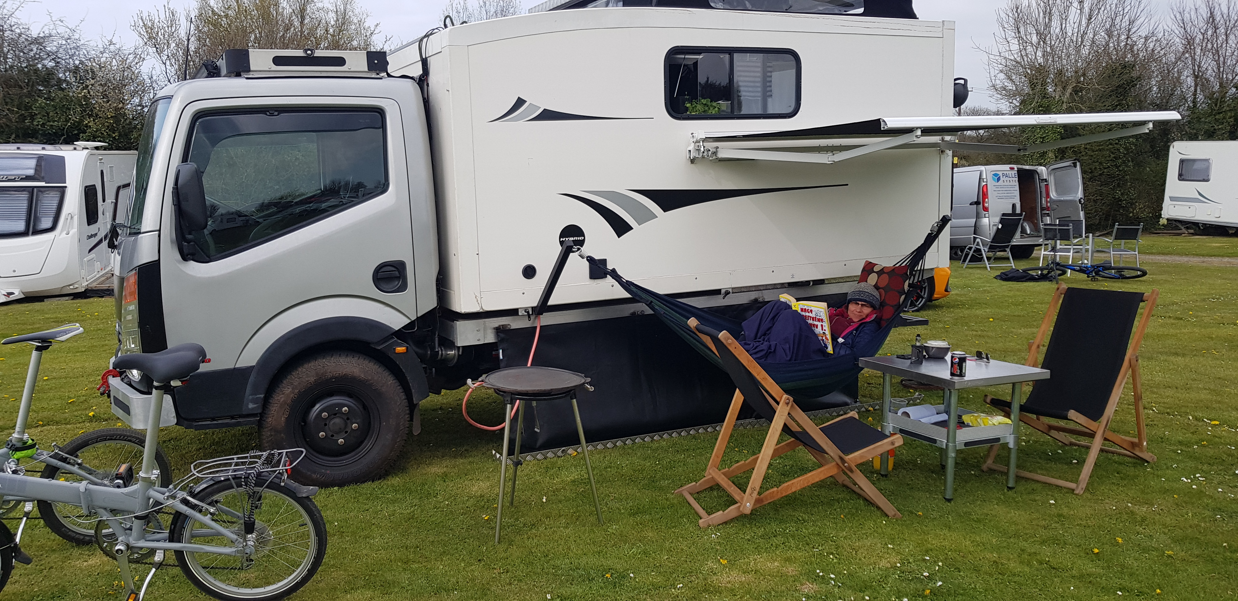

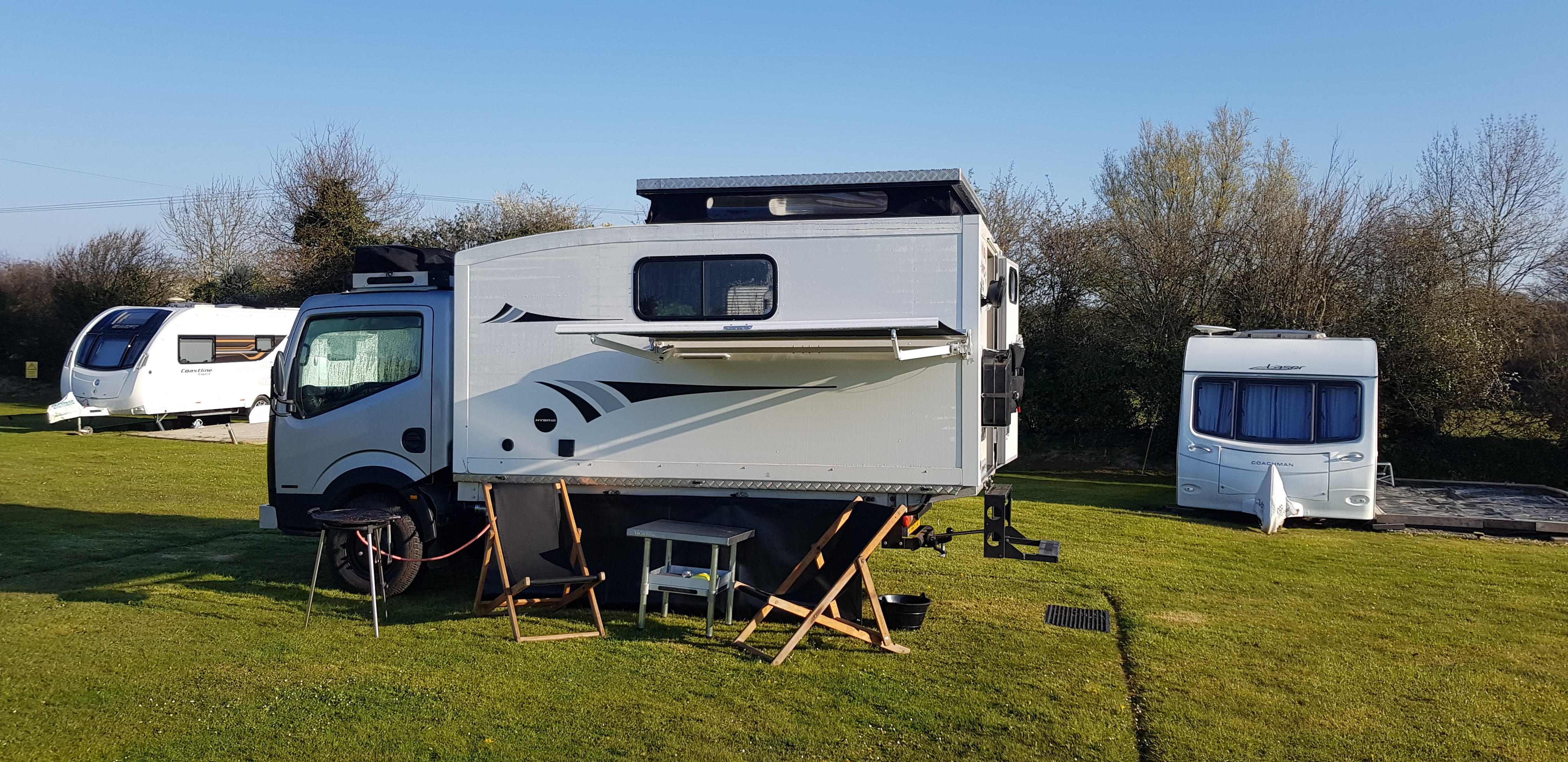

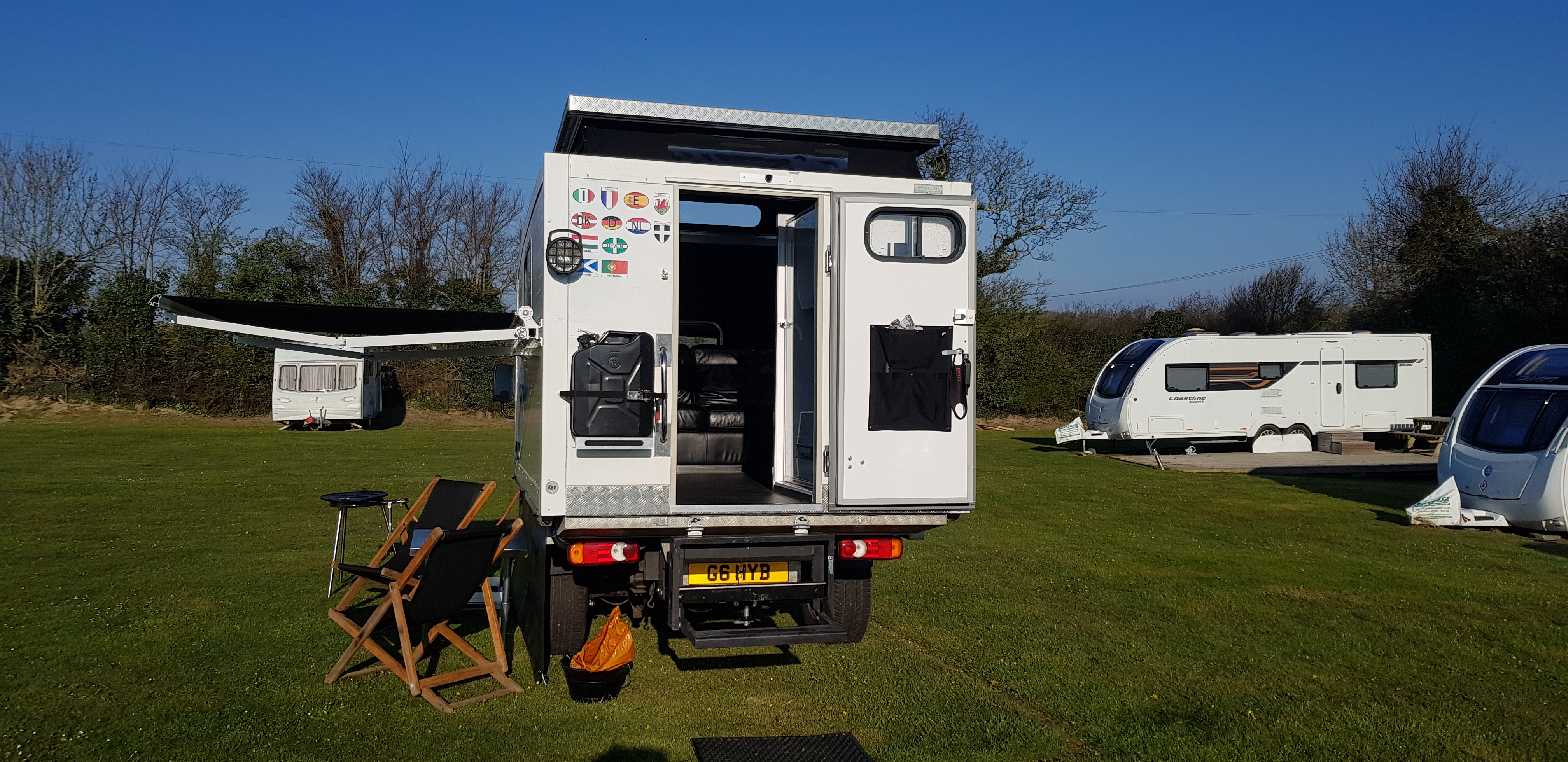

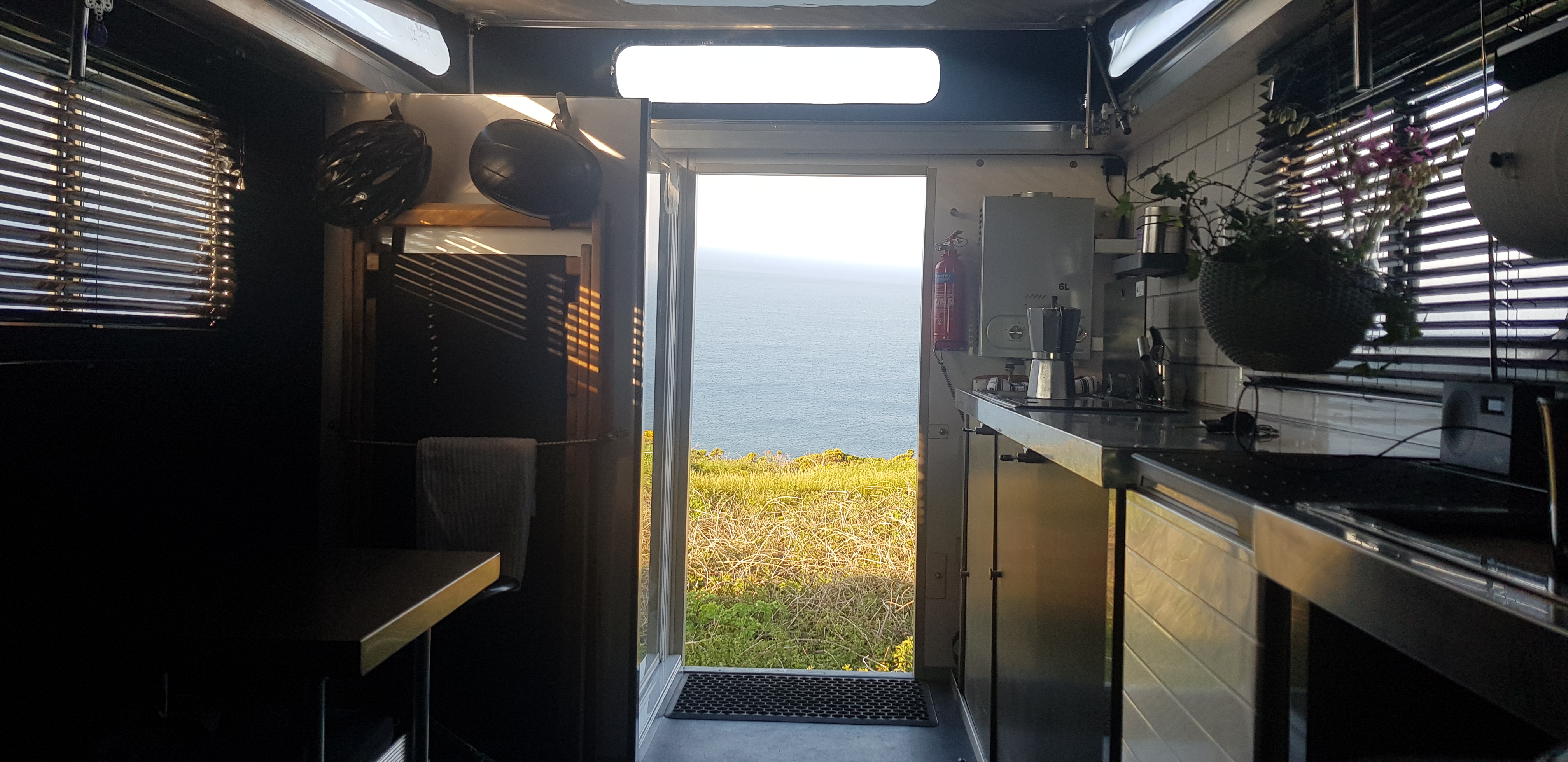

Hello,hope everyone is keeping safe and well,we managed to go away for a few nights in the camper...very enjoyable time in Cornwall ...cycled to bodmin on the camel trail....we had our folding bikes on the roof rack,

Did you have access internally to do your awning fixings, if not how did you mount it on fibreglass?
the awning is bolted through and fixed to an 80mm aluminium angle which forms part of the framework for the cupboards ...so had no issues , the bolts were also sleeved so when pressure is put on the awning while out it cant damage the fiberglass/insulation 👍
