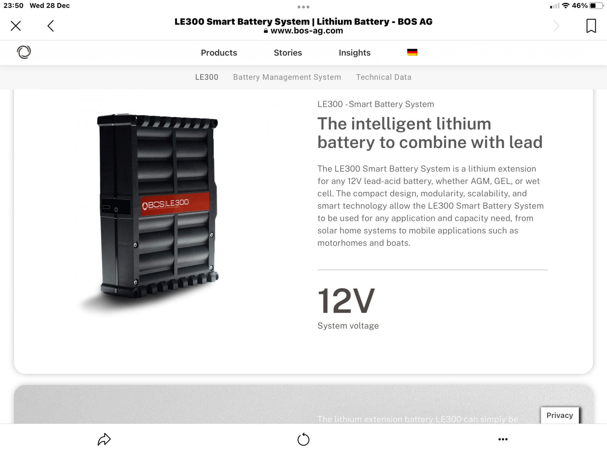

These modules look expensive for the capacity you get i.e. you need 4 BOS LE300 modules paralleled to reach 100ah and you can only pull 50amps total from the LifePO4 combination. For less money you can make lead acid habitation batteries redundant altogether with 2 x 120ah LifePO4's a decent B2B charger and a battery maintainer for the starter battery. That will easily allow 200 amps draw and your not wasting energy charging by pushing it through lead batteries with high internal resistance.
I guess this works best with boating when you've already invested in numerous AGM's and want to preserve your investment with the hybrid approach.
It is quite a good system, but rather pricey. It looks pretty.
What seems a little odd to me is there is no primary/secondary type of module - so if you have more than one of these, you end up duplicating whatever the lead-lithium interface control (whatever they have that does the same thing as the VSDR Lithium Controller you have) on every battery.
If you look at most modular Lithium battery systems, they tend to have a main 'intelligenr' Lithium battery system and then you get additional plug-in Lithium battery modules to increase the overall capacity.
For more info on the LE300 in use, here is a Hymer link - https://www.hymer.com/de/en/models/technology-innovation/smart-battery-system
I cannot deny I find the logic of this setup incorrect and the way your/my Hybrid setup makes much more sense in how the overall battery storage is provided and replenished.
For even less money, you can preserve your investment in your AGMs (or whatever Lead Acid batteries types you have) and have (IMO) a better setup than fitting a pair of Lithium's :)

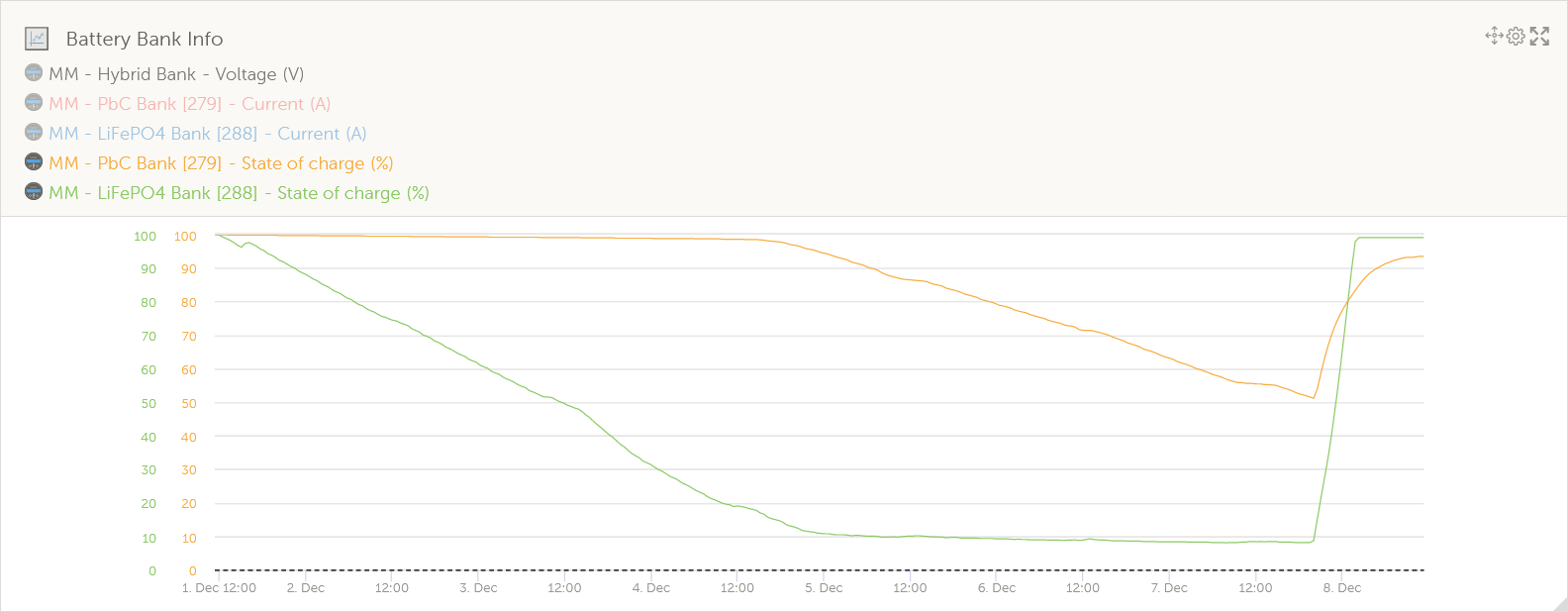

here the Green is the Lithium SOC and the orange is the Lead SOC. Solar is rubbish this time of year, especially for a van parked north of a tall house, so this is off-grid with no charging.
Lithium providing the power until around the 5th when it drops to a point where the Lead essentially takes over for the next few days until I get round to plugging in.
Without the Lead, the van would be out of power on the 5th. If I had one more Lithium Battery, it still would not have taken me as far as the lead allowed me to go before I plugged in, and would have cost more money (and I didn't even have to plug in yet anyway - the lead was only down to 50%. Lead Carbon Batteries you can take down much lower without damage).
So that is the advantage of Lithium PLUS Lead. And we still get that massive benefit of Lithium Fast Recharge compared to the Lead. (This is where I really don't get a key aspect of the LE300 system that kicked this thread off and the Hymer implementation. If you did have a situation where you have a Hybrid system, and you used both Lithium and Lead capacities due to extended demand, such as the graph above shows, why on earth recharge the less efficent battery first? Lithium recharges faster and converts more charging current into stored capacity so surely you focus on that primarily?)
