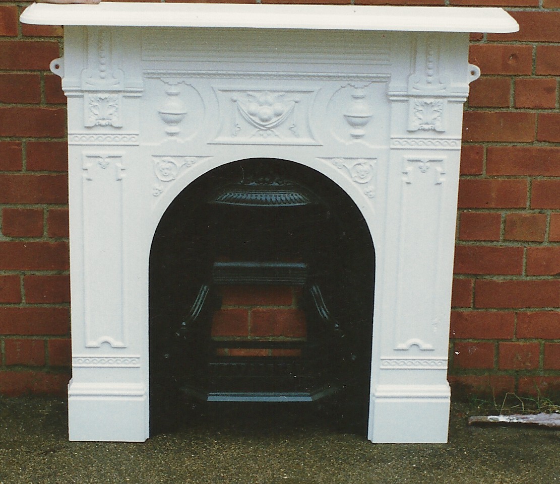

£15 i used to charge for blasting and finish in 2 pac poly.
That’s cruel pointing out what you used to charge. Did your boss know about it. ;)
I was the boss, Spraycraft LTD

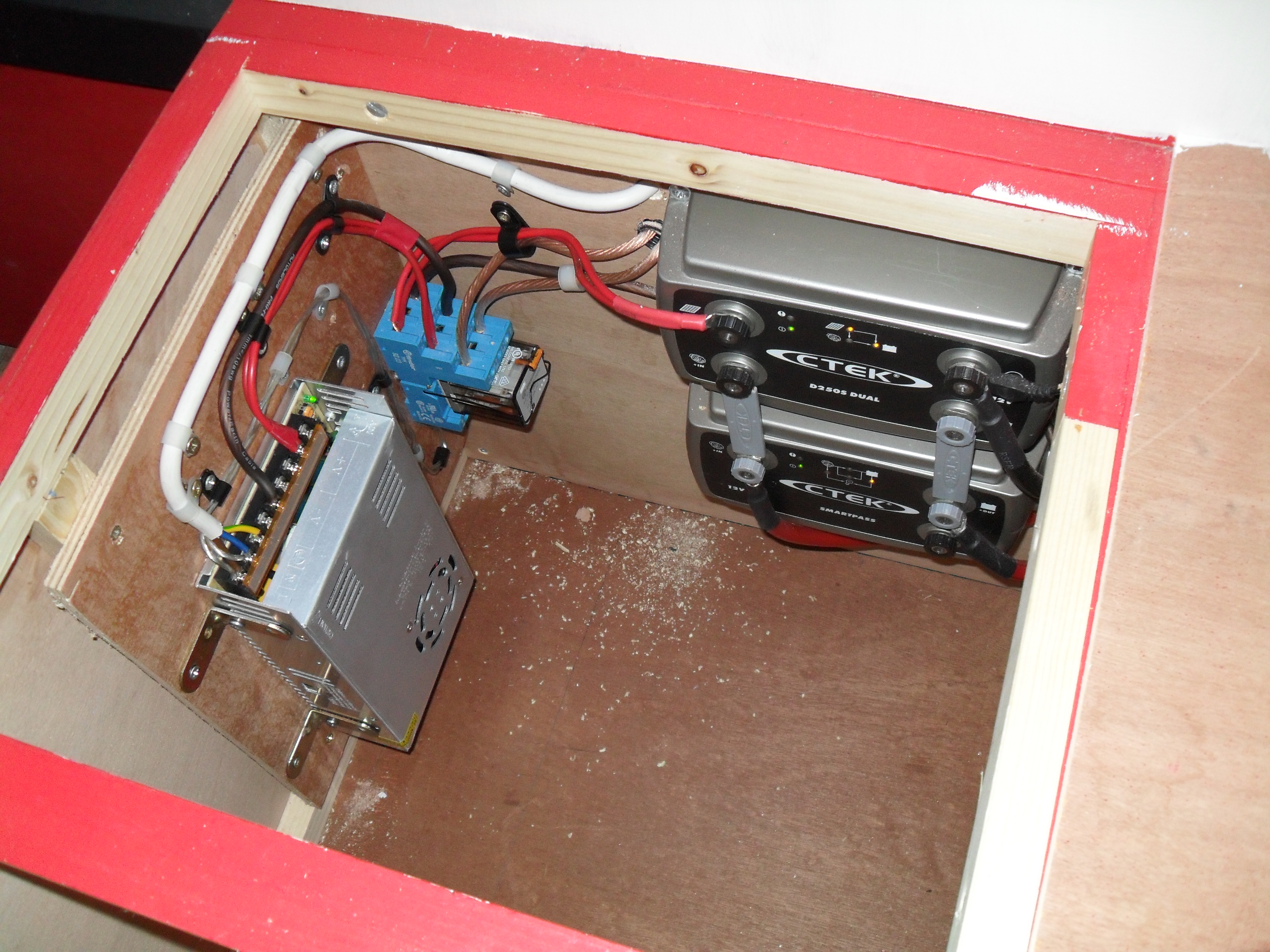

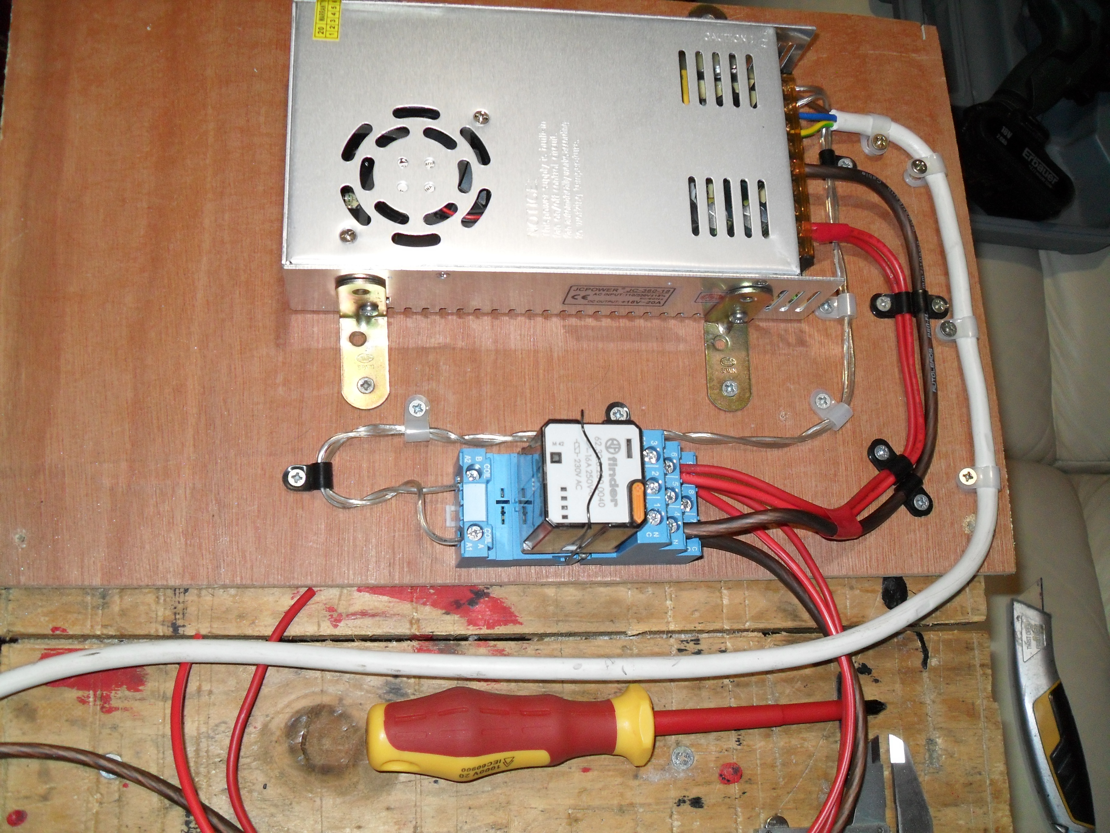

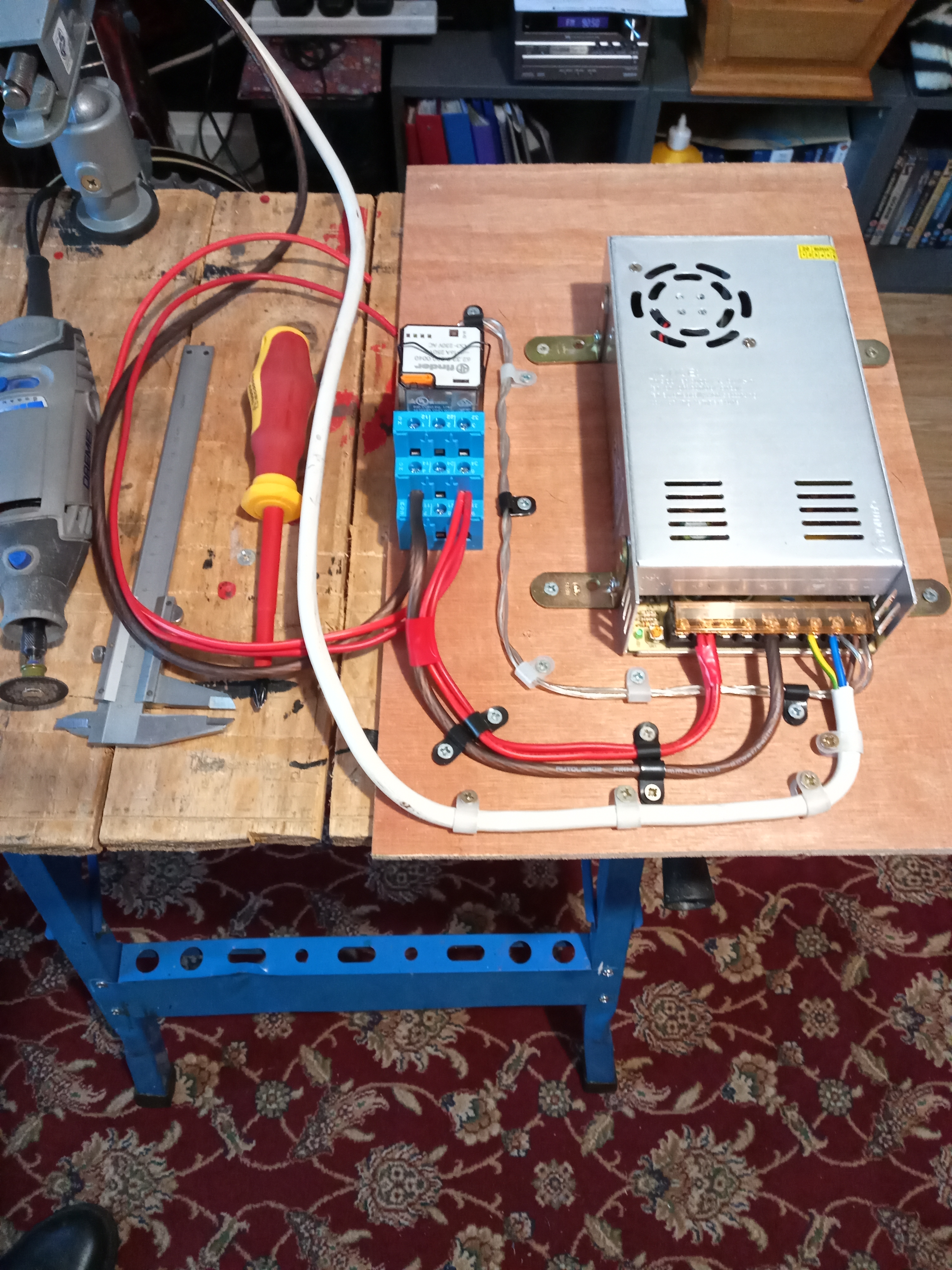

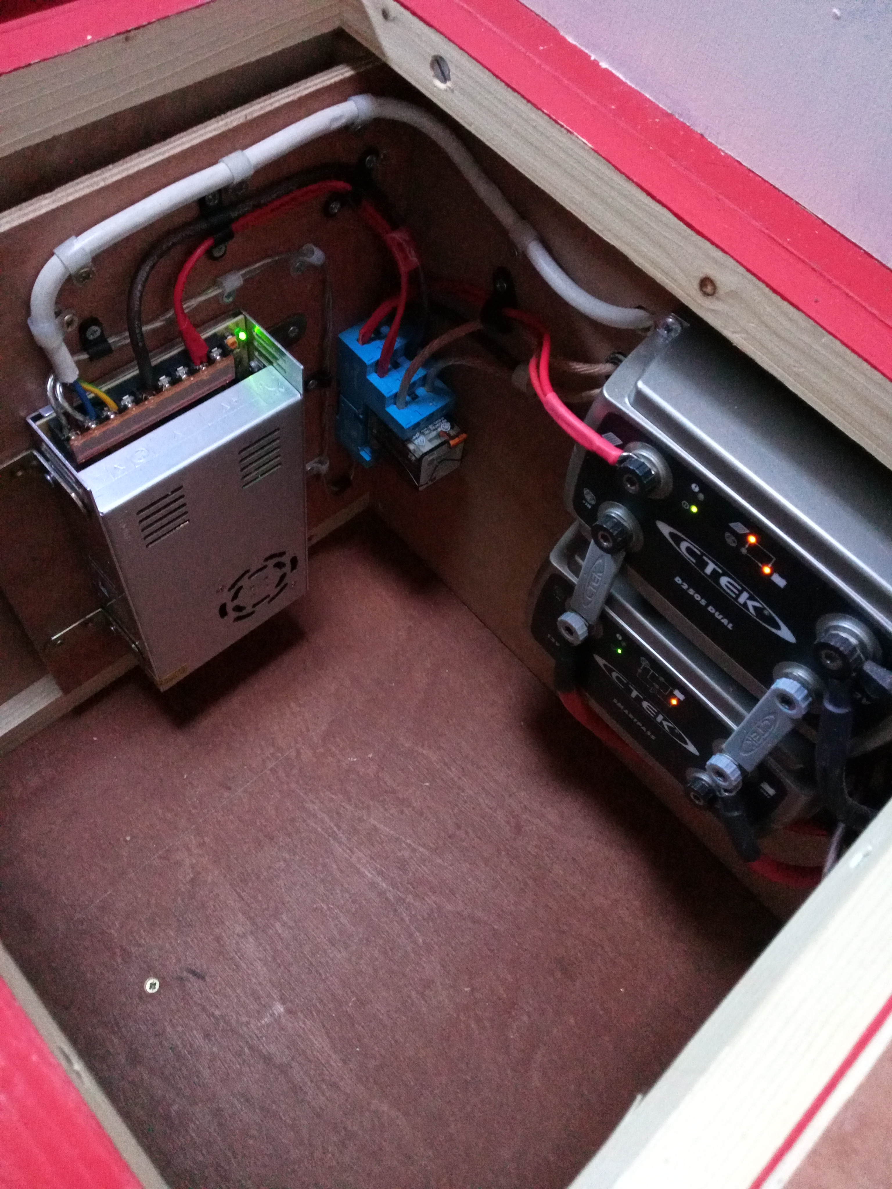

Some time ago I had a conversation with Phil (admin) about battery charging, and how it could be done without a battery charger....interesting and then put it in the file section of my memory banks. Well with the lack of sun and not using the van, but using the diesel heater, I thought I had better put in mains for battery charging, so after contacting Phil who gave me info on what units to get, I now have mains battery charging capability. I needed to buy a power unit that would deliver as near as possible to what my solar would deliver in full sun, and a dual pole double throw non latching mains operated relay, both of which arrived this week. So then it was a case of collecting bits out of the cupboard so that I could start the installation. The solar and the power unit are both fed into the solar terminal on the Ctek via the relay.The relay is energized as soon as mains power is connected and solar panel is isolated.

Did you actually need the relay Deb? Would it not just lose any excess if both solar and mains fed together? I ask as on very good harvesting days I overfeed my controller but it just takes what it can handle
I think it does make sense to not connect the output of a Power Supply to the output of the PV Panel - it could get very confused to what it is meant to be doing? (dunno for sure. never tried it.)
It looks a tidy setup, but I must admit I would have just used a simple common off-the-shelf 5 pin relay to auto-switch between the two inputs (did a picture to show what I mean ...)
