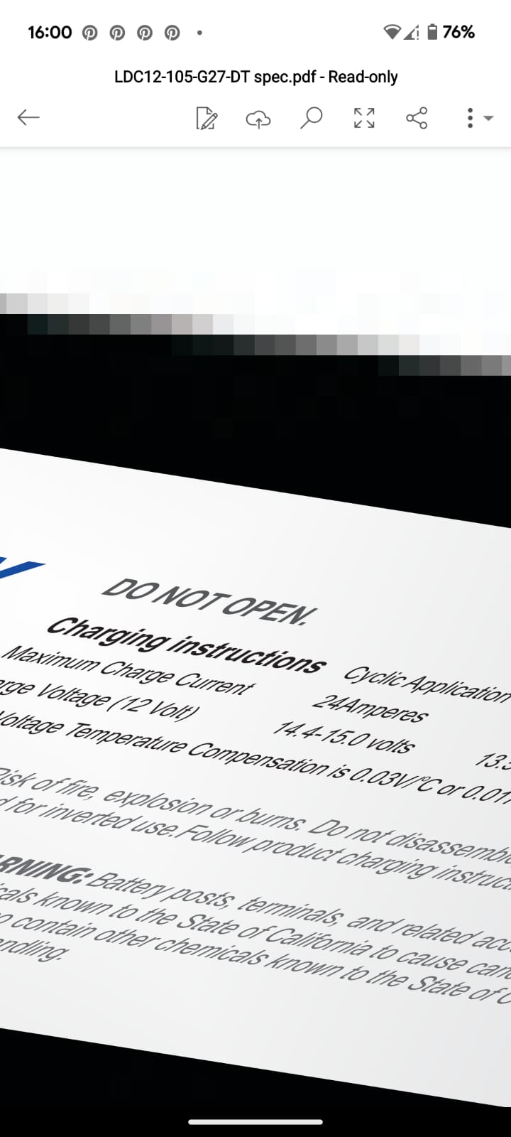

Those Carbons have a maximum charge current, if you download the tech spec and zoom in on the label on the top of the battery image you'll see 24A max charge current. I've got an idea that this has now changed to 22 but I could be wrong. Yes it's naughty that they don't openly state this in the literature and you have to wait until the battery arrives before you find out☹️.

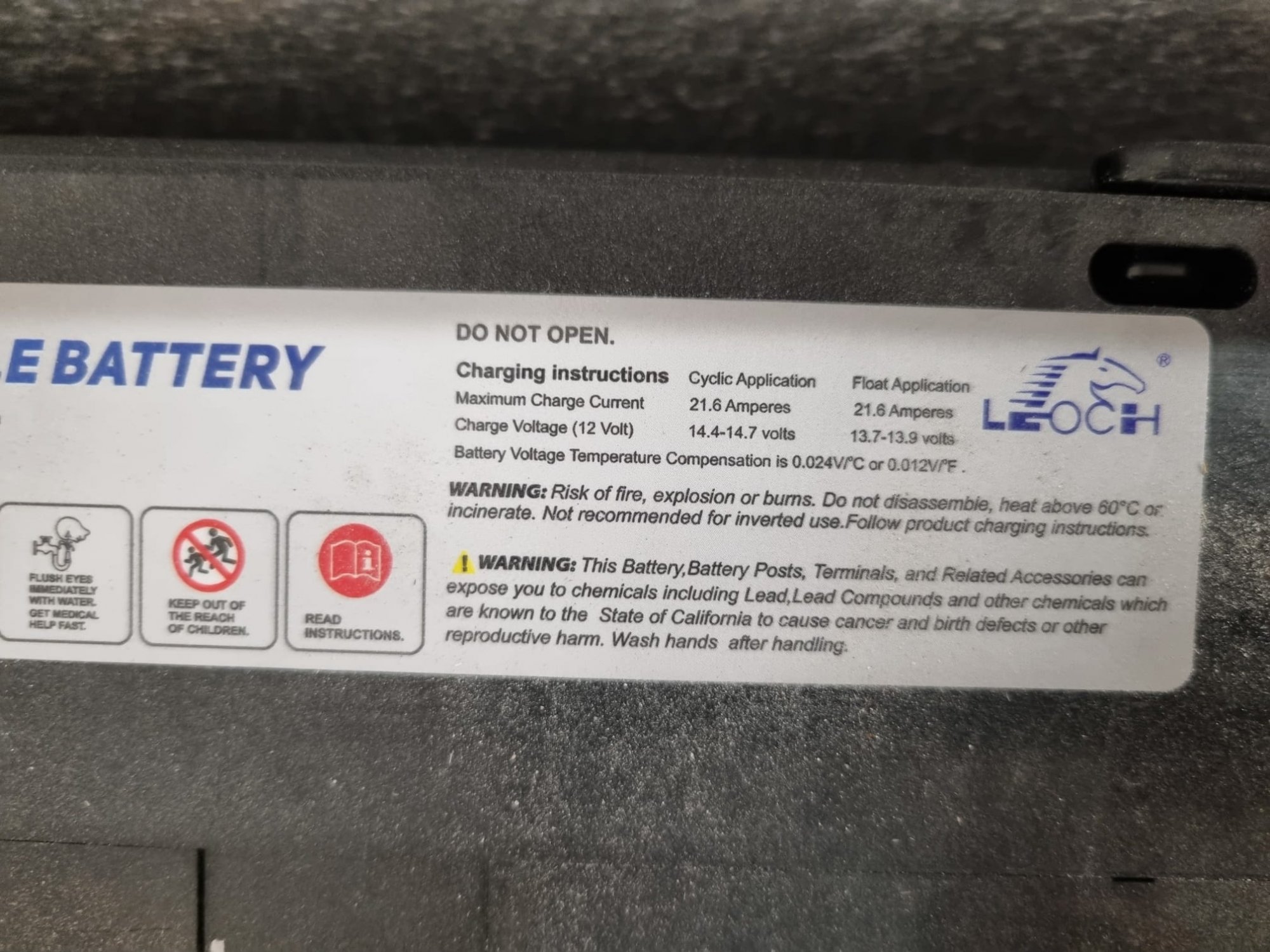

So here's that close up from their tech spec PDF
And above is the label on mine, sitting idle in the garage.
You can see 25A on the first and 21.6A on the actual item.

And above is the label on mine be sitting idle in the garage.
