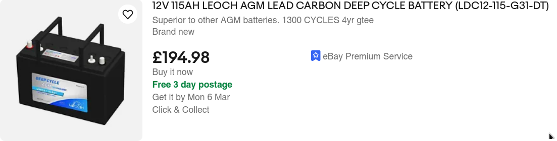

Seems as though the 12v 115ah leoch agm lead carbon deep cycle (lcdc12-115-g31-dt it shall be unless anyone has any even better idea. Not being still a member of CAMC I shall just have to swallow the £179.98 and turn the hearing aids off when Julie expresses her opinion. Thanks for the help all who contributed.

The Leoch is actually 22MM shorter though with a 5AH extra capacity so no trouble with space.
