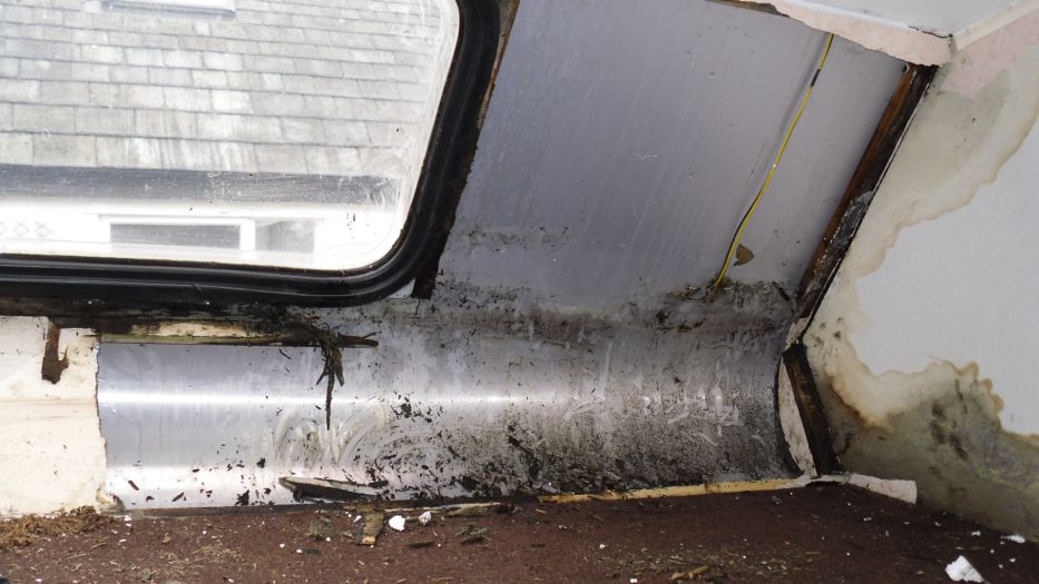

Take a look from inside the luton and it will probably look like this .......note the supporting timber has totally gone .
around the window wasnt much better ! :eek:
i organised some heavy rain in the Keswick area just to test my repairs and it is now bone dry :D
