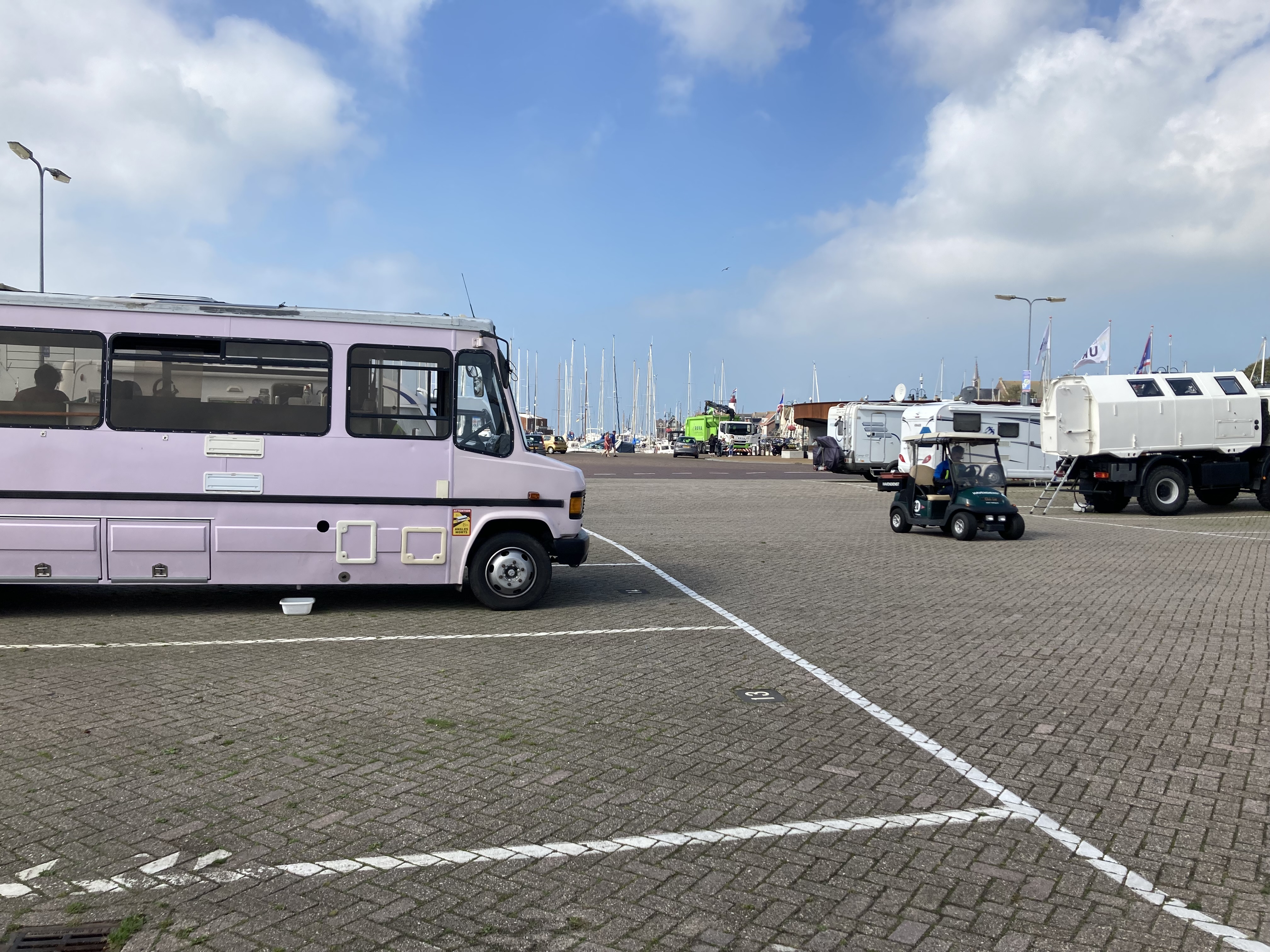

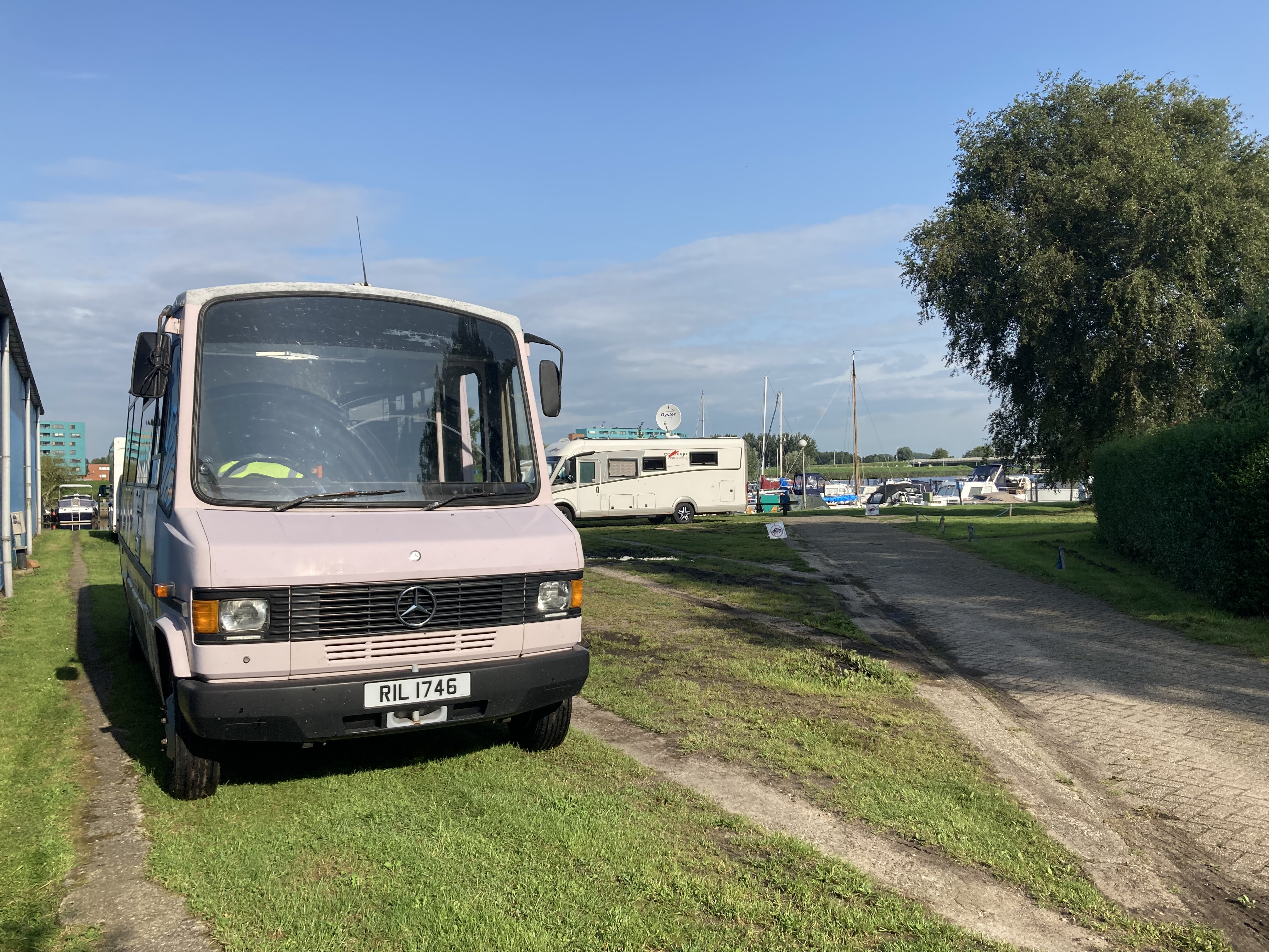

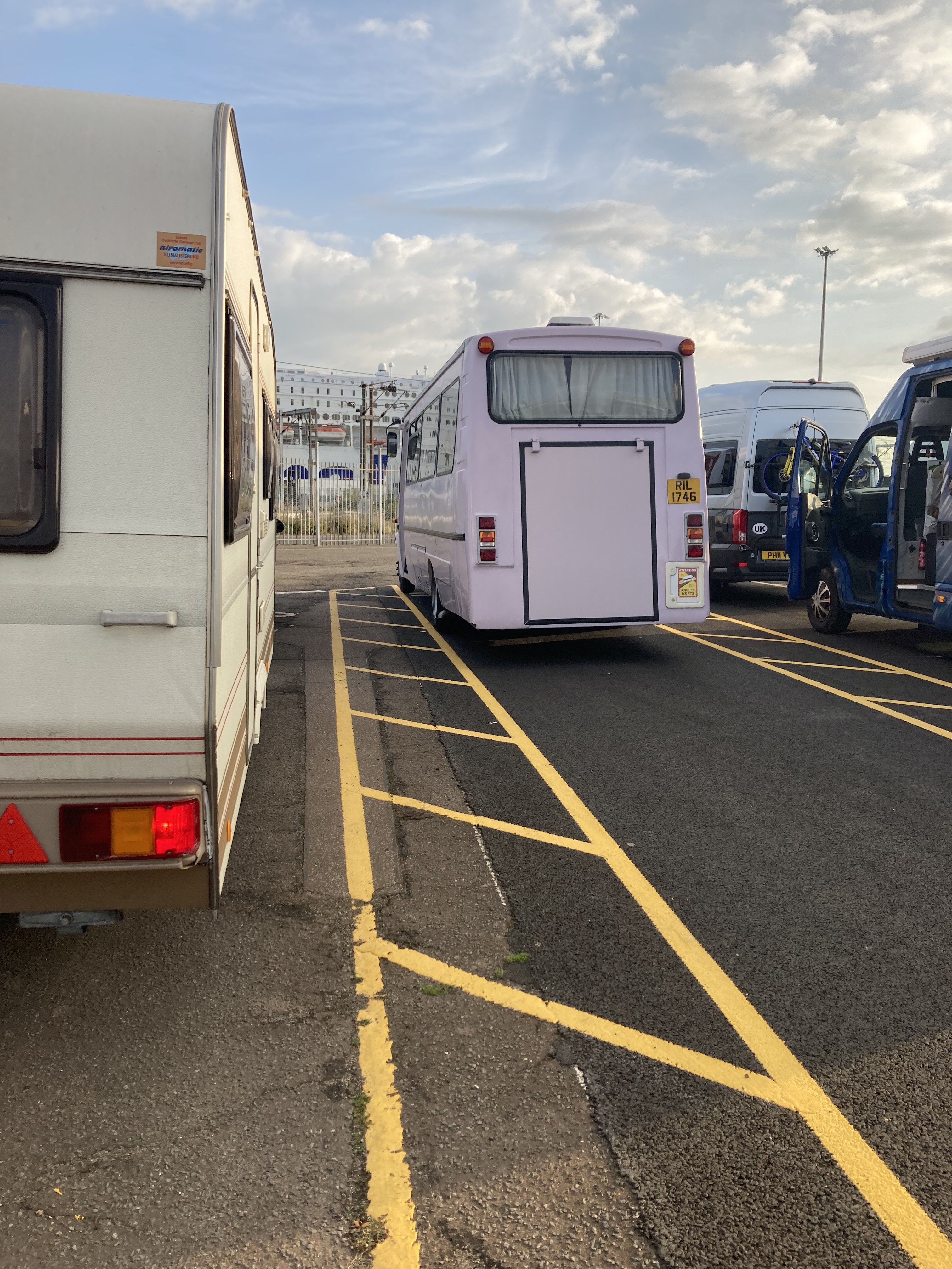

Very desirable vehicle. These old Mercedes T1-T2 & vario’s are very sort after. Good luck with your sale..
I’m sure it will sell easily
