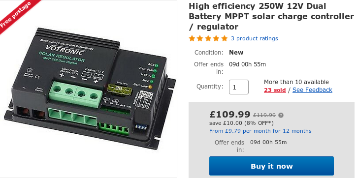

trevskoda Full Member Posts 38,118 Likes 51,887 Jul 31, 2019 #7 This is what im using now,it also has a one amp trickle to starter battery. Attachments solar duel a.png 184.1 KB · Views: 105
alwaysared Full Member Posts 1,447 Likes 1,820 Aug 1, 2019 #8 trevskoda said: This is what im using now,it also has a one amp trickle to starter battery. Click to expand... That's the one that I'm using but I will probably go with Victron when I get my next van if everything I've read about them is true. Regards, Del
Nabsim Full Member Posts 4,811 Likes 5,946 Aug 1, 2019 #9 trevskoda said: This is what im using now,it also has a one amp trickle to starter battery. Click to expand... Yes and me Trev, very happy with it as well, B2B is Votronic as well
