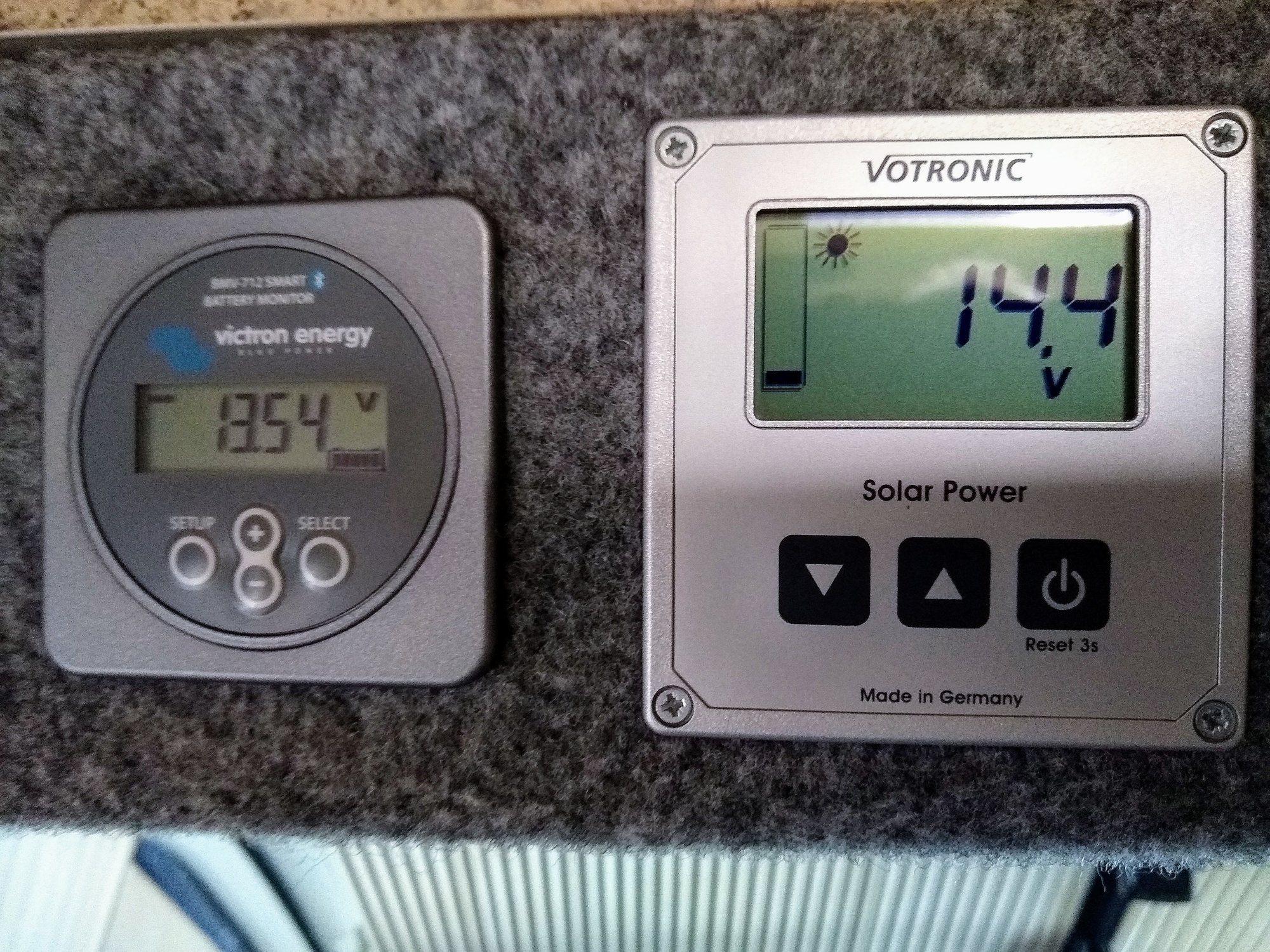

This will charge engine & hab batts, 1 amp to engine .they do larger units to.
thanks Trev - what is the unit to the left in your picture ? thanks
Solar Computer. It's an optional additional unit that connects to the Votronic controllers and shows the charge, voltage and power being fed to the batteries in real time, as well as totals since last reset.
