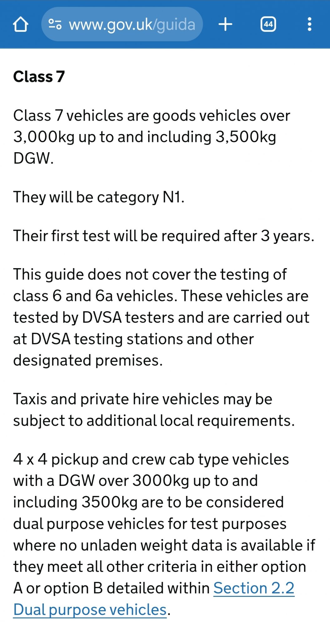

Class 4 as has been stated - and would confirm from my own experience.
As an FYI, Class 7 is a Red Herring ... that is for commericials between 3.0t and 3.5t, so wouldn't apply in any way or form.
If you DID try and get an HGV MOT, you would also find that almost certainly impossible as you won't have an HGV plate so cannot be tested by VOSA.
end of the day ... Class 4 MOT. Probably need to go to a station that deals with larger vehicles purely due to the physical weight and size of the Motorhome. Cost is the standard Class 4 MOT charge at the most. many stations discount (I pay £40 for my MOTs on >3.5t vans)
