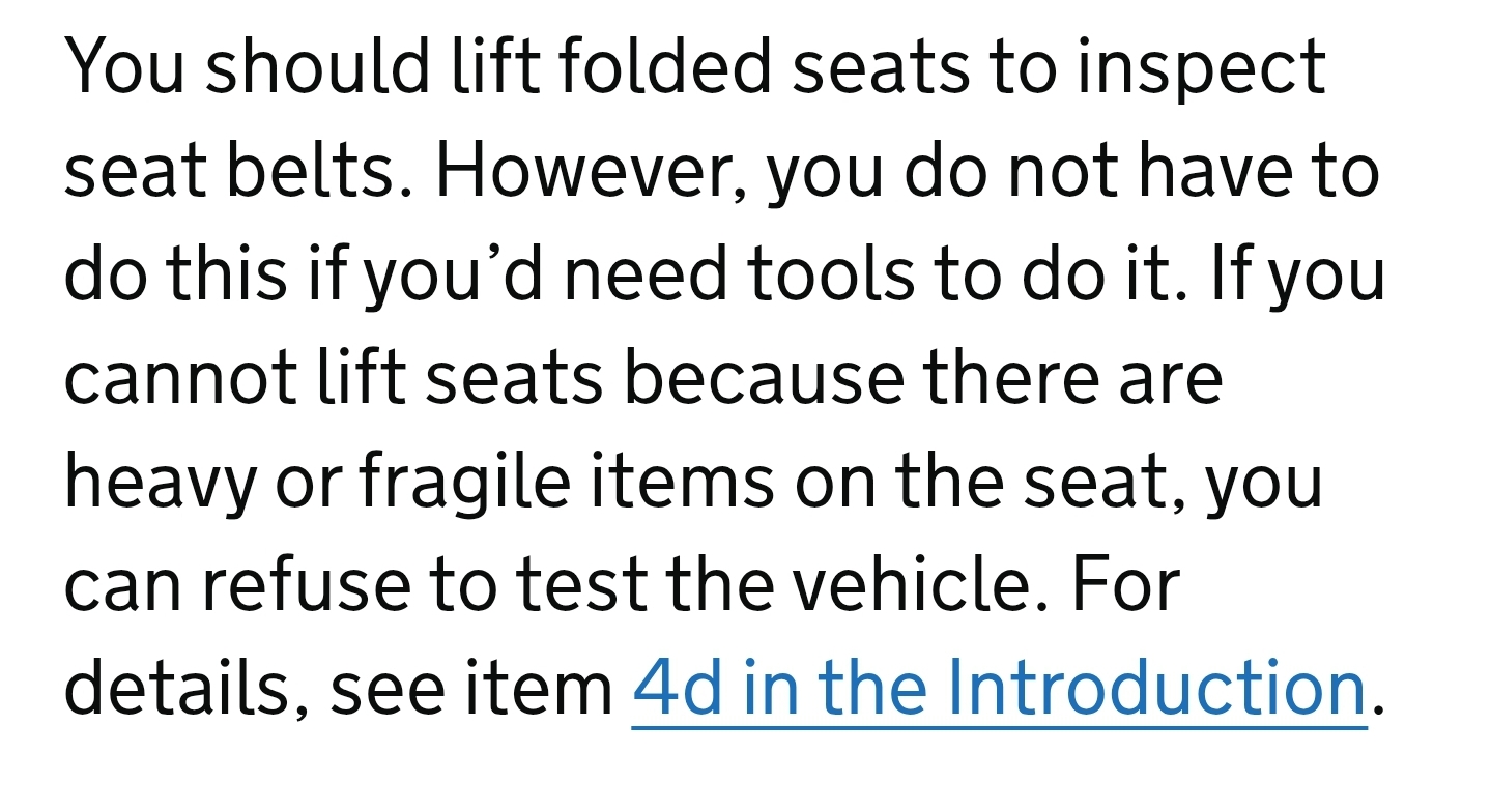

If you have a 5 seater car and the rear seats are folded down, the rear belts aren't tested.
Nope ....

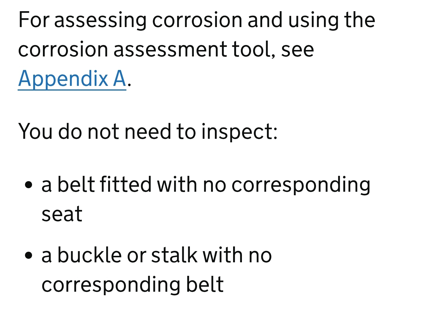

What if the seats are not in the vehicle then? (for example, on my old RAV4s, you can remove the rear seats entirely to make more room.
And on a Camper with a rock and roll bed, if the seat is down, the tester doesn't lift it to check the belts if they see belts fitted.

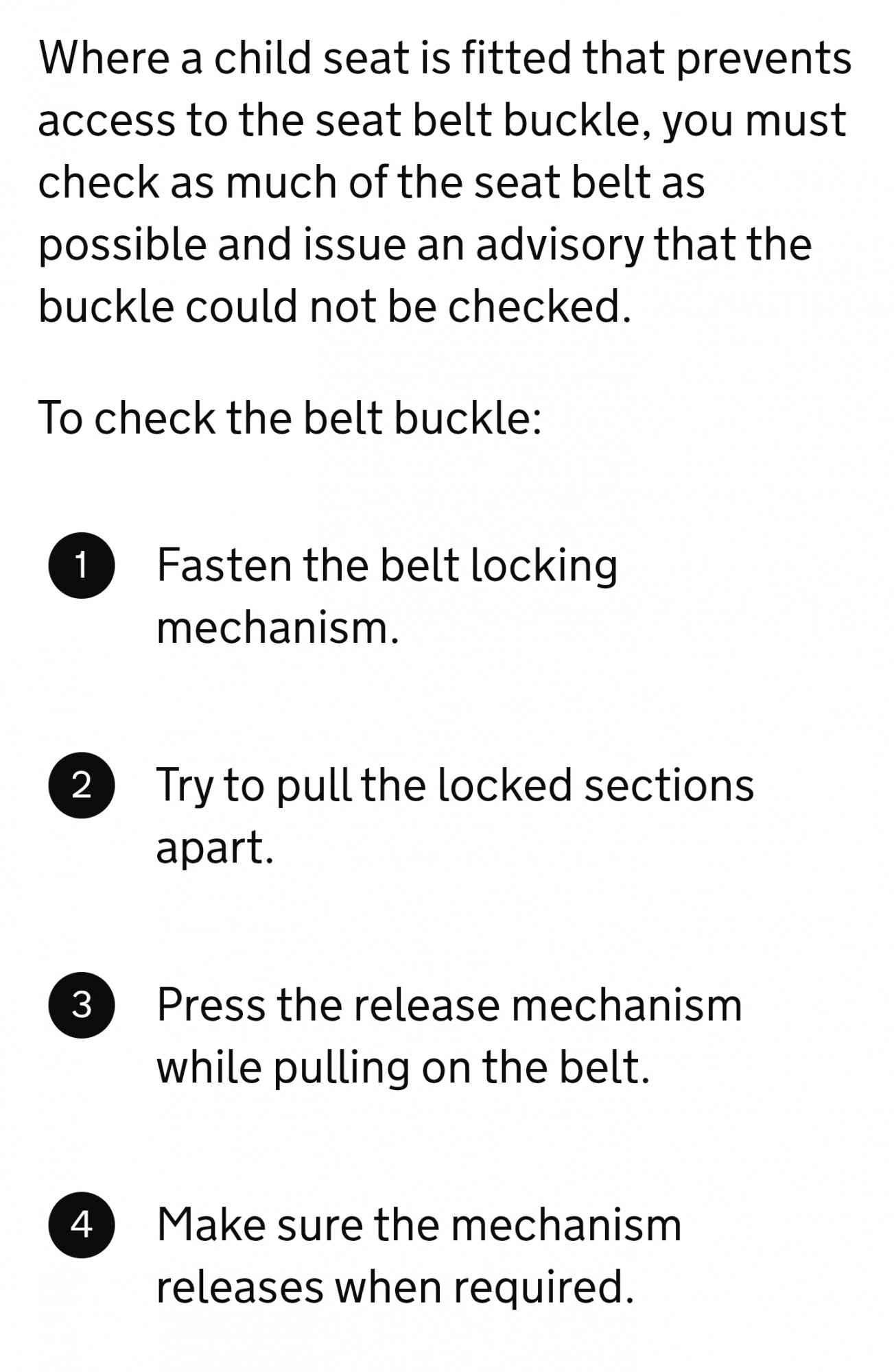

on my old Nissan Qashqai, every MOT after I sold it had a note saying "rear belts not tested due to child seat blocking access" or words to that effect.
I guess the key is in the words you posts ...." you CAN refuse..." and not "you MUST refuse". and "you not not have to do this ..."
Testers don't move or change things to test - the vehicle is tested as presented.
Belts for removed seats are not required to be tested .
Child seats fitted are covered by this bit ...
Rock and roll beds are covered from memory by not being inspected IF they are in bed form
In seat form the belts WILL be tested .

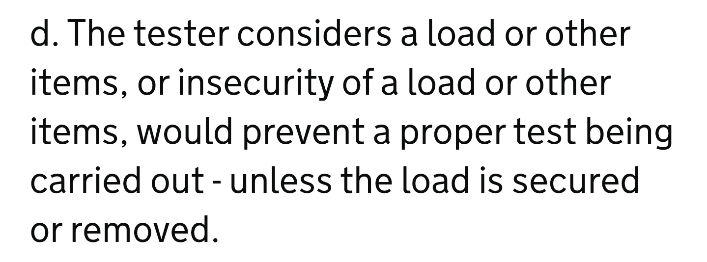

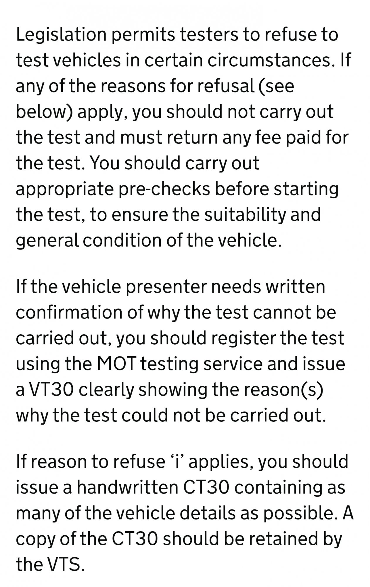

The refusal for testing regarding folded seats is covered in part D .....
