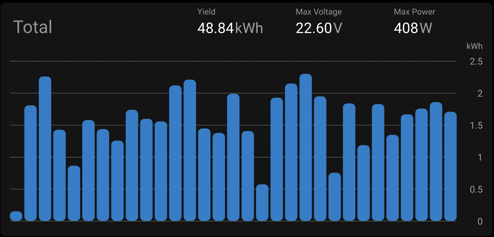

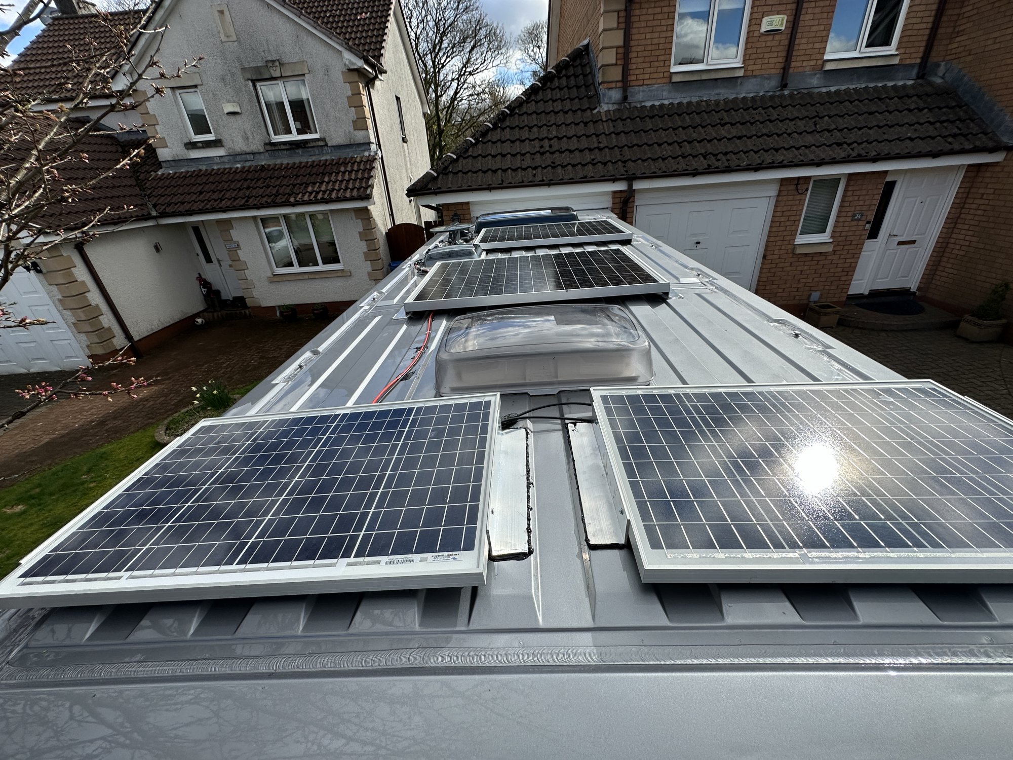

I have a similar setup with multiple panels of two different sizes, going to the one controller.I have four panels on my roof two View attachment 144115120w and two 45w.
Although their max rated output is only 330w I have achieved up to 360w whilst down south and in the north of Scotland this year I have managed 295w.
And the two larger panels are mono crystalline, whilst the two smaller ones are poly crystalline.
