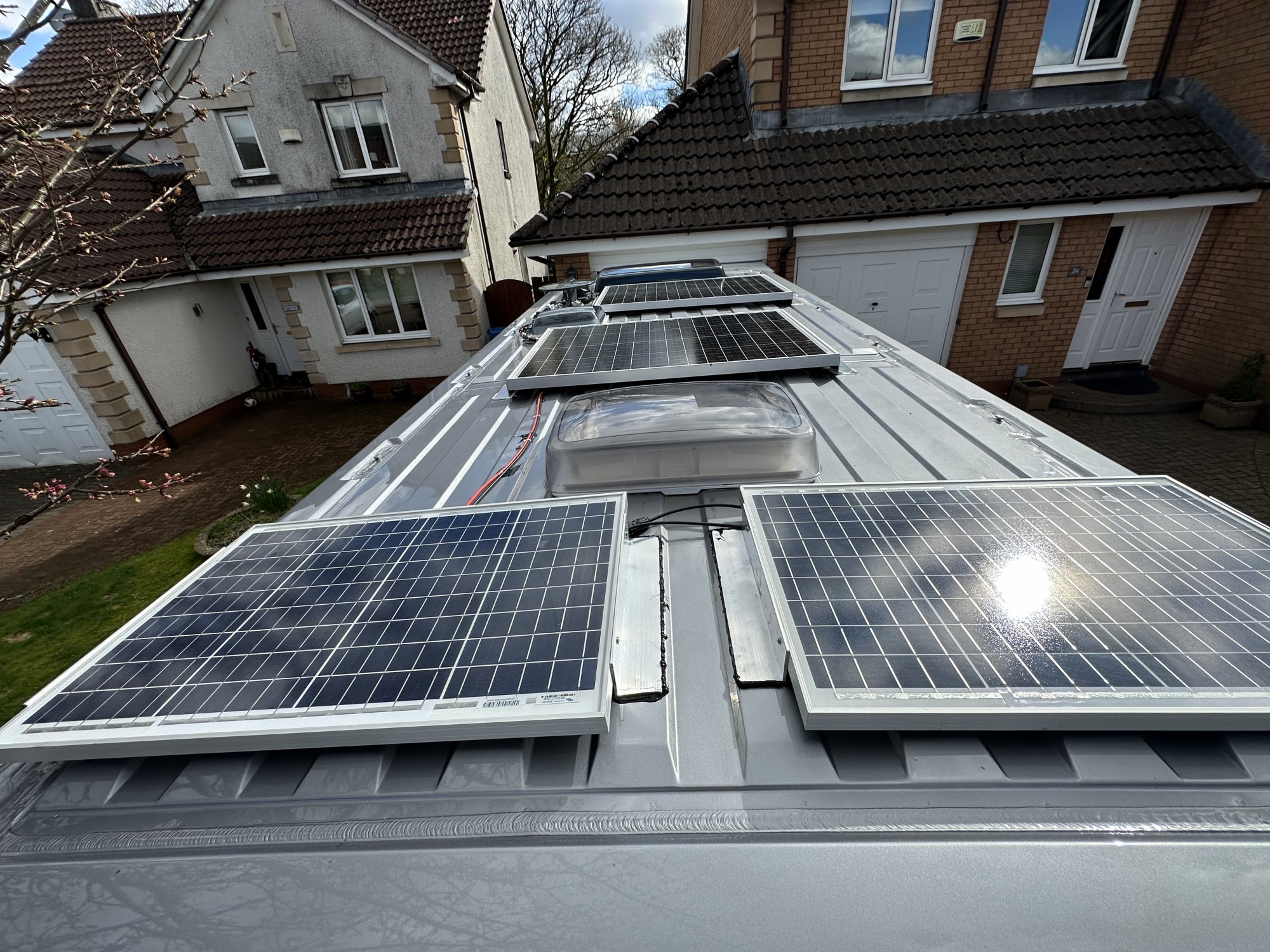

I have four panels on my roof two View attachment 144115120w and two 45w.
Although their max rated output is only 330w I have achieved up to 360w whilst down south and in the north of Scotland this year I have managed 295w.
And the two larger panels are mono crystalline, whilst the two smaller ones are poly crystalline.
