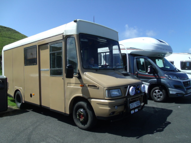

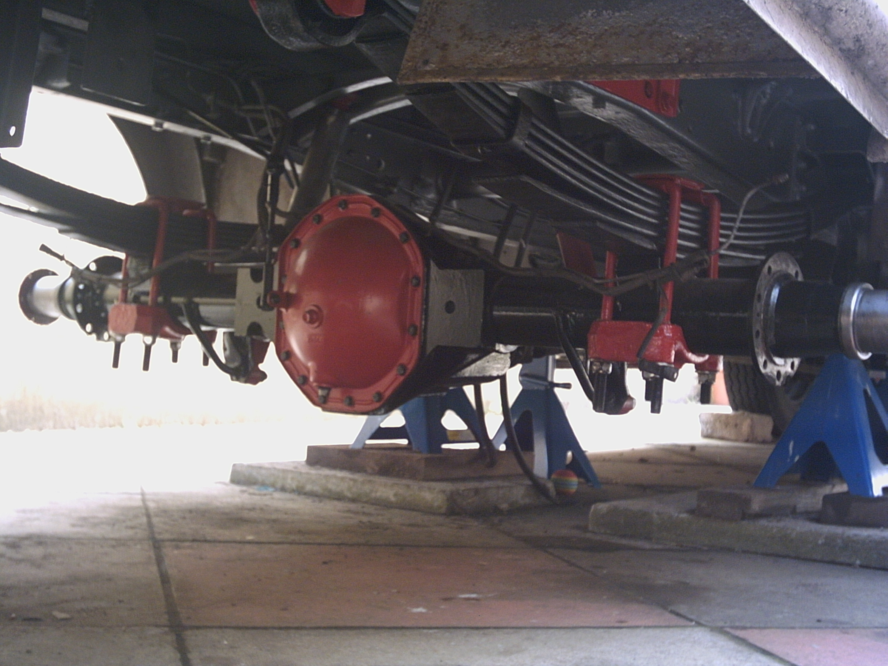

Mine is a old 59-12 bus 2.8 turbo and built like a tank, but if it has a cam belt then change it, make sure its got a high ratio diff if r wheel drive, if front im sure it will be ok, do look over the electrics as this is the weak point on i ty trucks.
