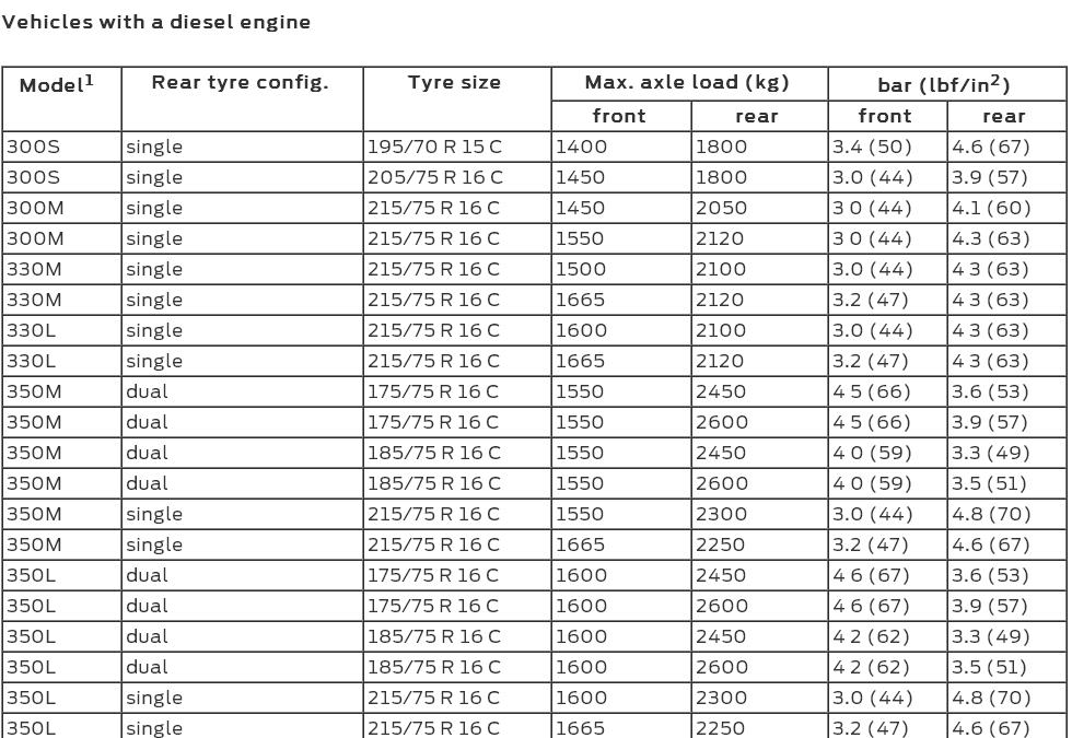

I think the tyre pressures required are as per the vehicle manufacturers rather than the tyre companies. A real bugger to find the right info. I have a transit chassis cab (3500kg) and the recommended pressures on mine are 62 front and 51 rear (twin wheel) its obvious twin rear wheel tyres will be lower pressure overall too. Well it is obvious now after about 6mths of all sorts of stories on what the correct pressures are, including asking Michelin. Its the vehicle, weight etc above all that count.
Have attached a transit tyre fitment... I think lol
