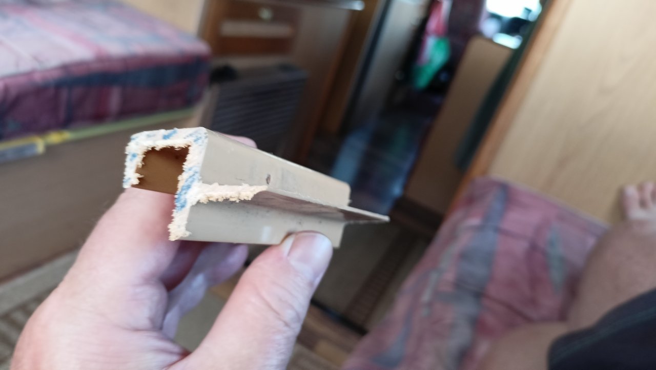

The plastic bed runners that support the pull out bed slats on our 1996 Swift Kontiki are once again on their last legs. They get brittle and break in places and unless you have spare sections (which I do carry) your literally stuffed when they break. Broke a section this morning, cut a new six inch new bit from an old cut off and taped some aluminium over the top to give it a bit more support but that got me thinking. Could I get some aluminium ones cut to size and if so by who? Can anyone on here make them?

Here's a photo of my excellent handy work. I think they are 115cm long X 2

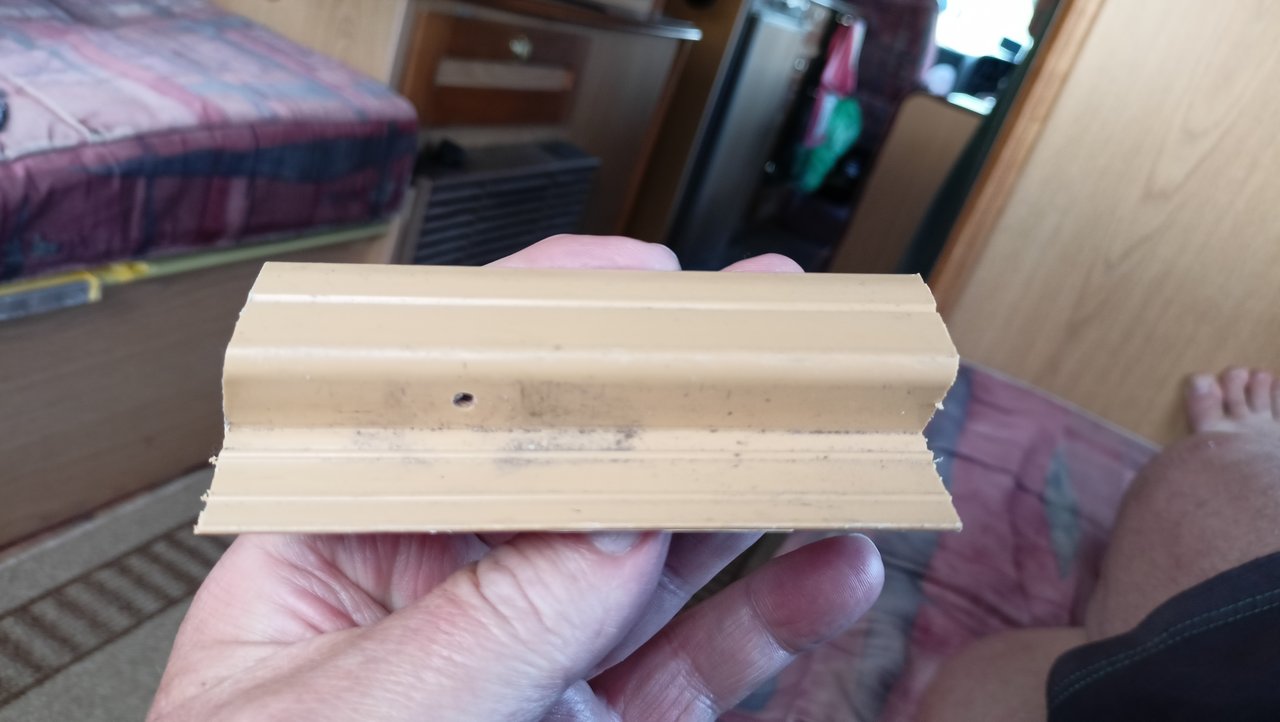

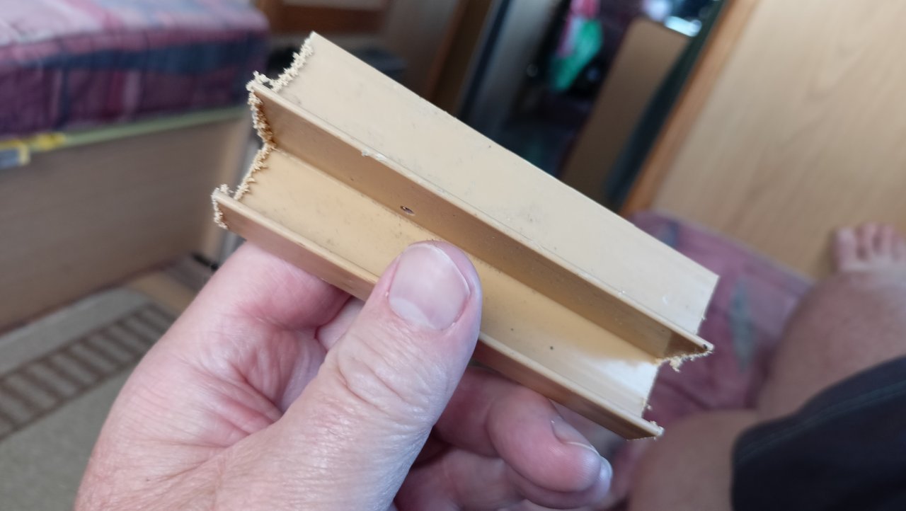

This is a bit of spare I have cut out the old original runner. It's slightly different to the one that is currently in place.
Looks a bit more complex than I thought really. I'll be heading up through Exeter in a week. Might ring round a few dealers there first.

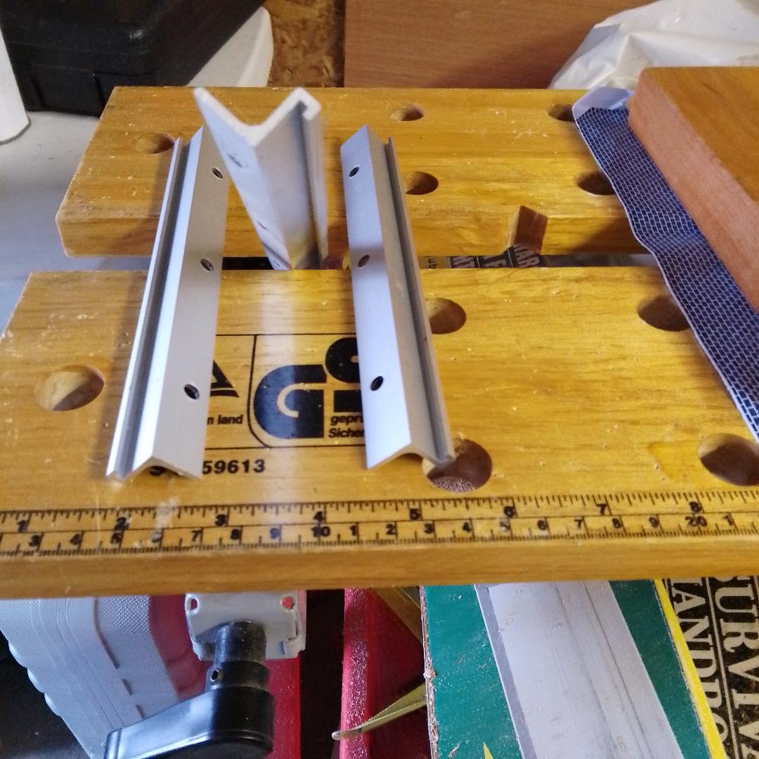

This is expensive but may be work.

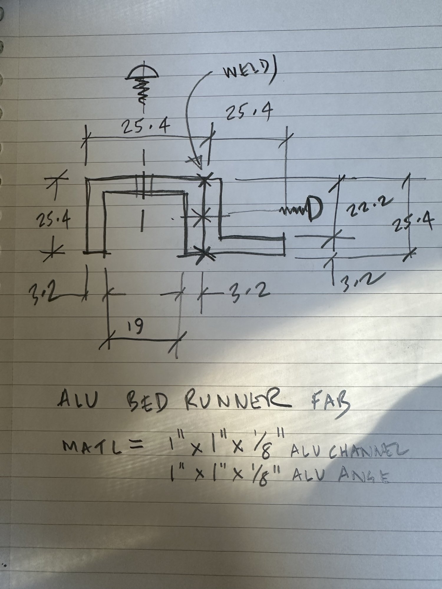

it really needs a return leg to completely cap the plywood wall otherwise all the forces will be purely reliant on the fixing screws
in a bored moment (while the missis is sunning herself by the pool) I have had some thoughts
