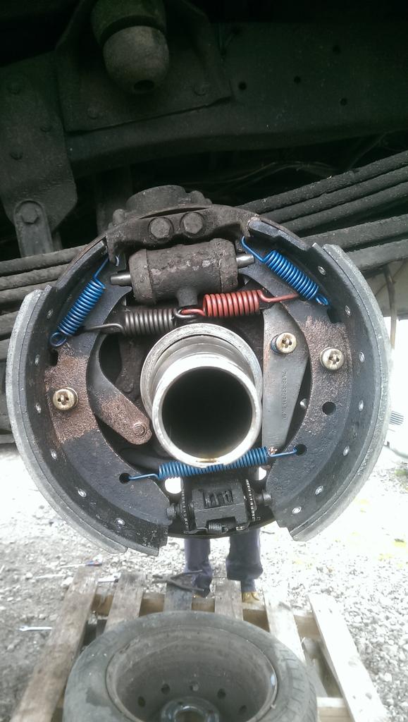

Brakes back together again, off to be MOT'd in the morning.
The image shows them back, cleaned, one of the levers replaced, some pins replaced, re-lined and hopefully fully functional.
All cost me about £400
