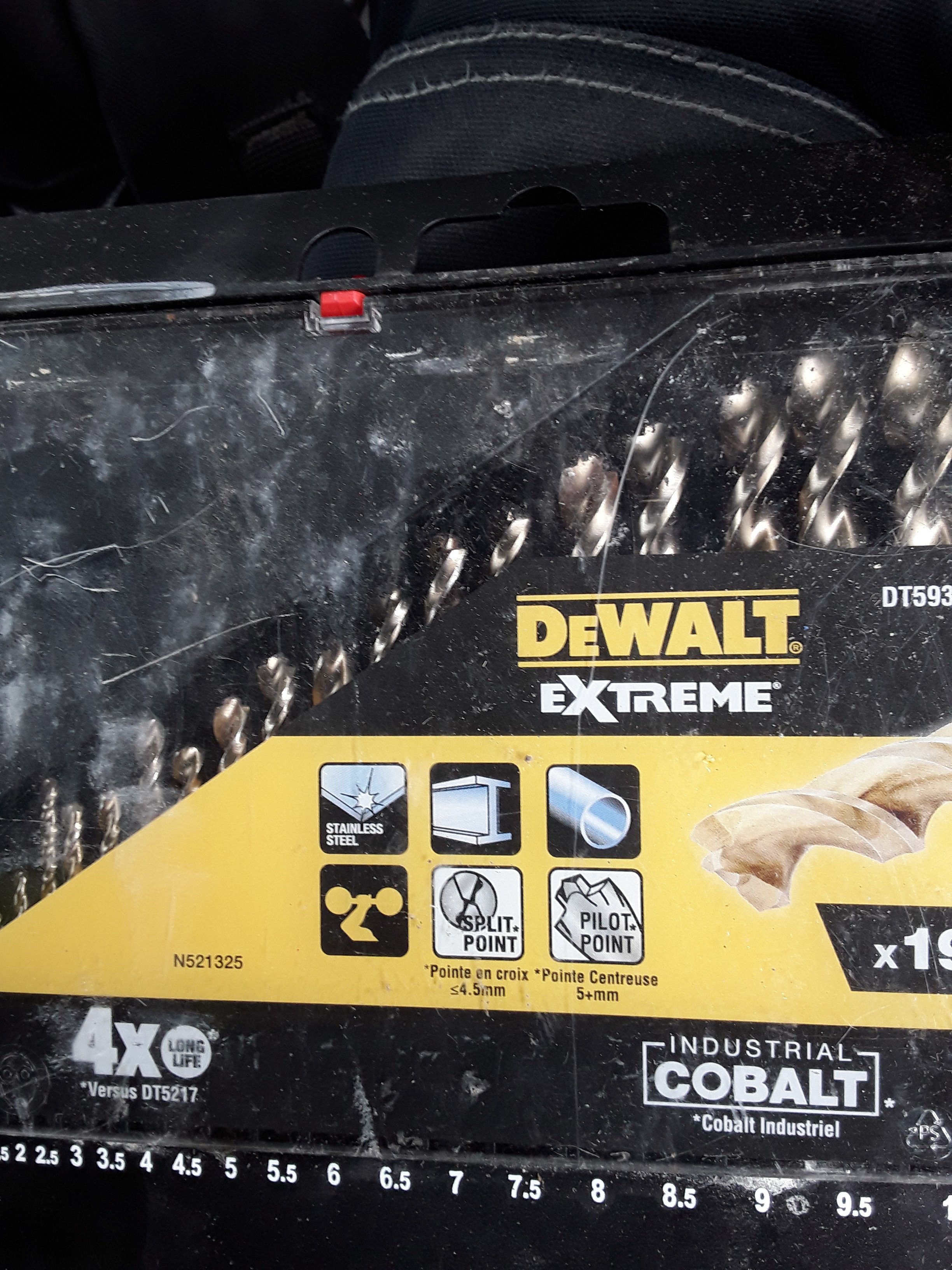

Thanks gents. Interesting that you guys have mentioned cobalt and split point as my work metal drill bits are excellent......and yes, cobalt and split

I was shocked the first time I used the ones pictured, to say they are very good is an understatement. I cant comment on longevity yet. Maybe just pick up one in the mm you use most frequently :unsure:
