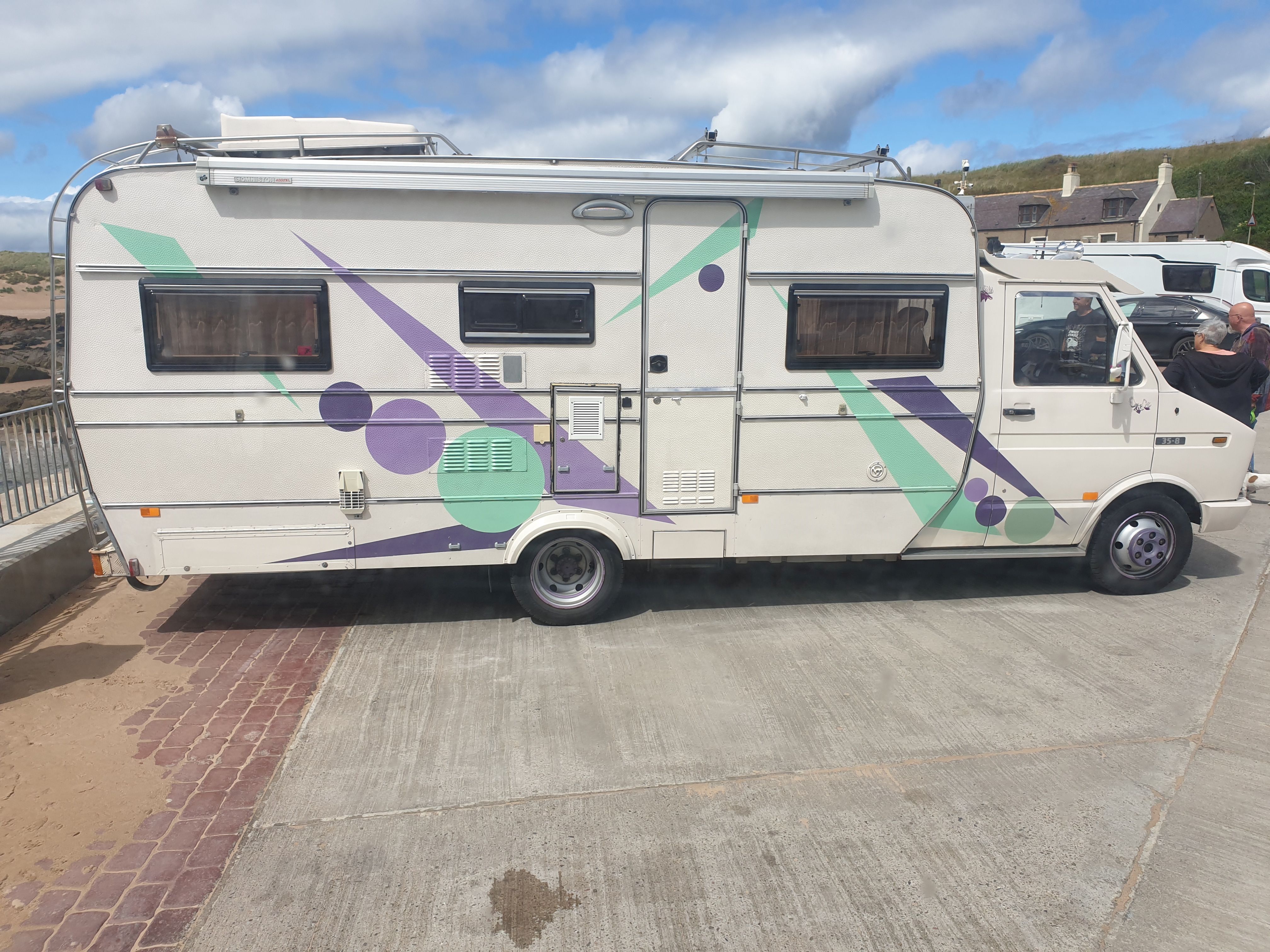

We saw this one in July

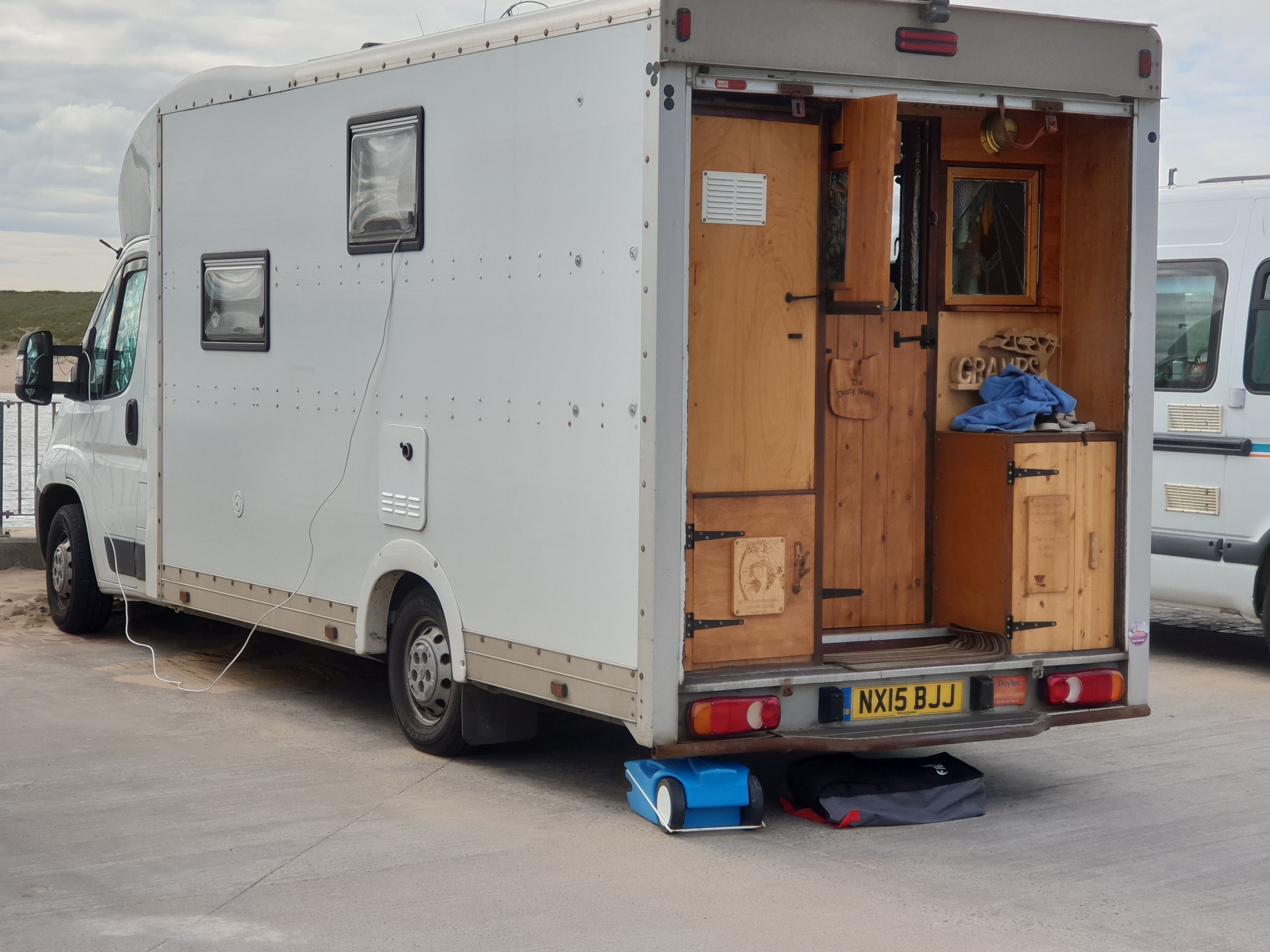

And this might be a consideration we also saw in July, both up in Scotland
