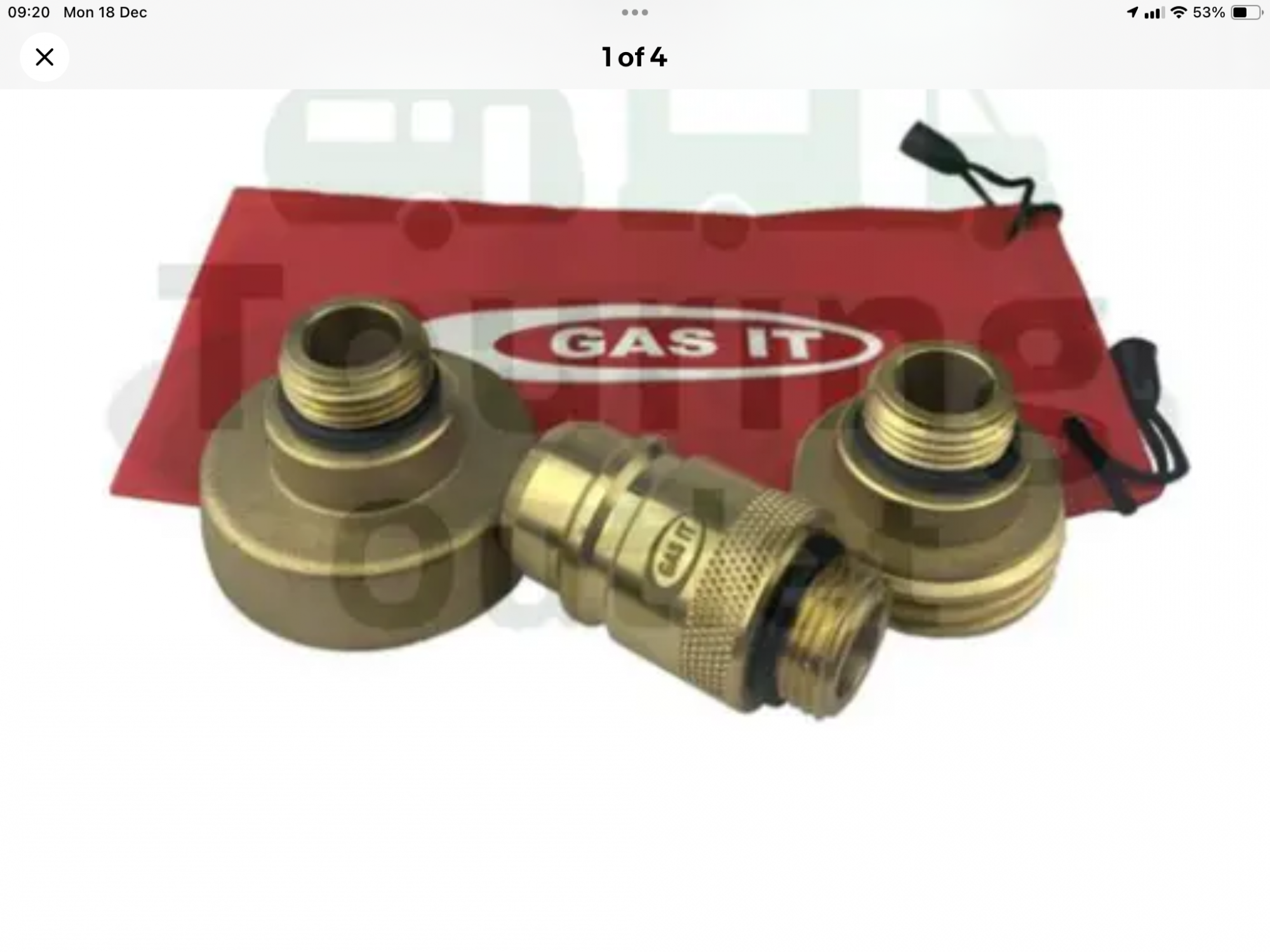

This must have been asked a dozen times but I am unable to find any threads sorry.
What's the best bet for refilling with LPG if you have a UK side filling set up?
I think they are different in Europe, is there such a thing as a converter or what?
Many thanks
Many thanks
3 different converters
Buy them online
You will need adapters
Thanks folks, brilliant info as always - just ordered the three heads from LPGshop.co.uk.

I’ve used the dish connector in all of Europe I’ve been, France, Italy, Germany, Denmark, Sweden & Norway. No lpg pumps in Finland was almost a pain. I’ve not had occasion to visit Spain and use their version yet. I’ve filled in Italy without any issues. My biggest grief was in France one time when it took visits to 7 sites before I found a pump either working or with gas. The best was in Norway, hook it up to the pump, press the button and let it do all the filling automatically, and not get thumb-ache on the button.
My new Gaslow system has an adaptor that has to be screwed on for UK as their new inlet is changed from what it was. I was also supplied with a total of 5 adaptors all different.

I have diesel cap on left side and LPG on right but never struggled to fill up either. i would recommend you have a spanner/adjustable spanner to hand as I ve found that it can be difficult to detach after the fill presumably due to thermal contraction differences between the brass adaptor and stainless steel filler
Our Gasit adaptor which is supposed to fit Spanish pumps is such a poor fit it leaks very badly, so we have to ask the kiosl to lend us one that fits. There are detailed differences. They said it must be the fault of the Spanish nozzles not their product. A few years old now so maybe they now offer ones that fit correctly.
