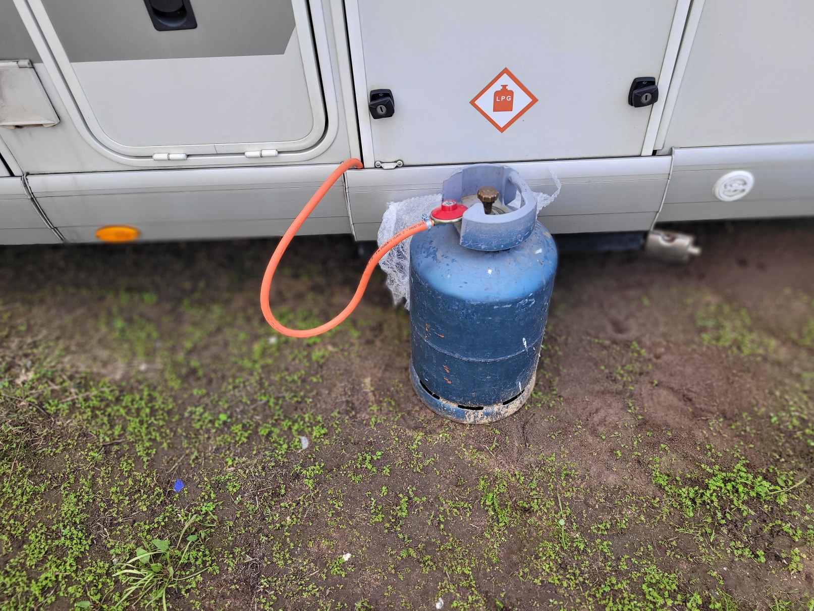

That's what a lot of people do in Morocco. Turn the underslung gas tank off, then connect a local gas bottle and regulator to the gas barbecue point which backfeeds all the appliances from the external bottle. Bottled gas is so cheap over there, works out at around 25p a litre which is a quarter of the price of LPG at the pump in Europe. I even brought a full bottle back with me! It isn't guaranteed to work, apparently some gas barbecue points have a non return valve so you can't backfeed through them, but it has worked for everyone I know who has tried.
