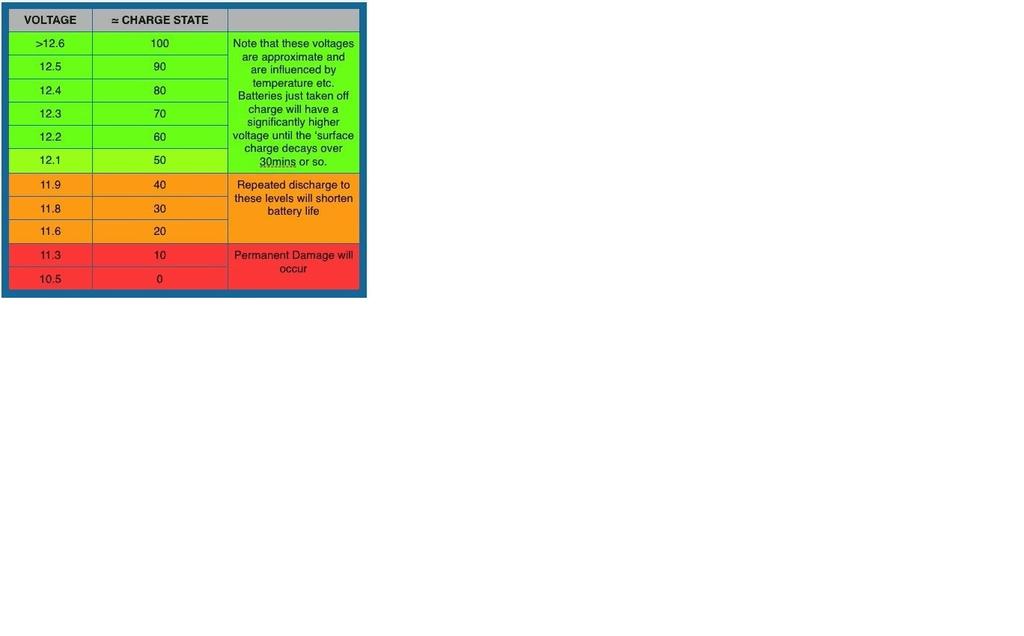

Thanks R4dent,

It is the level of true volts if only for a couple of minutes, but no indication really
of the Amperage remaining. Putting a reasonable load on as you say is more indicative of
the actual voltage reality.

Agreed if there is a significant load on the battery the voltage will appear to be much lower.
For example if you look at the voltage of a starter battery when starting a diesel, with the engine from cold the voltage might read only 10 volts.
So for example if it was recommended to not let the battery to drop below 12v OFF load, if there was a light load say from a tv or lights what do people feel would be a save volt number to go down to without doing the batteries in, remembering that as soon as the TV or whatever goes off the volts will go back up. Or would damage still be done by allowing it to go below 12v while on load?
I will try run it down to 12.2 tonight with tv on then see what it rebounds to after switching it off.
