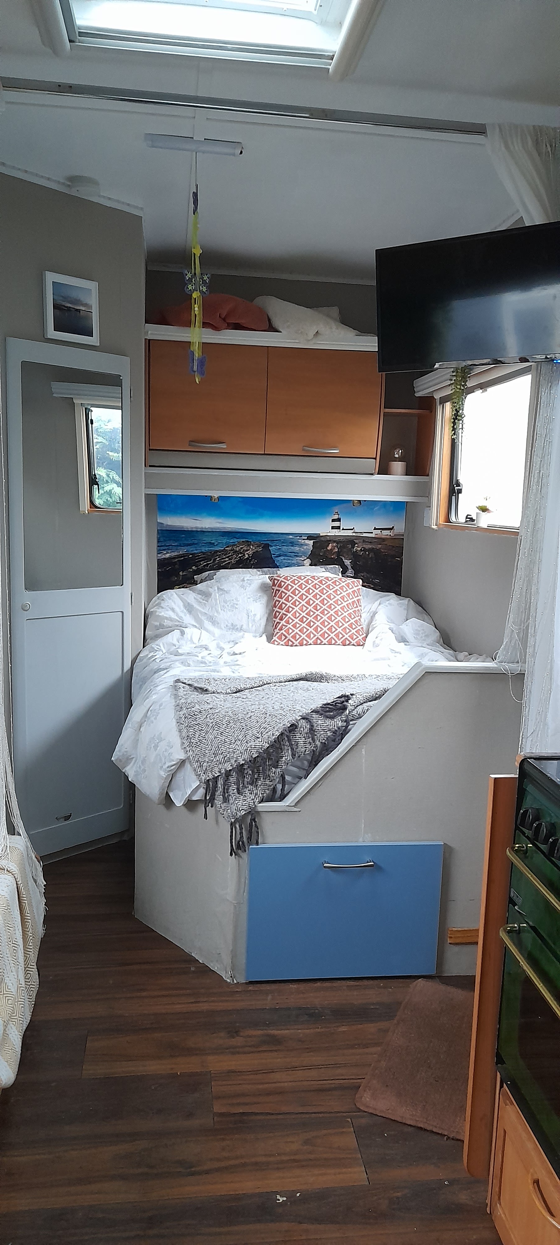

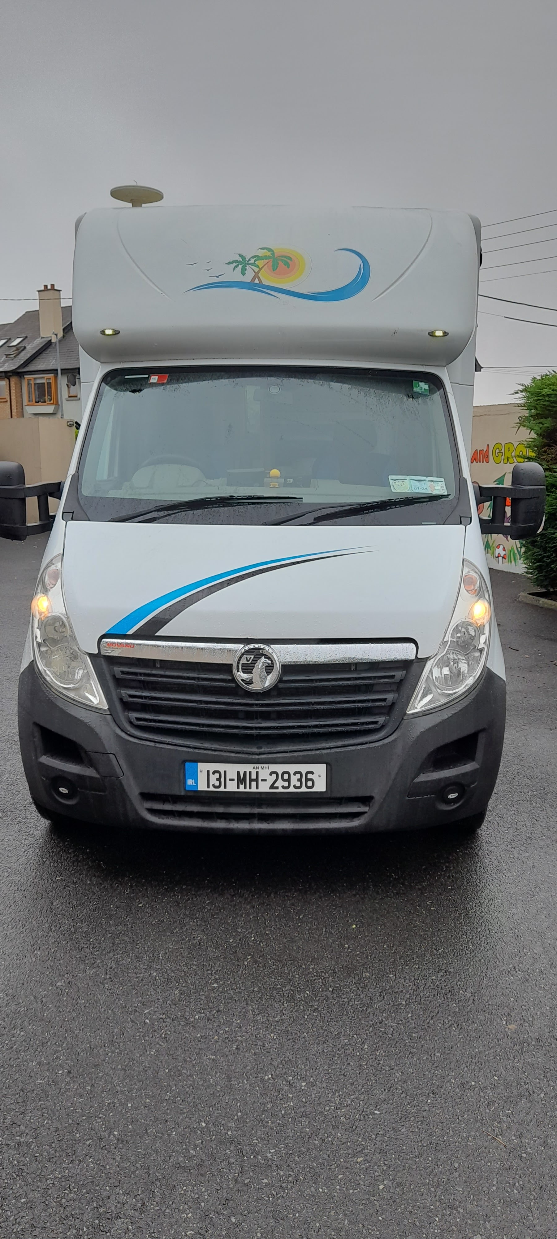

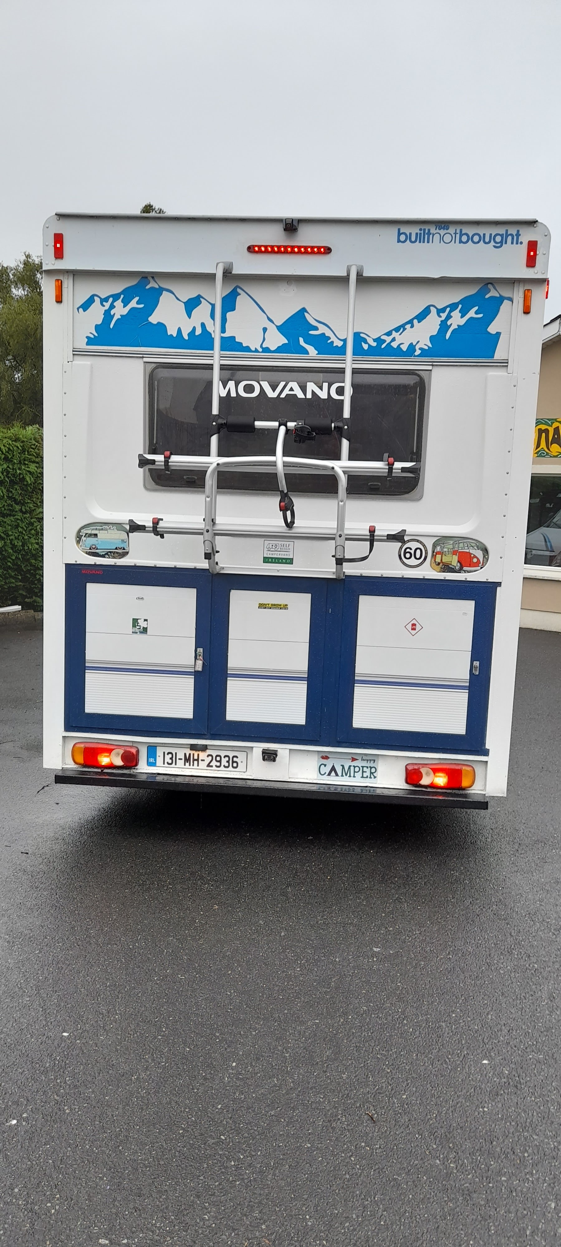

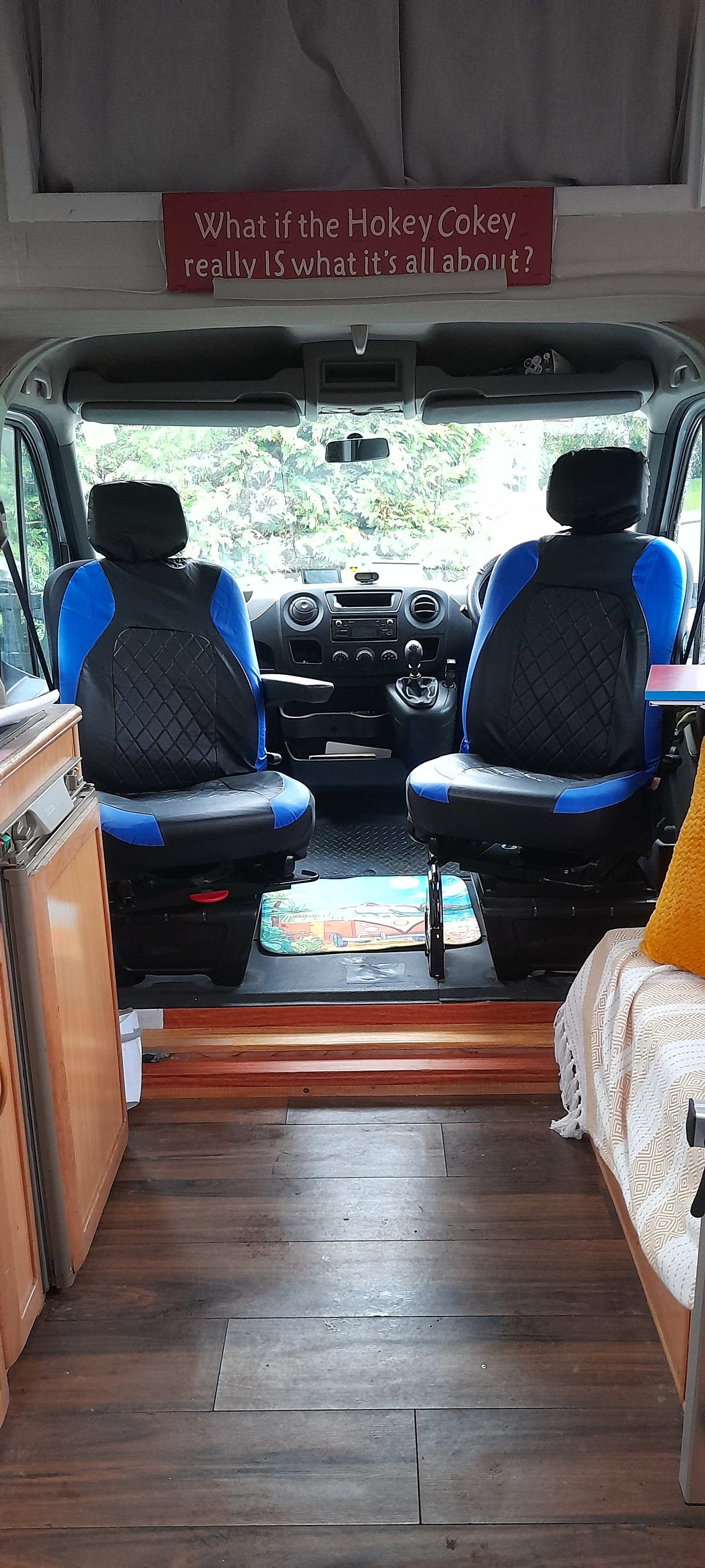

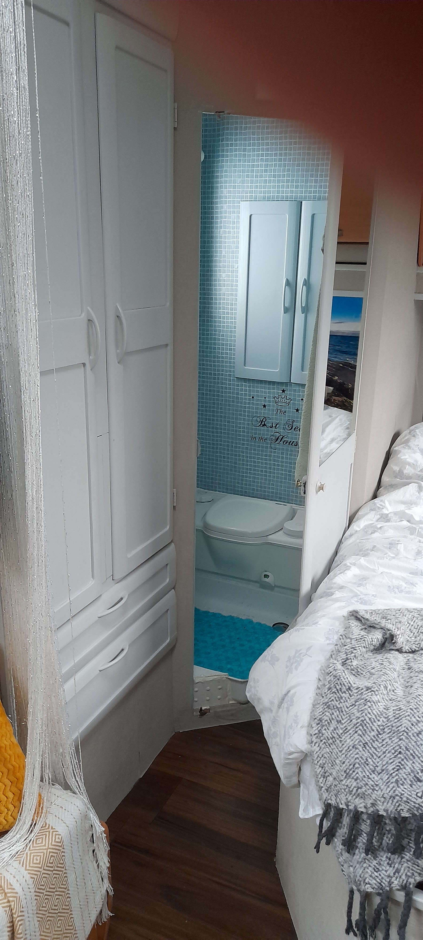

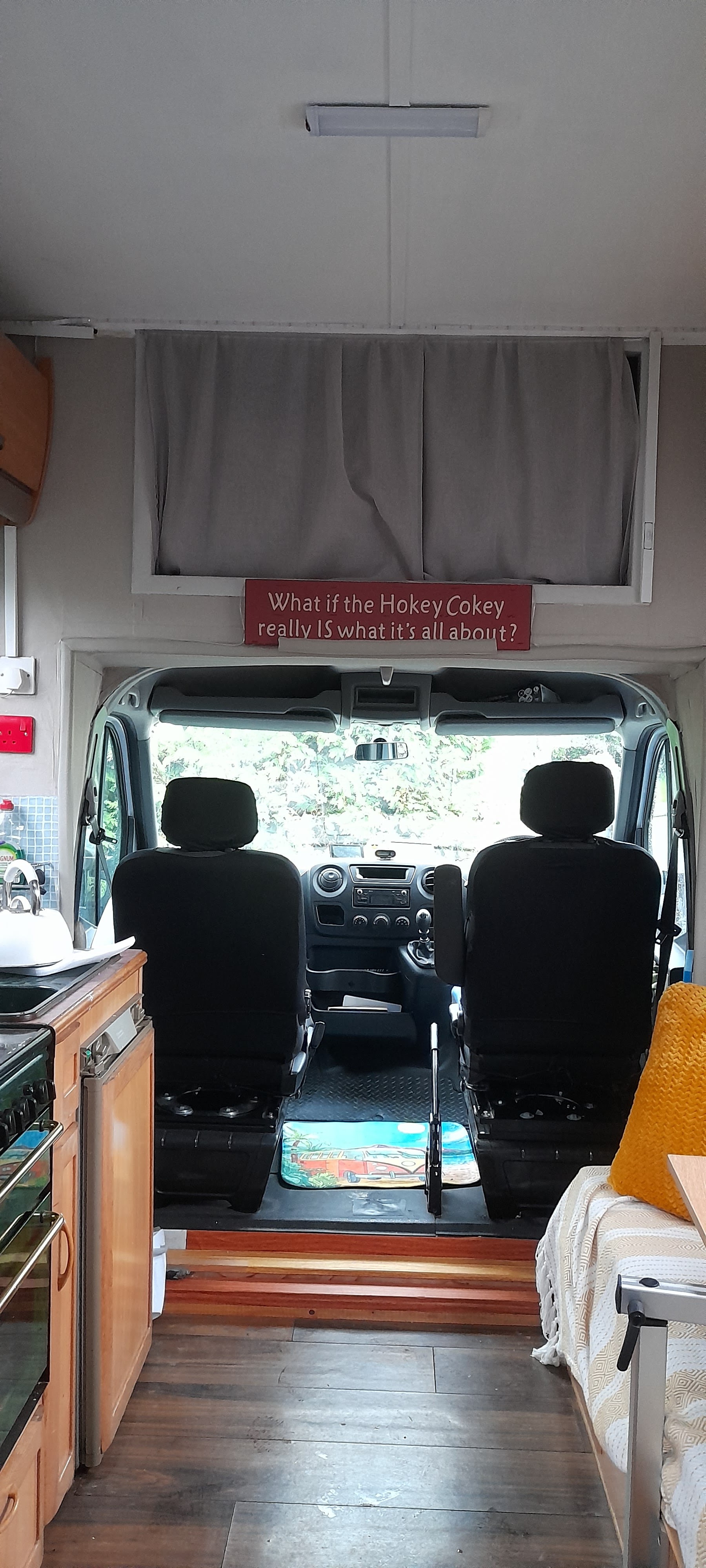

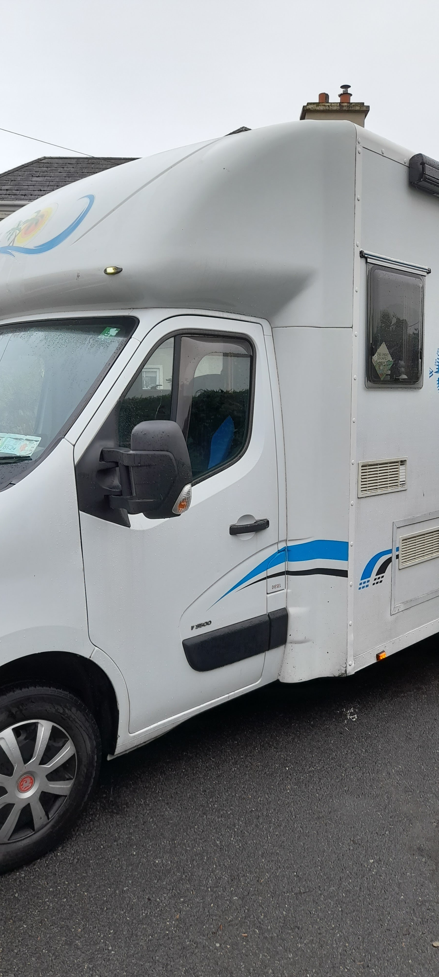

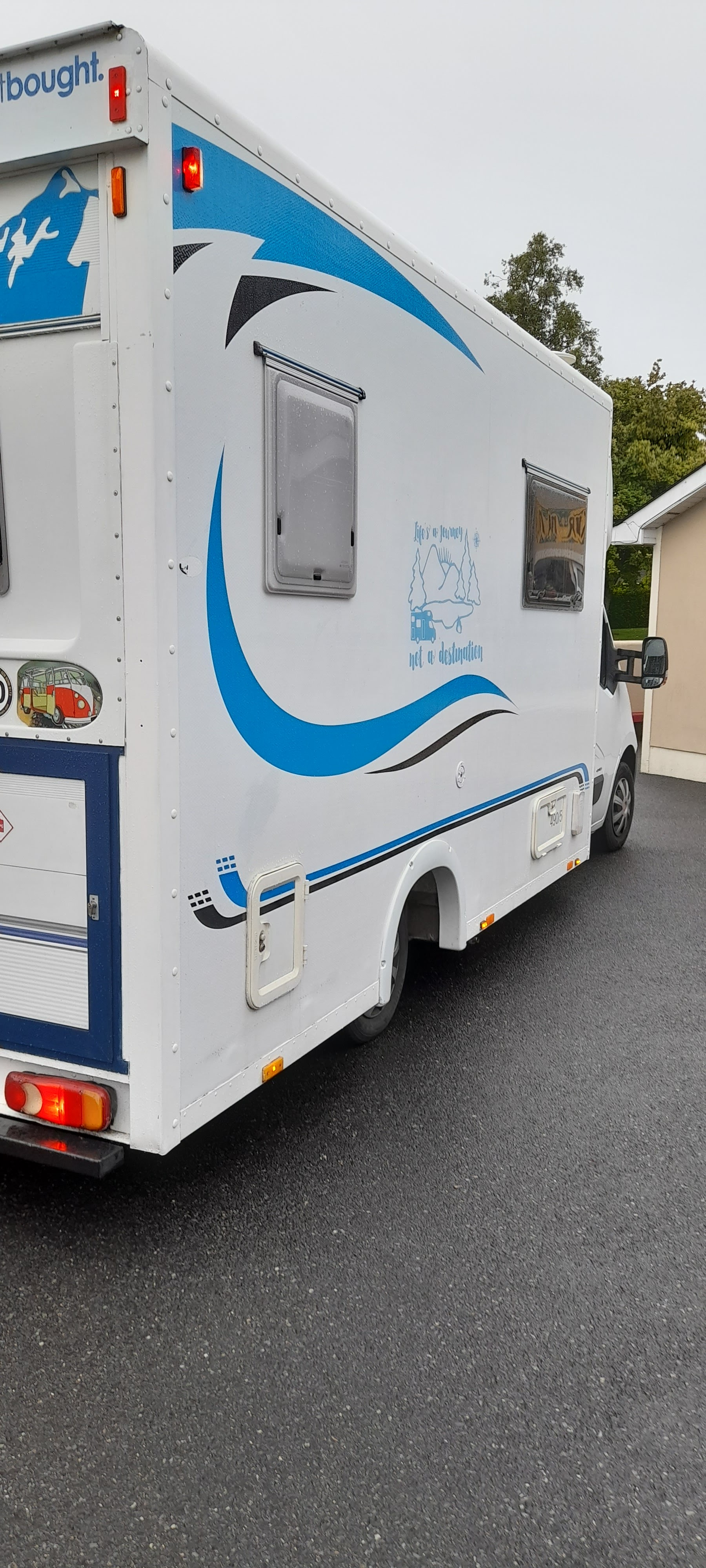

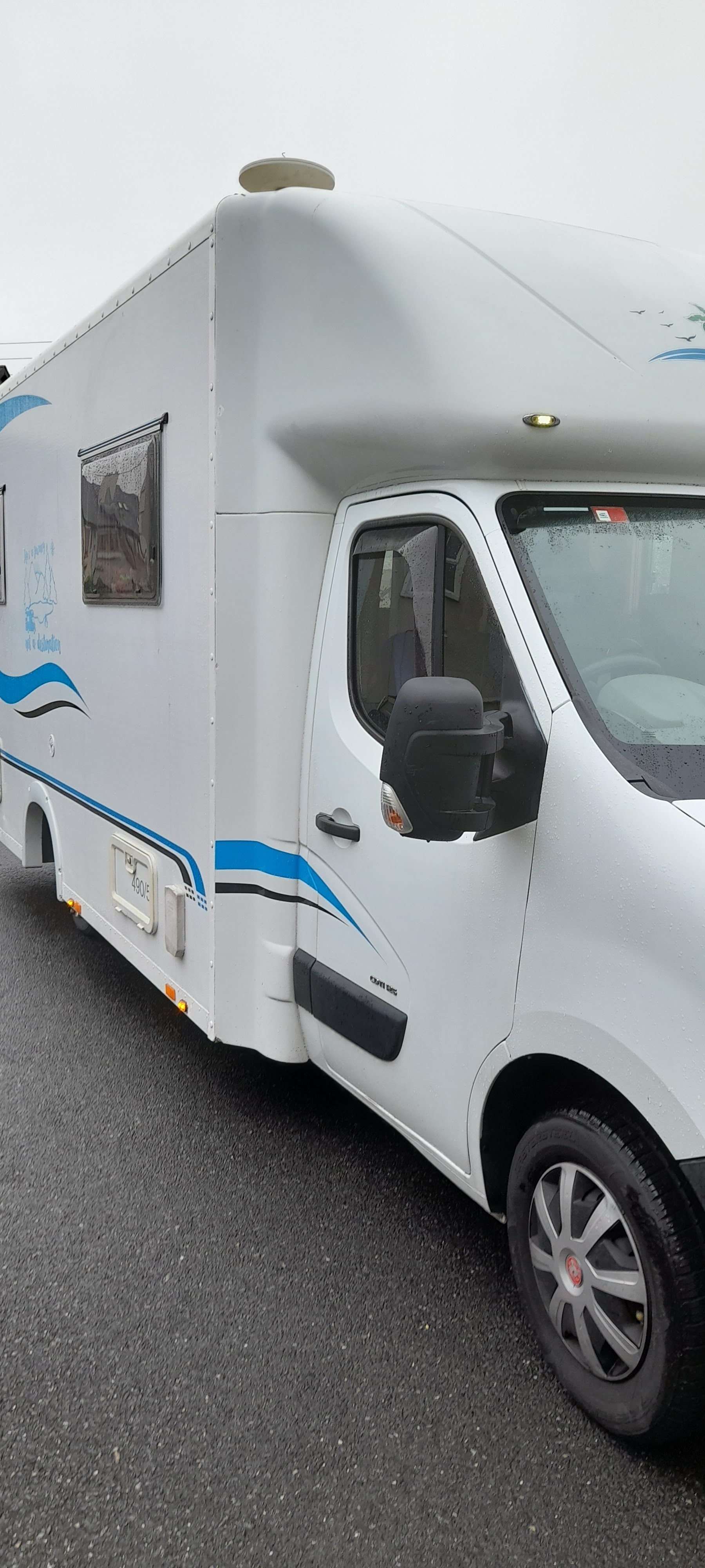

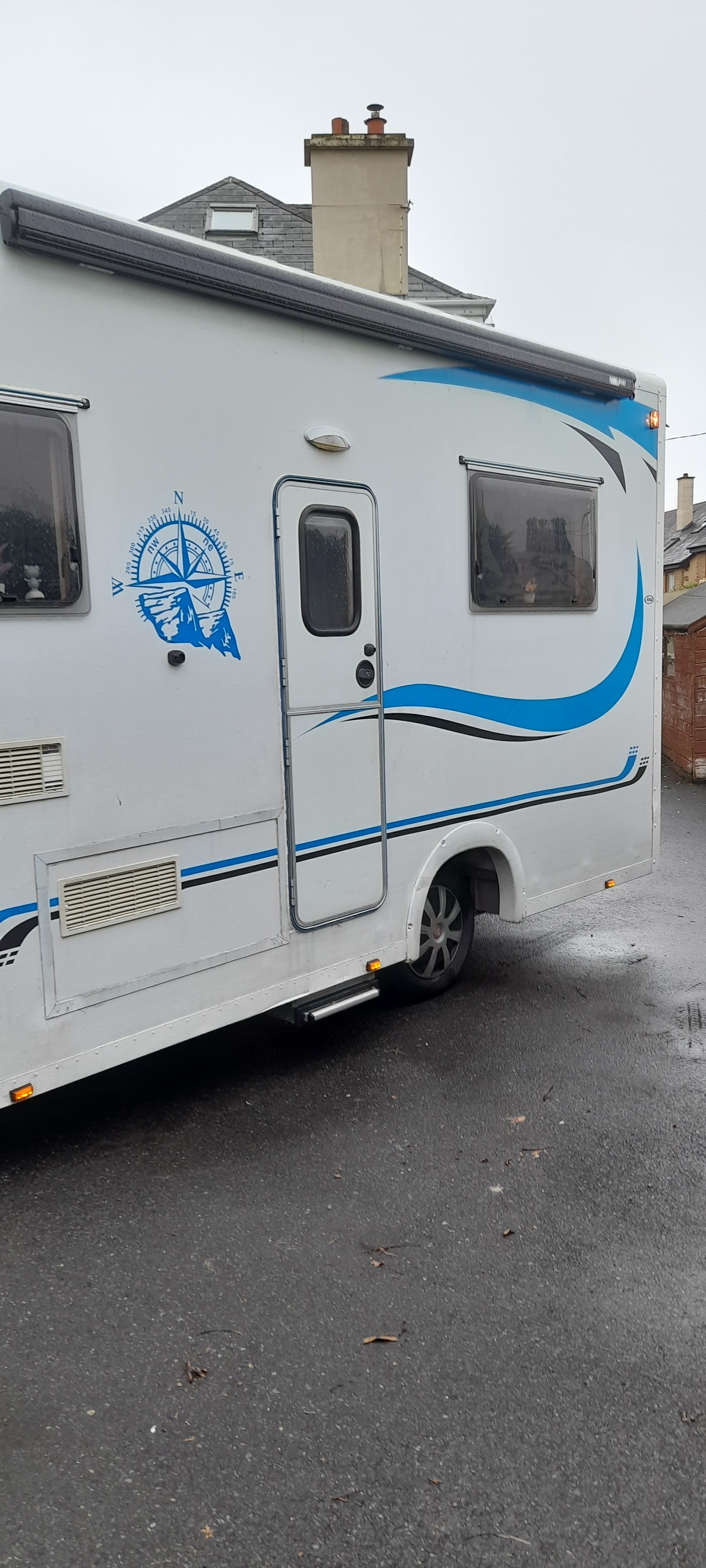

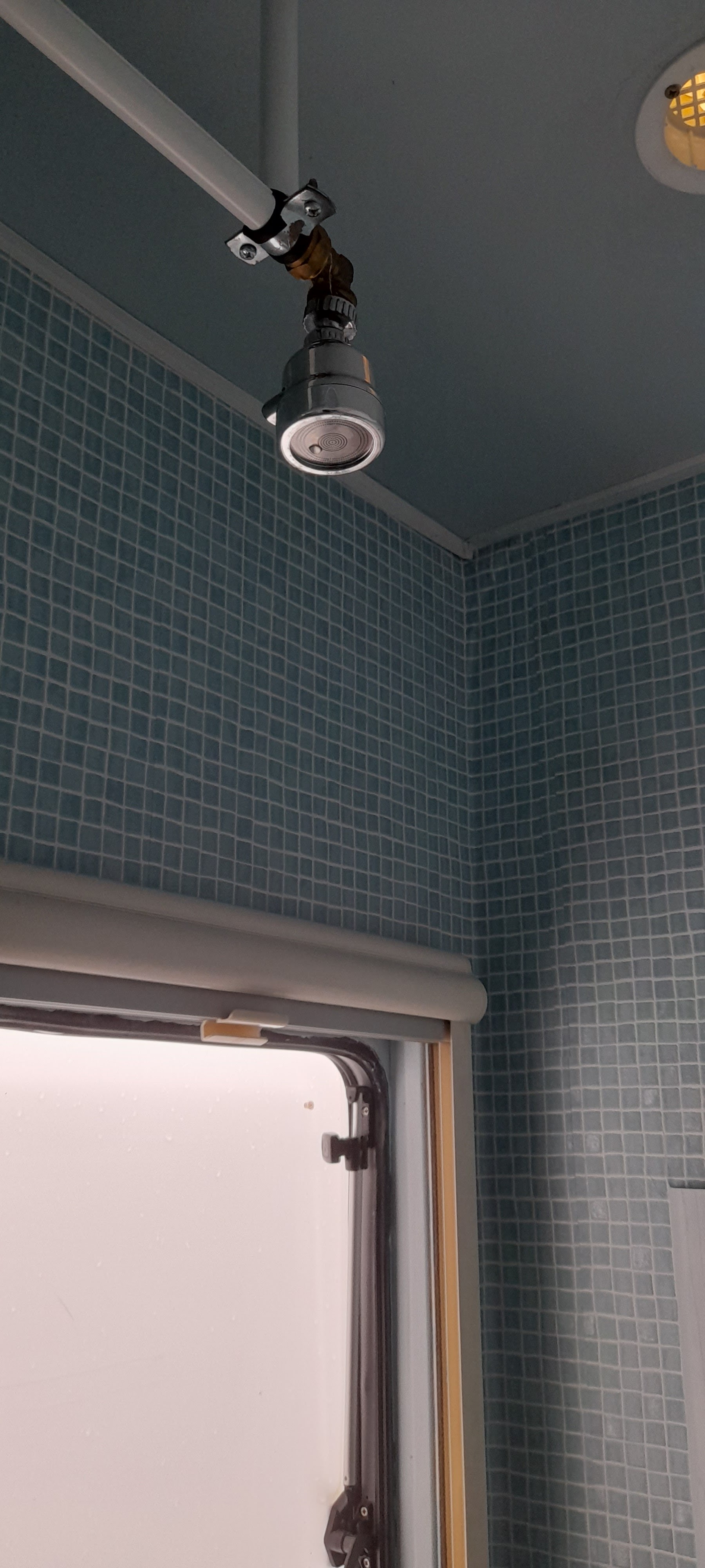

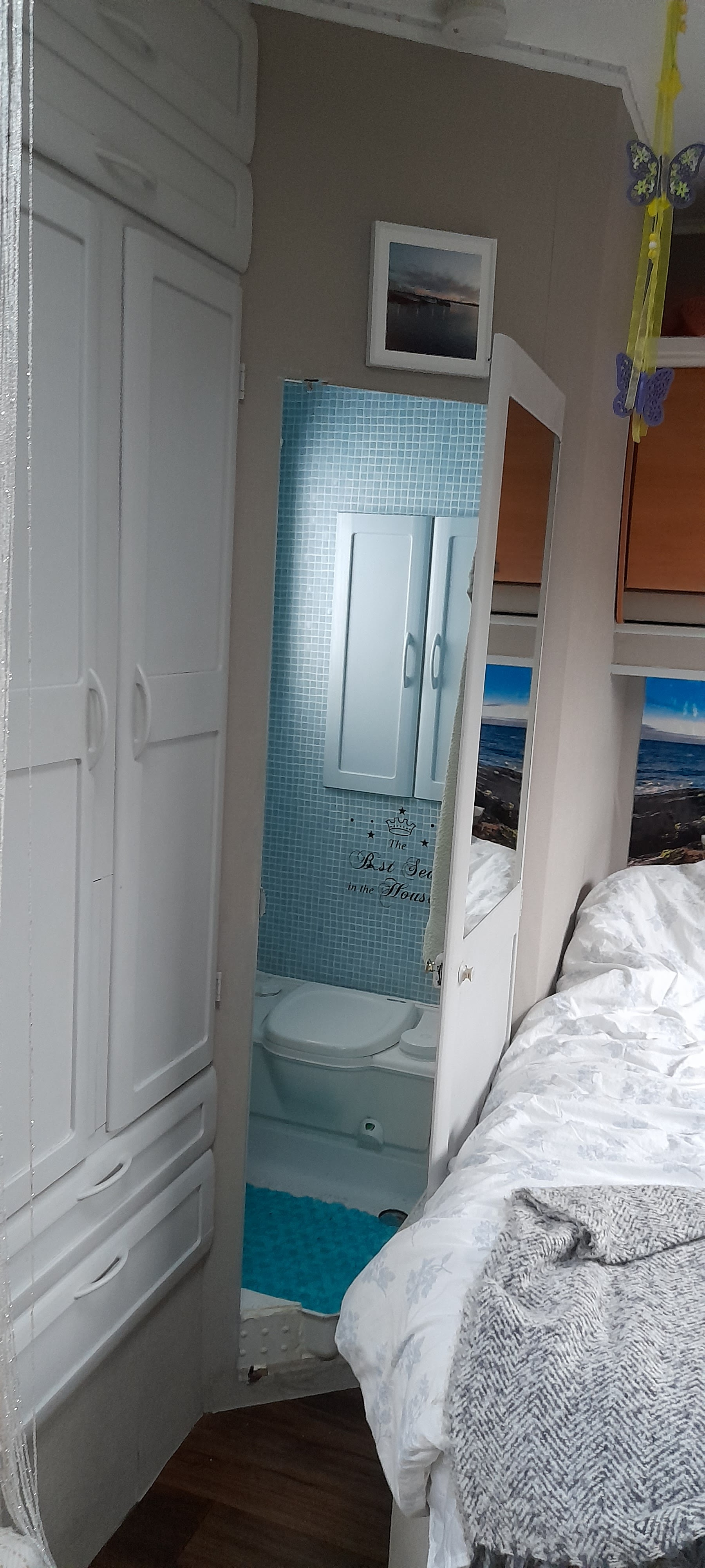

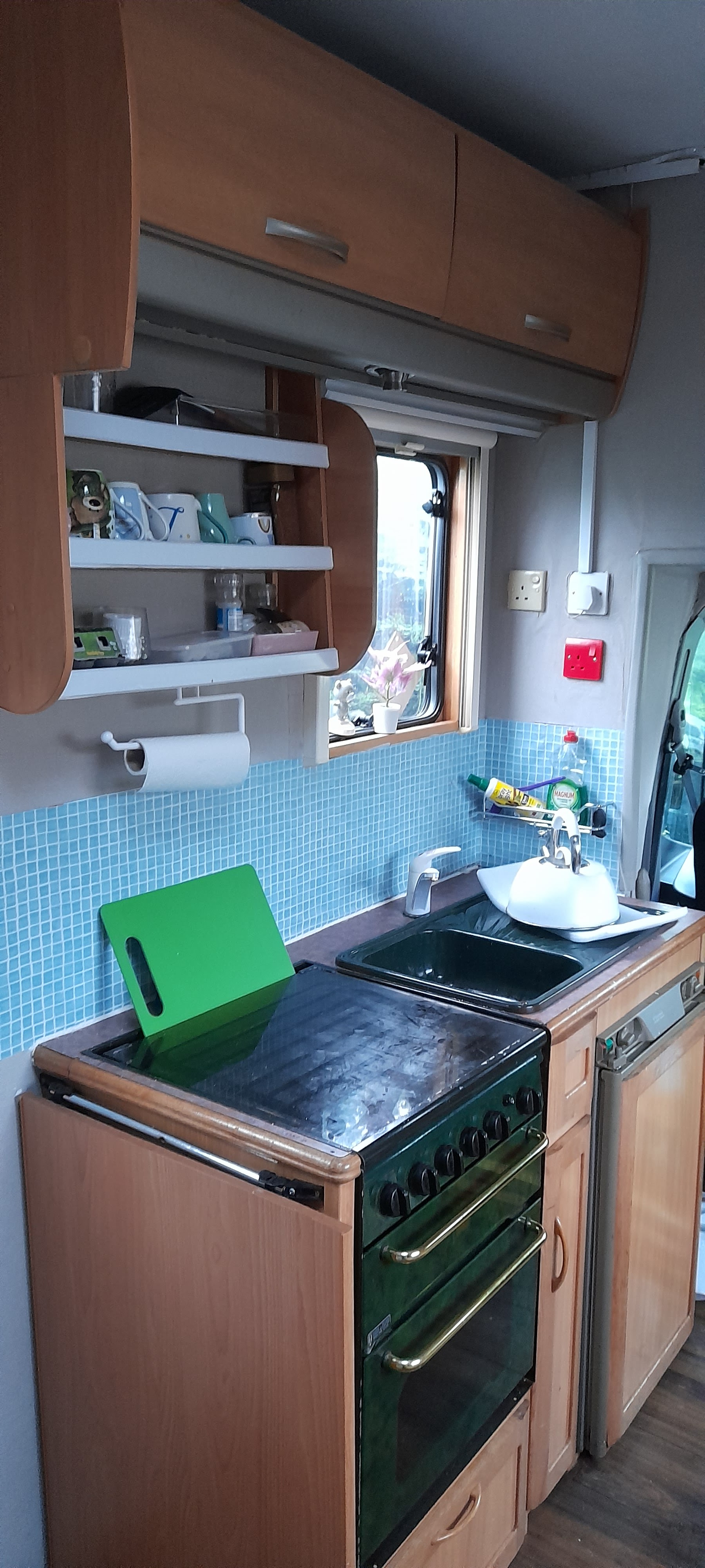

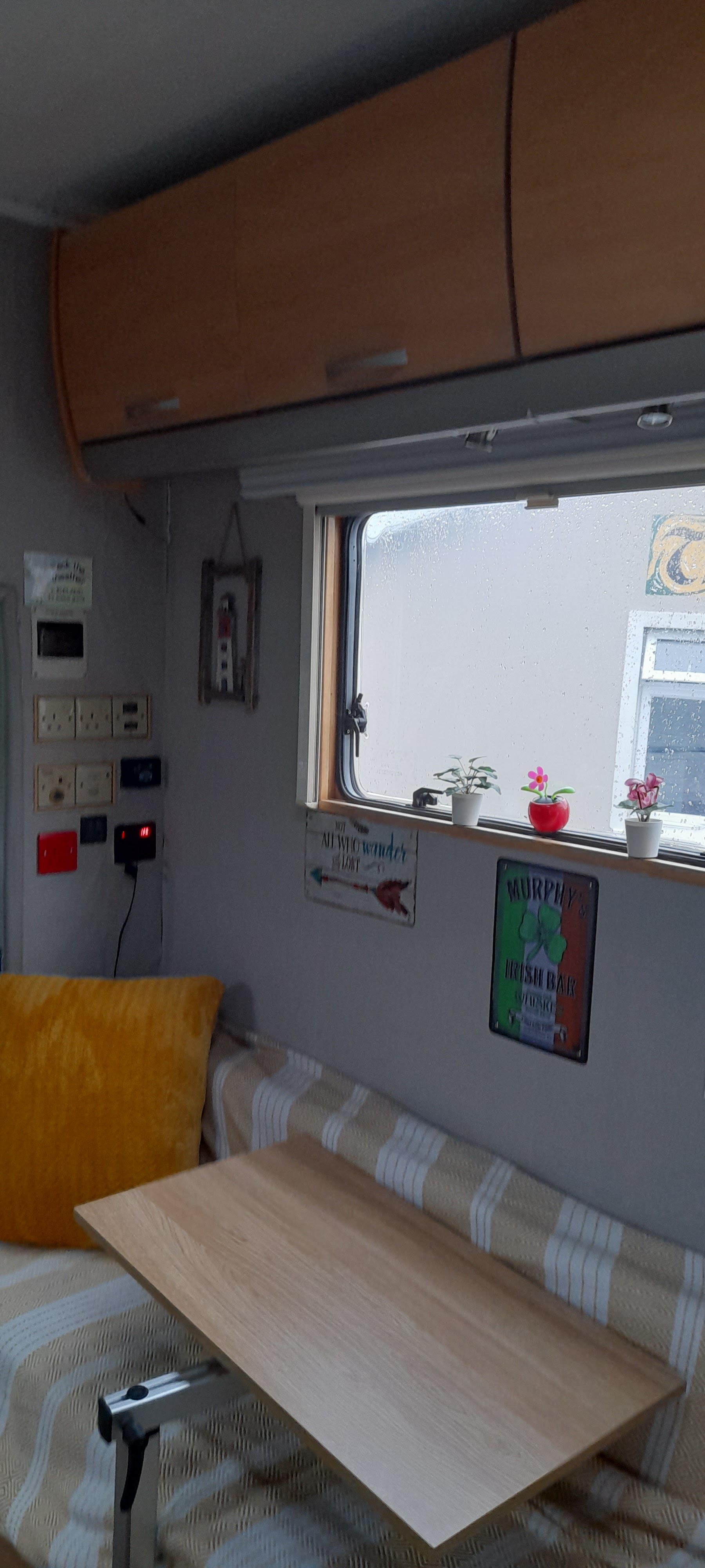

I have done a conversion with a walk through on a Movano low loader, the only issue I have with it is that it is too high!!! at 3.2m. See attached pics,

No movement on my van. I just removed the van bulkhead and cut out the fiberglass from the body. The body is securly fixed to the cab at both sides, no need for a seal as it is completely enclosed.

Im sorry, but I don't have any pictures of the van before the conversion.
What I can tell you is that is was a standard low loader luton box van bolted to a standard chassis.
The overcab and corner transittion pieces were there from when the luton box was originally bolted to the chassis, if you look at low loader vans online you will see that this is a standard fit.
The reason it is so tall, 3.2m from ground to rooflin is because whoever built it speced it at this height.
The only thing I would change if I was to do another build, would be to buy a luton low loader with a lower roofline.
That said, when you are in the van or driving it, you do not notice and I would rather have the head height, than be bent over in a VW.
