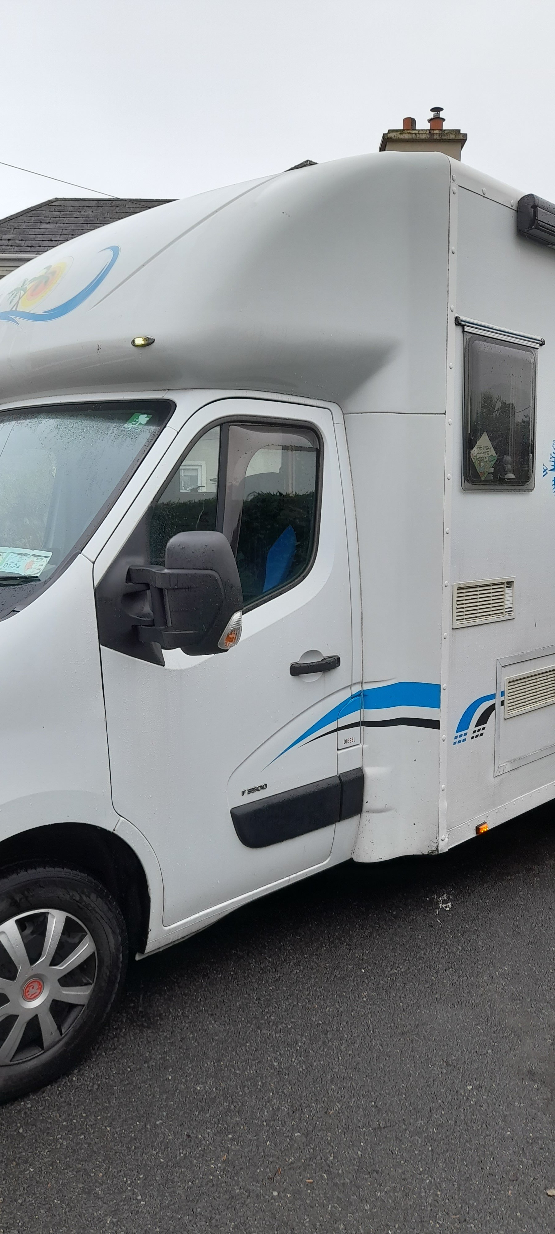

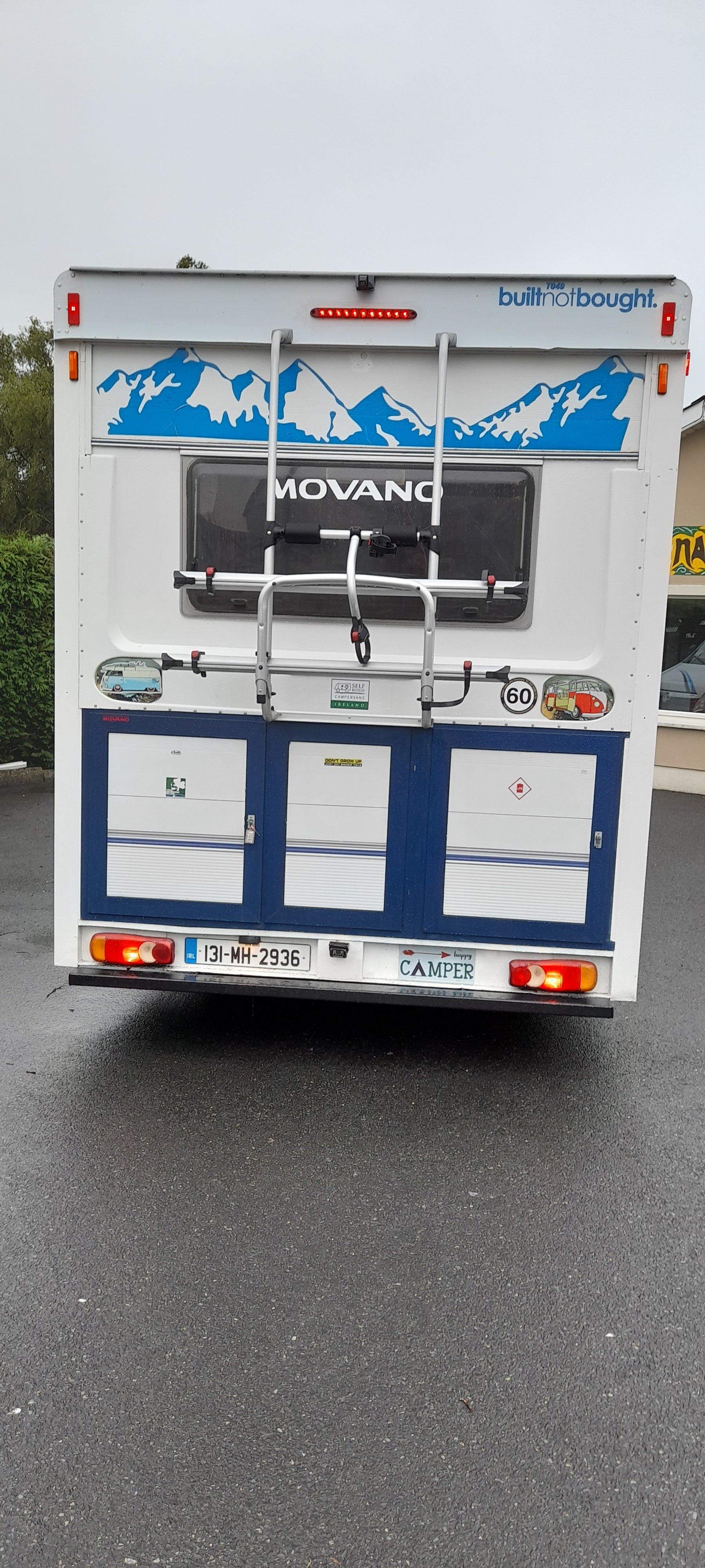

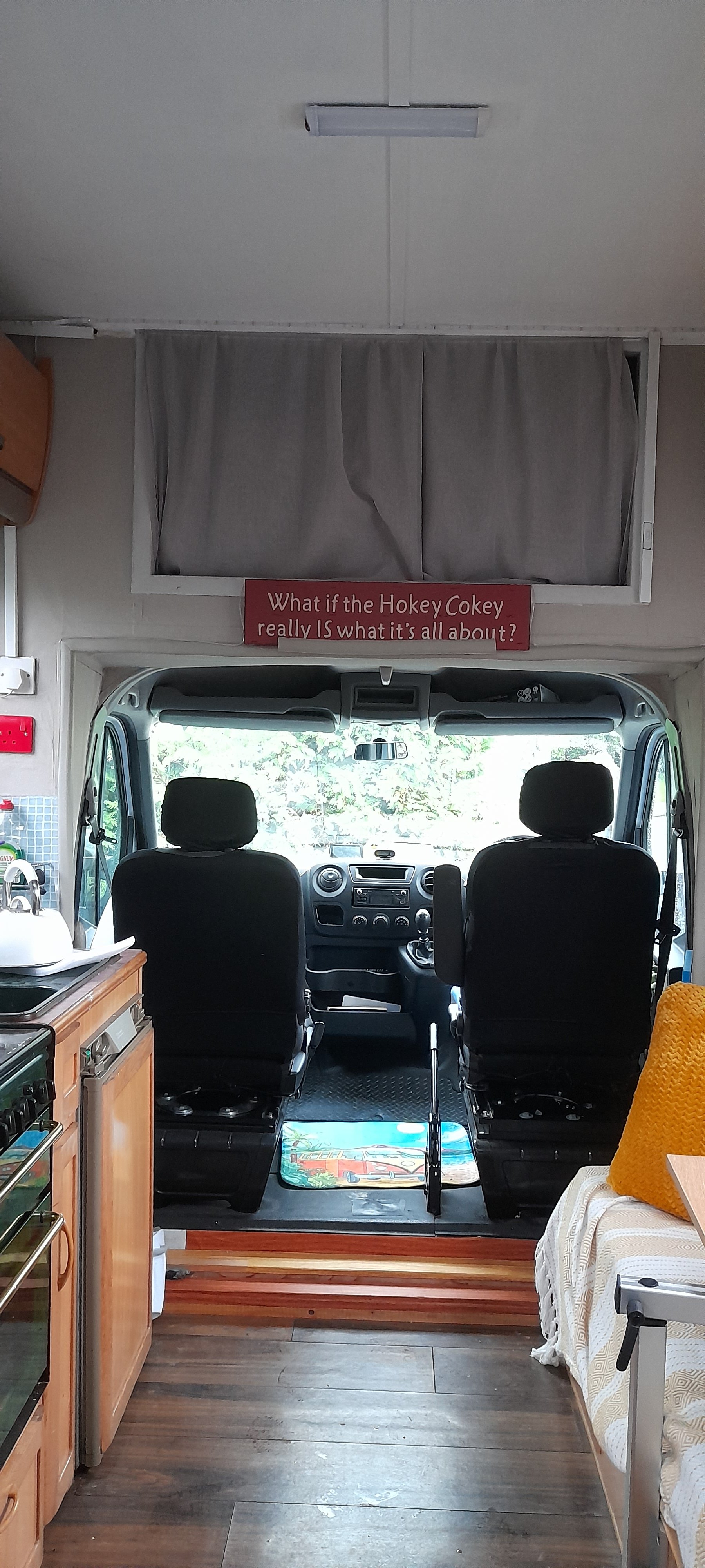

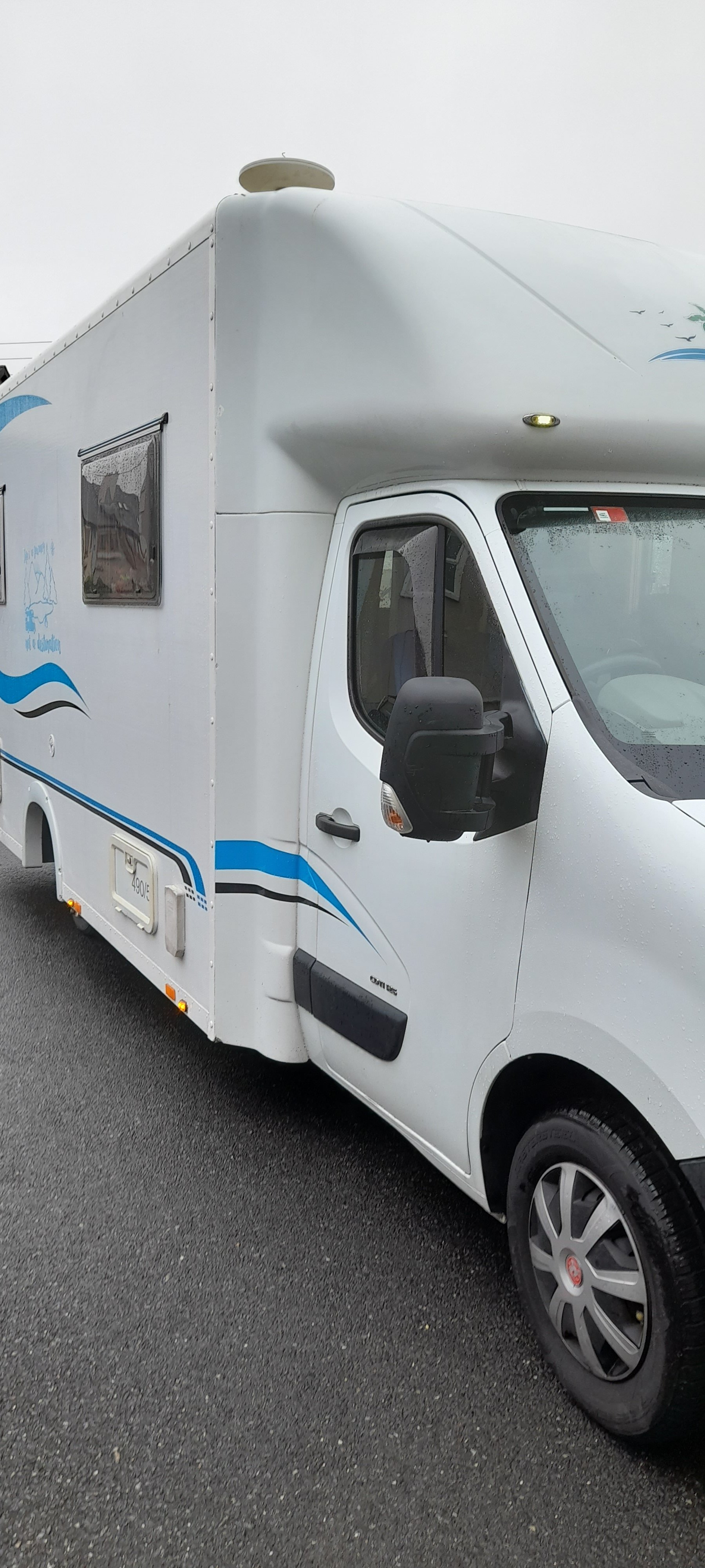

I have converted a Vauxhall Movano Low Loader, see some pictures attached.
I have attached a 3.5m fiamma f45 awning, a Bike rack, a slide out electric step, 200w of solar panels,swivel captains chairs and rear air suspension

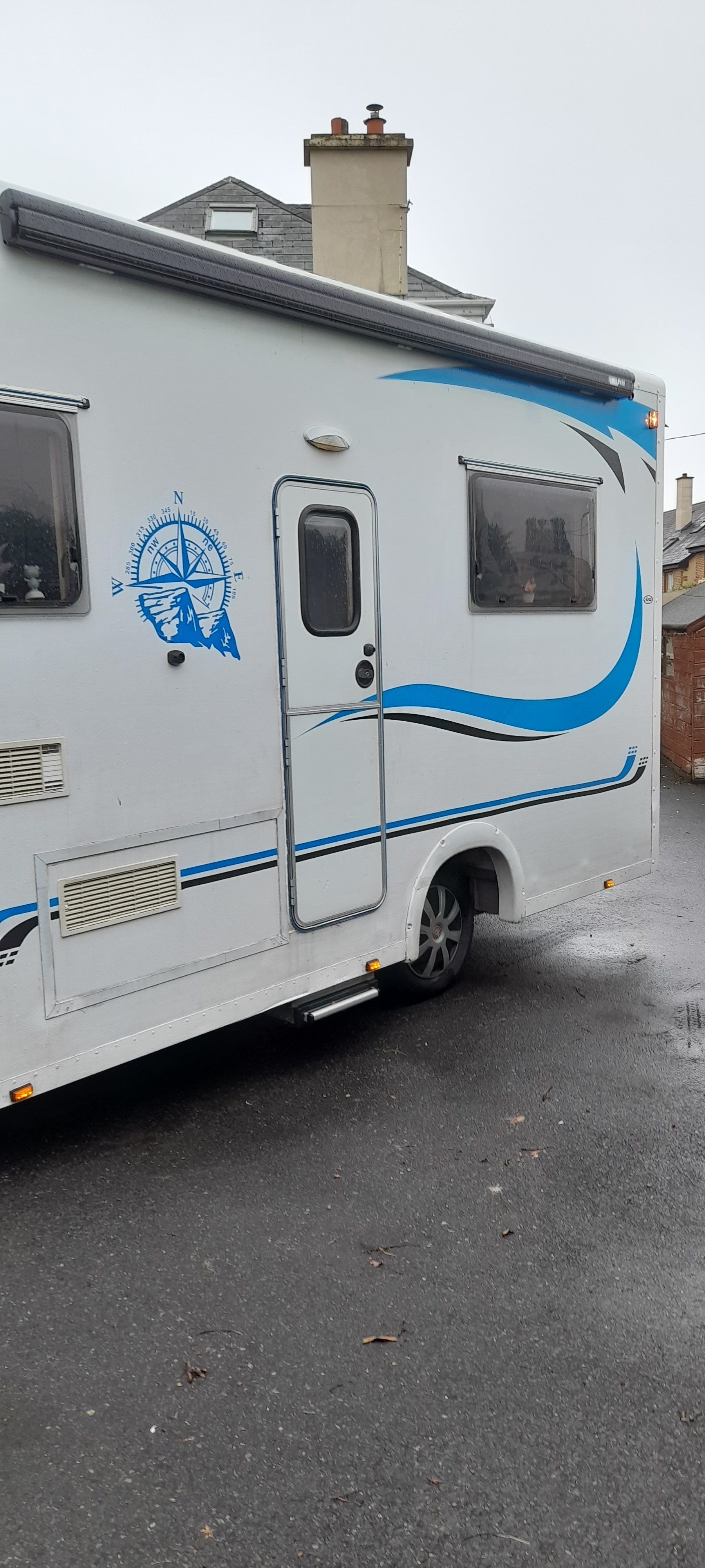

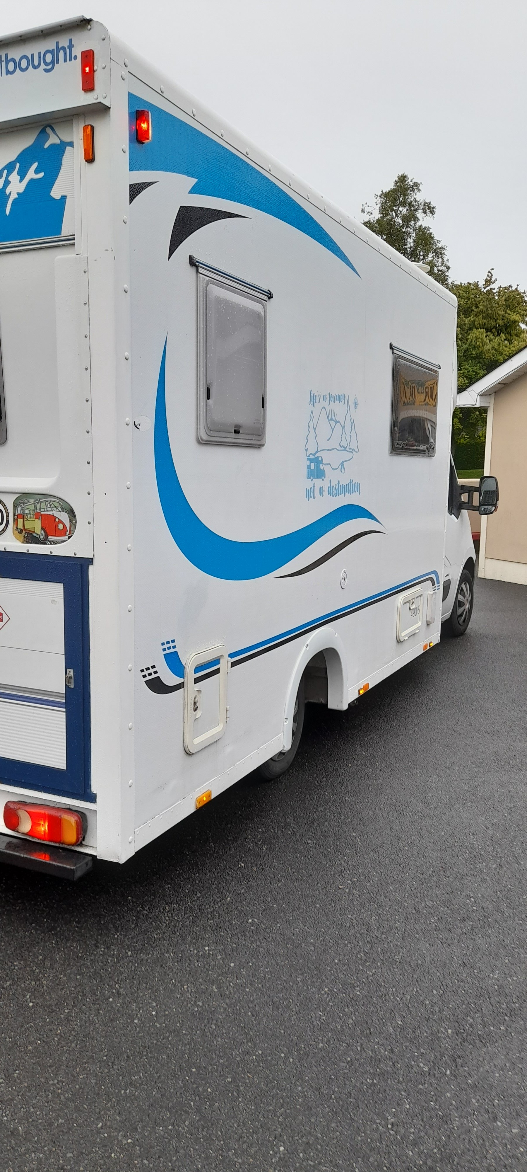

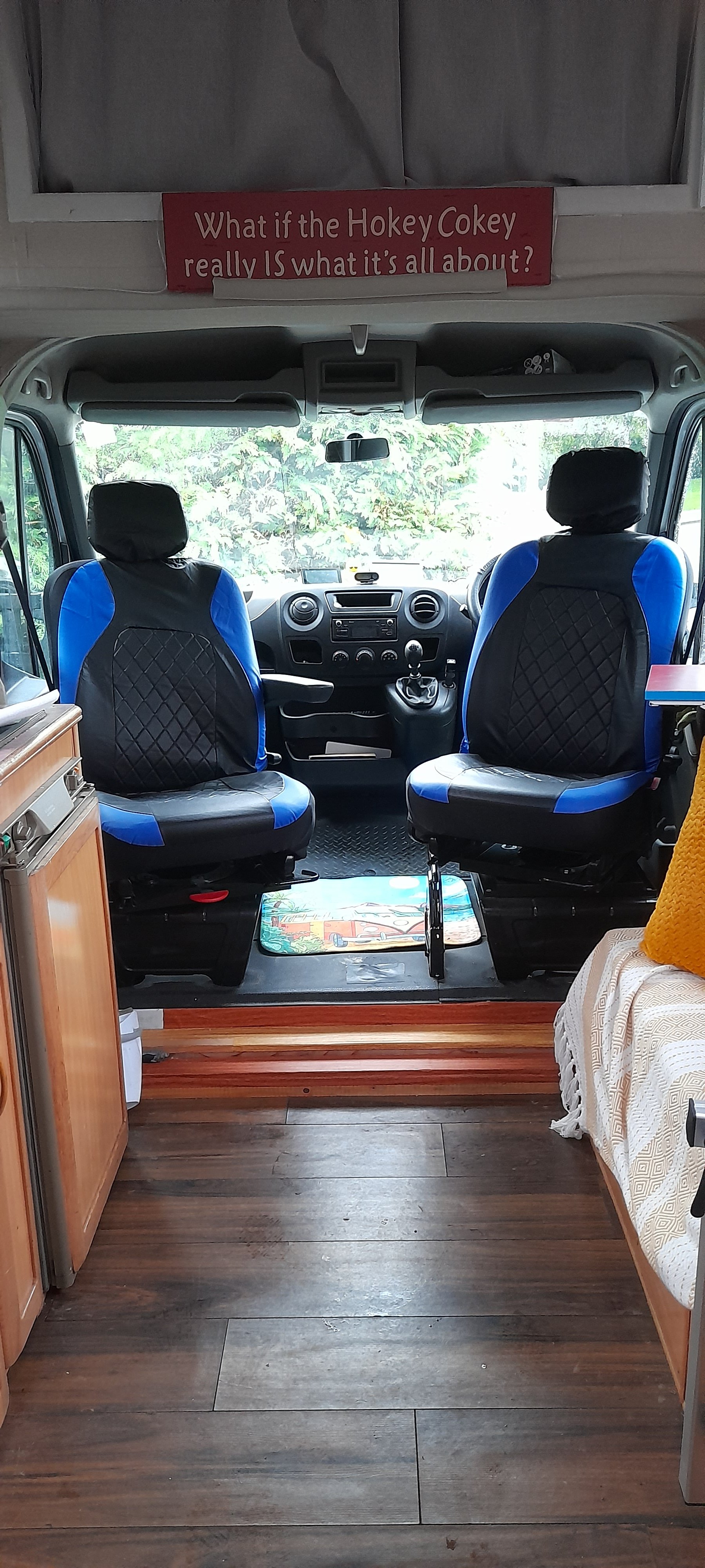

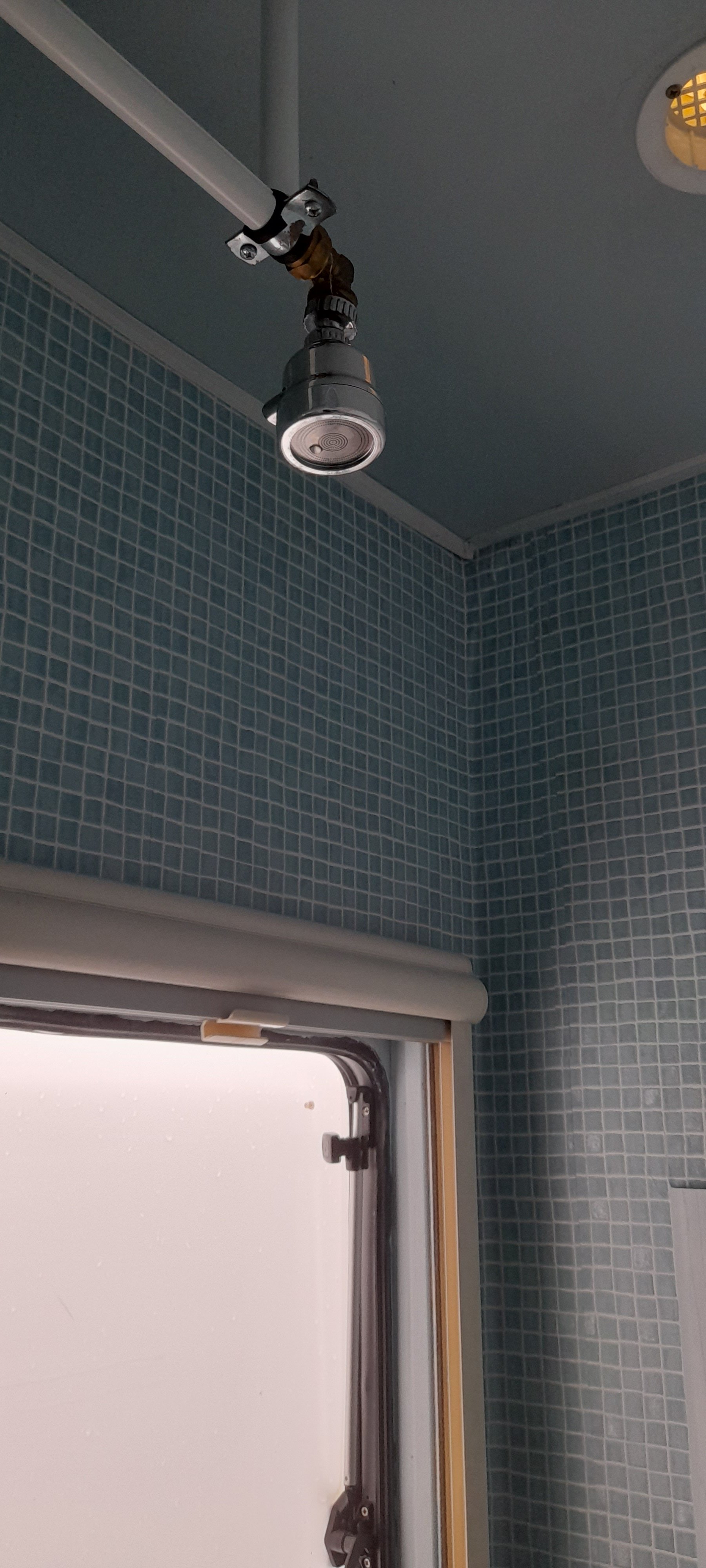

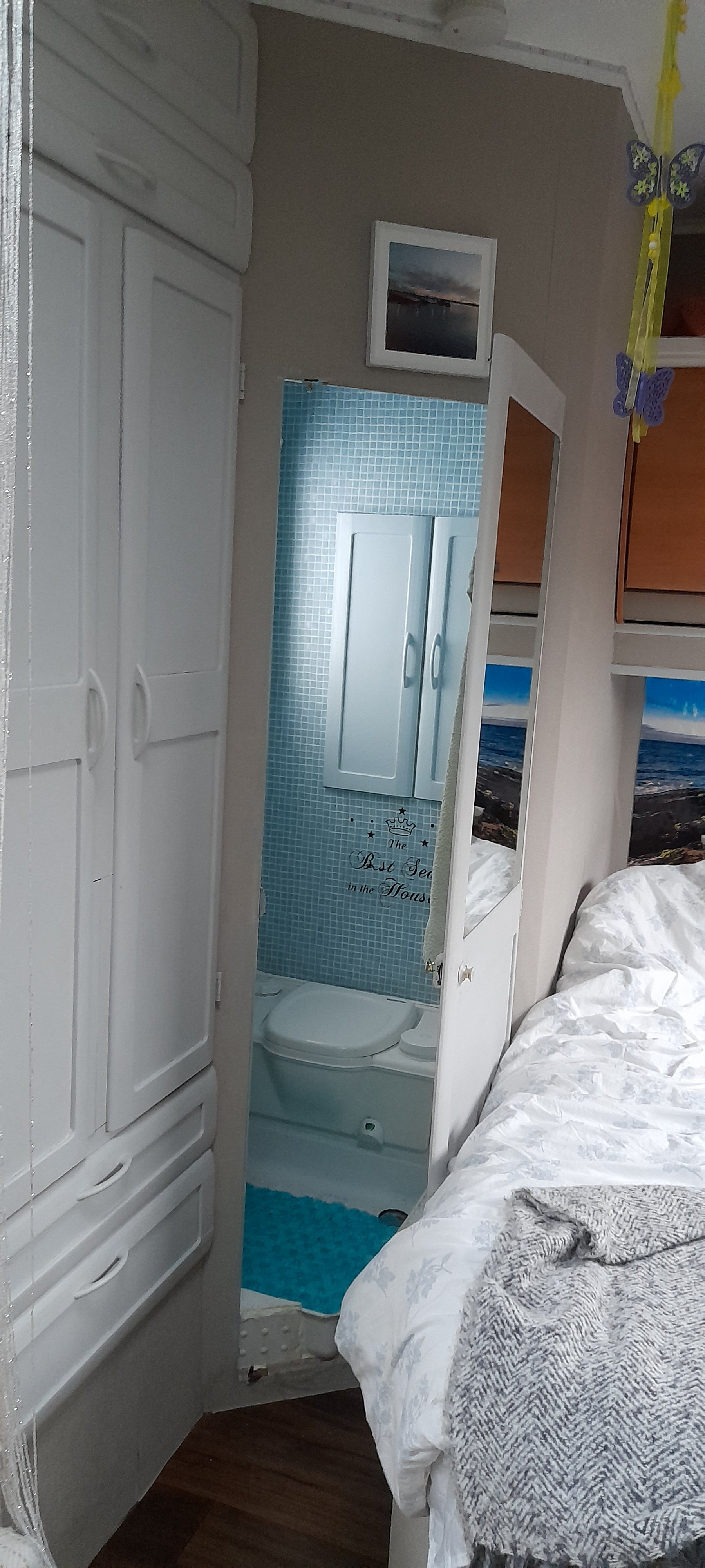

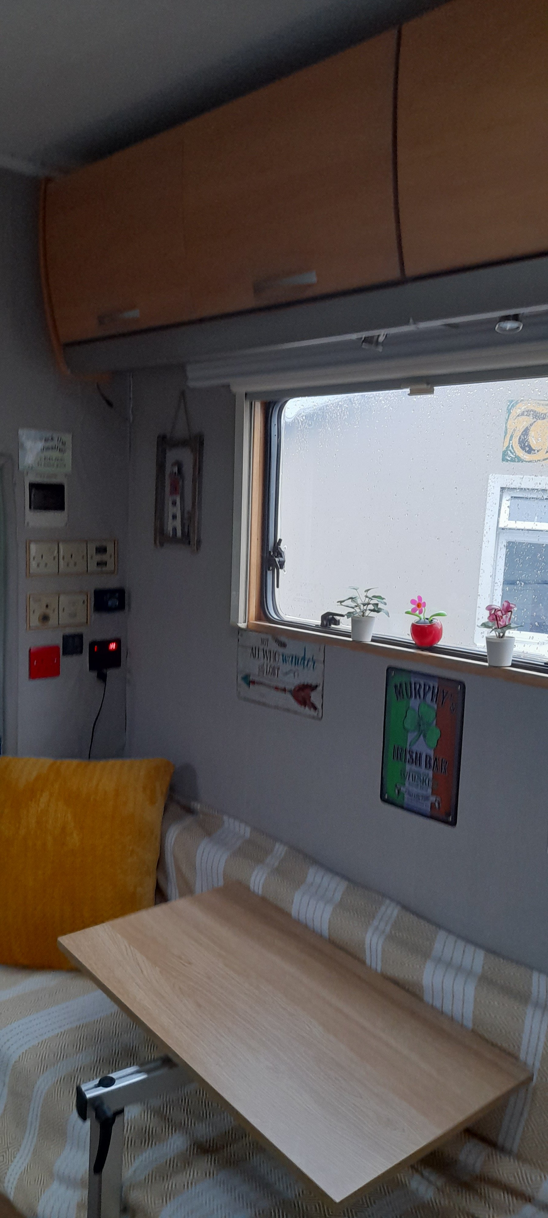

See attached pics of a conversion I did over Covid....still doing work on it, so have made a few additions not shown in these pics.
