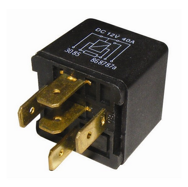

Dipped beam relay is in the fuse board behind the dashboard (Body Control Module) T01
Main beam relay is in the engine fuse box (CVM) T02
If its a relay there not too expensive, about £5 tops, after fuses I think its the problem, normally a click can be heard when the stock at wheel is flipped, relays are norm in a cluster near or in a fuse box under the dash or hood.
