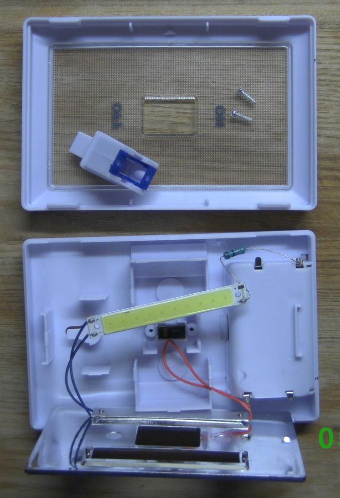

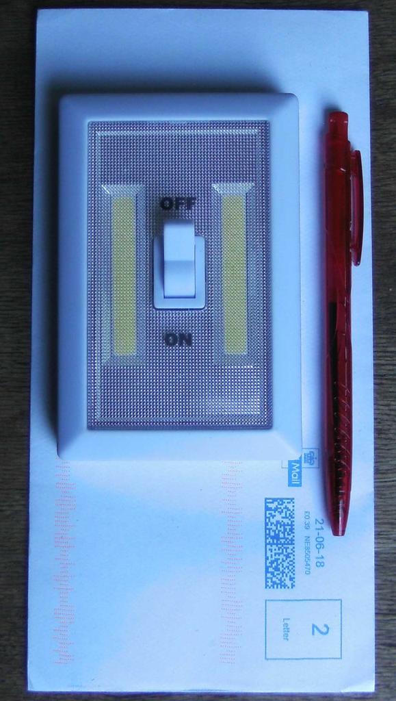

Saw these in Poundland at 2 pounds each and thought worth trying as they have 2 COB LED arrays. Not the most elegant things but tucked under a wall unit or shelf not much of them might be seen. Subjectively two units are bright enough (for me) to illuminate a worktop in a van. Light colour is acceptable, not overly cold blue. Maybe a handy replacement for a dead 12 V. fluorescent strip light.
There is not much inside and they could easily be reworked to fit into a better looking enclosure, without the switch if preferred.
The case is opened by pressing on the long sides to release the moulded hooks visible in the photo, 2 on each side.
The two screws from the back of the case only hold the switch parts together in place so need not be disturbed.
They run on 3 AAA cells (rechargeable would be OK) but could easily be hacked to run from the van's leisure battery with an inexpensive DC-DC Buck converter like this:
DC-DC Step Down Converter 5-36V to 1.25-32V 5A Buck Voltage Regulator NEW GA | eBay
A cheap Chinese module but supplied from a UK address, 4.10 pounds delivered. This one has a volt meter built in for convenience. Output is 5 amps max so if the output was set at 4.5V then the unit could supply up to 9 of the light units.
There are many similar on ebay the cheapest direct from China if you can wait a few weeks.
Available without the voltmeter and less output current for less money.
If that sounds too difficult, 4 could be connected in series directly to the 12 V system in the van if that many on simultaneously suited your requirements.
I will be trying them in my van conversion but not yet progressed that far.
