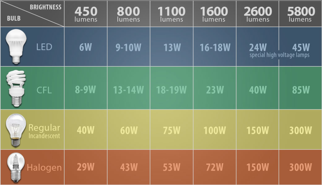

They cannot be 30w or they would be the size of your fist,light is measured in lumens ,watts is the electric used,they will be between 2 & 3 w,see chart,you will be getting about 200 lumens of light.
Lots on ebat soft or pure white,soft is nice and calm.

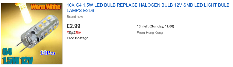

Isn't 30 watt the equivalent brightness of an incandescent bulb measured against the LED 3 watt bulb?
No, 30W is the power used by an incandescent bulb delivering similar brightness (measured in lumens).
No and yes as thats what old folk think but not correct,watts is the amount of energy used ,light is mes by lumens or in olden days candle power,but i get what you are saying as my gran used to ask in shops as we all did for wattage as more used more brighter,but in fact incorrect but they new little in those olden days,us more ejitmakated use lumens.

Your right about lumens, but people refer to wattage in terms of brightness used by old style lighting when replacing with led,read fringedwellers add from screwfix to see.
Some makers do so as you say but many just have correctly lumens on packages something which we should get used to.:juggle:
