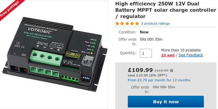

Solar all year round ex maybe nov dec and maybe jan,and only few day here and there with numax charger built into van,do make sure the panels charge the starter battery also,either with a relay bypass switch or a proper solar regulater.
Most of the older style chargers in motorhomes are not ment to be on 24/7 as they are not smart chargers which can be left on all year round,just remember you van alt charges at 14.4 when you drive but regulates its output and batterys dont get damaged.
The right up in early post is in regards to the old school chargers,so if you have one dont leave on for more than a few hrs a week,do remember the starter batt as these in many cases dont charge it.
