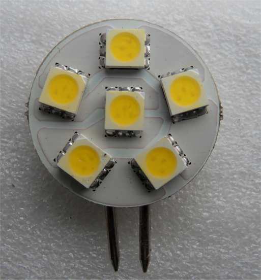

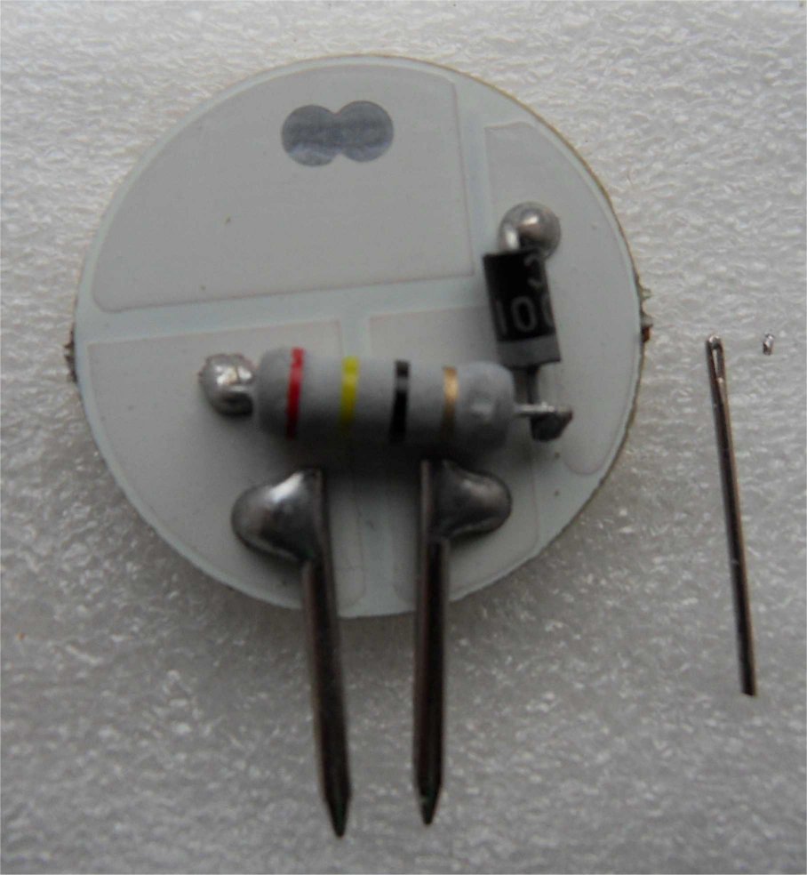

These are the bulbs I got, the one showing the back also shows a needle I am going to try to solder in place of the pins. The needle (0.76mm) is just slightly bigger than the pins (0.70mm) of the normal halogen bulb & will fit in the holder. These bulbs do seem to spread the light reasonably well, I think it will always be difficult to get them as good as the ordinary bulb as you can't make use of the reflector behind the bulb with the LED ones.:rolleyes:

Ebay Iten number is 220493681938 type this in ebay and see what you think, BTW the lights are still on in thr garage, 3 days now continuous. Cant fault them really.

Managed to solder some smaller wire to the the LED bulbs I have & they work ok. Both the lights I put them in had the polarity the wrong way but there was a screw block type connector that was easy enough to get to. They aren't quite as bright as the halogen but not by much. I sent for a couple of the 9 LED 90 lumen ones @ £4 each, these should be ok as they are half as bright again.
Update
Received the replacement bulbs the dealer from Hong Kong promised to send with the smaller pin size so now had 4 bulbs for the price of 2. Found the original bulbs must be the white as the new ones he sent were warm white. We will fit the white ones over the kitchen (I managed to solder some smaller pins on but don't know if they will last) & the warm white ones in the living area. Still waiting for the brighter 90 lumen ones to come, date for delivery I was given was 25/12 to 5/1 so hope they come for next week.
