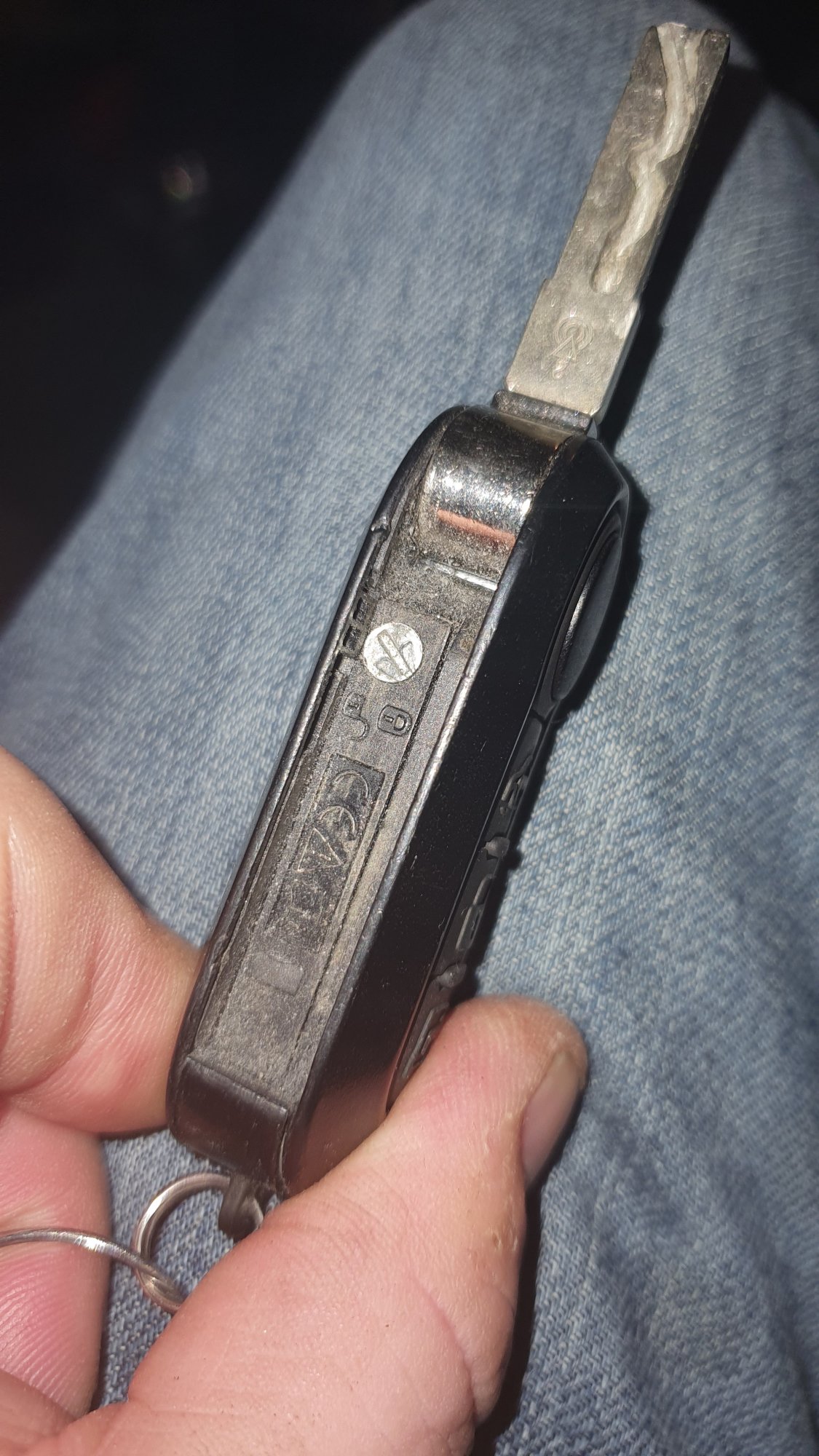

So, I removed the battery and zipped out to get a replacement. Problem is, nobody seems to have the battery I want - a CR2016. I can get a CR032 which is slightly thicker, but I may be able to get it to work by loosely holding the fob together as I press the button, problem is I don't know if this may cause any damage?
I only have one key for the van so I don't want to risk wrecking it. I can get a CR2016 online easily enough, but I want to try and make sure this is actually the problem as the meet is next weekend.

question - what van have you and how easy to get to fob battery? (I think I need a new one myself but not checked how to disassemble key to access)

My van is a 2012 Renault Master 2.3 DCI.
It was really easy on this fob. One small screw (which also holds the blade in place in case that ever needs to be removed. Then a flat screwdriver head to prise the case apart.
There will probably be a Youtube vid somewhere for your model - I found one for mine after a little searching.

I have a Ducato so will be different, but appreciate your time answering. I am sure others with a Master will find it directly useful.

IF its a recent ducato.... Flip the key blade out and there's a little hatch secured with a small straight head...
It's behind that.
