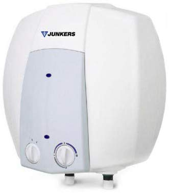

Still on my water heating crusade. I read a (old) thread where Junkers were mentioned as good heaters. I stumbled on this 10L Junkers Bosch water heater on amazon that comes from Spain. I can't find it anywhere else, but seems like a really good price, less than half the price of the Propex one I was considering before. Might be of use to those looking for a decent water heater. £81.94 delivered.

That Redring one looks good, but it's rated a C where the Junkers is either a B or A depending on whatever the below in Spanish means. My inverter is 2kw so the ariston is out for me, I'd imagine this is the case for many being right on the edge like that.
I'll keep the redring in mind if I feel 10L is too much, this is very much a try and see experiment like your own :) I've been trying to run numbers on energy efficiency heating 6L up to 60oc vs heating 10L up to 45oc, so you use the smaller one with hotter water but mix it with cold to give you 10L of warm water, or just heat the 10L up to desired temp and don't mix it. I can't see that one way is really better than the other.
I think in the end 6L would probably be better since it's just me and my dog, but only one way to find out!
Heating 6L of water from 10oc to 60oc with 1.5kw only takes 16mins, compared to 28mins for 10L. That does seem like quite a difference.

I had push fit pipe and you use inserts on every end. Can’t recall if you can mount horizontal, I think not. You can’t actually buy that water heater from amazon now anyway, screwfix sell a 1500w 6L water heater by redring which I’d recommend, it’s the one I use now as I broke the Junkers one before I even got to use it and threw it in the bin (Human error)
How did you break it? I have already bought the junkers, I am in POrtugal so its called a Volcano same company went for Junkers as it German tech and quality
Ah very good. I’m in PT now too! I broke it because I’m an idiot that didn’t understand how to plumb and learnt the hard way, I ended up destroying the connector as I didn’t realise there’s not push fit connectors to connect it up, only compression, anger ensued and its fate was sealed.
