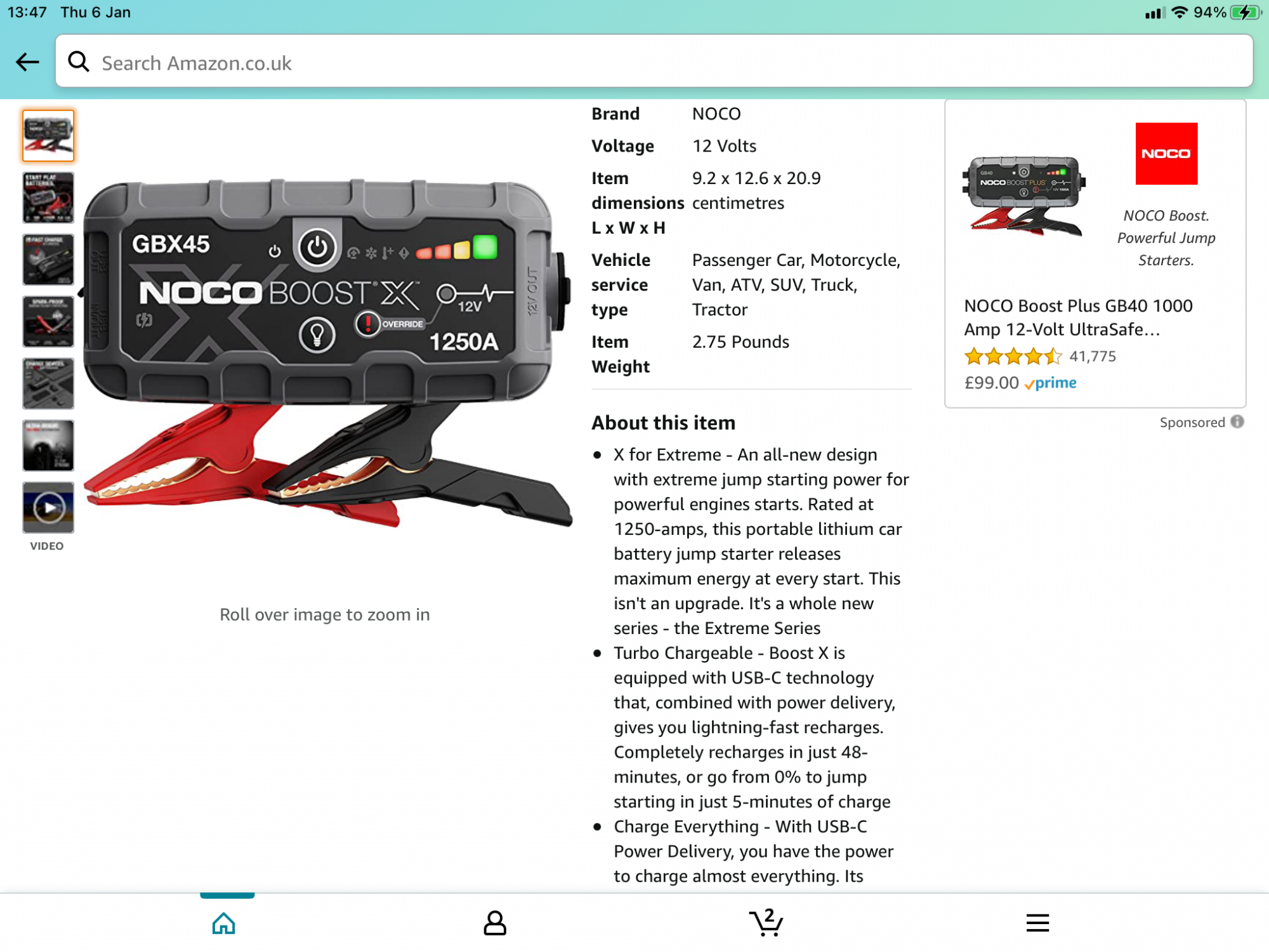

Looking for something that will start my van 2.8 litre diesel and a 1.4 petrol engine looking at one of these are they any good or is there something better looking at something under £150 if poss
Had one of these for 3 years and has started a number of cars and motorhomes.
Thankfully haven’t had to use it on my vehicles but use it every trip out to charge iPad, iPhone, ecigs etc.
More than what you want to pay but they do numerous others which should be suitable for your needs.

They will work with a totally flat battery -- there is an override switch for when there's insufficient battery voltage for the polarity protection feature. I have a GBX45 and it provided enough current to start my 2 litre diesel car when the battery open circuit voltage was down to 1.3V.

To be honest you won't go far wrong with the NOCO stuff (expensive BUT reliable hence why pros use it)

So new battery ordered and mobile fitter fitting it and a Noco starter power pack ordered to carry for when I leave radio or lights on and flatten the new one hopefully that’s my electrical problem on the car sorted. 👍👍
