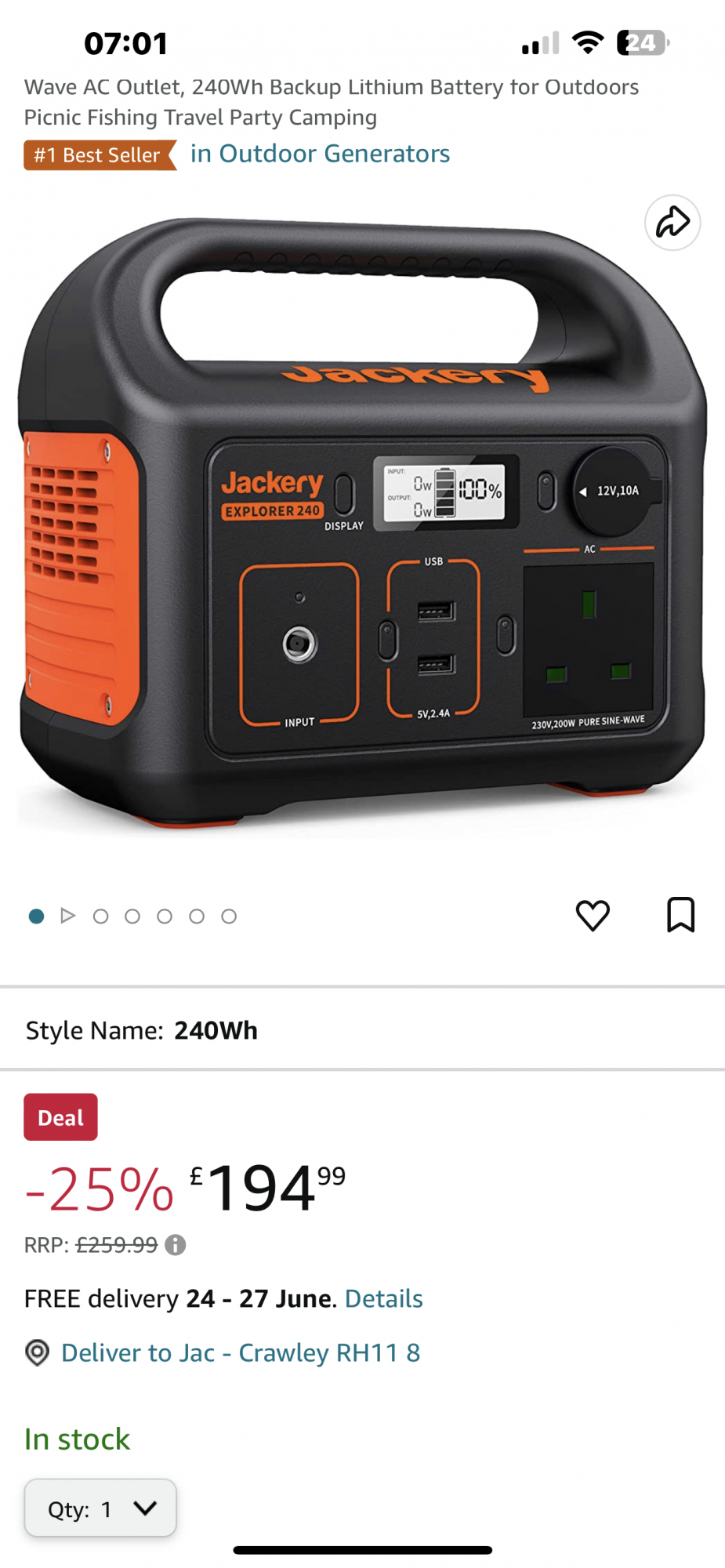

New price
Is anyone running a camping compressor fridge from the 12v output of the Jackery or does the compressor start up trip the DC protection? I have a cTechi power bank and the compressor occasionally, but not always, trips the DC protection. Runs ok on the AC output but obviously not as efficient and noisy. Just wondering if it's just because I have a cheap Chinese PB. Thanks.
