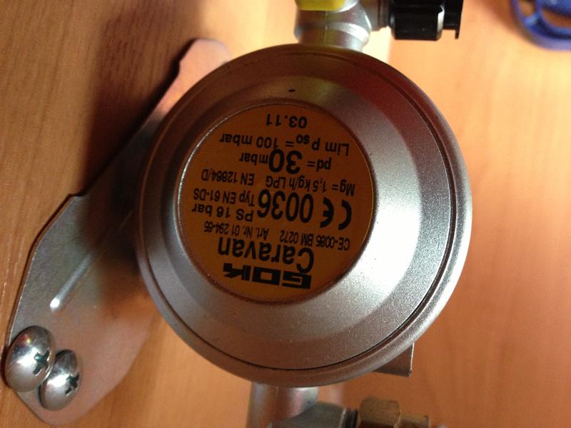

my gas is running like my bottles are empty, i have swapped over to my spare bottle it worked for a couple of minutes then the gas came through like my bottle was running out.
Is my regulator knackered? i have a gok caravan ce-0085 bm 272.
my motorhome is just 13 months old.
Is there a replacement that will last a little longer than a year?
Doesn't look good, unless there's a blockage in your pipes.
But first, what gas are you using?? Are you using butane (calor blue) these mornings as it's getting cold, butane doesn't gas off easily, colder still it stops altogether!!
So first step, what gas??
Hi thanks for the reply I'm on propane
Not the gas then, I'm assuming there is gas in the bottle!!
I'd remove a bottle and regulator along with a length of gas pipe.Connect up and put the open end of gas pipe into bucket of water, you should see a stream of bubbles that continues at a constant rate.
You should be able to put your finger on the open end and "open and shut" the pipe. If not then it looks like a new regulator. Is your bulk head mounted or free standing>>
NOTE WELL, obviously do this test in the open, well away from sources of ignition etc remember that propane is heavier than air, so not near sewers, manholes etc
Cheers for your help, the regulator is blocked so I've just had to replace it, £48.29 lighter :-(
