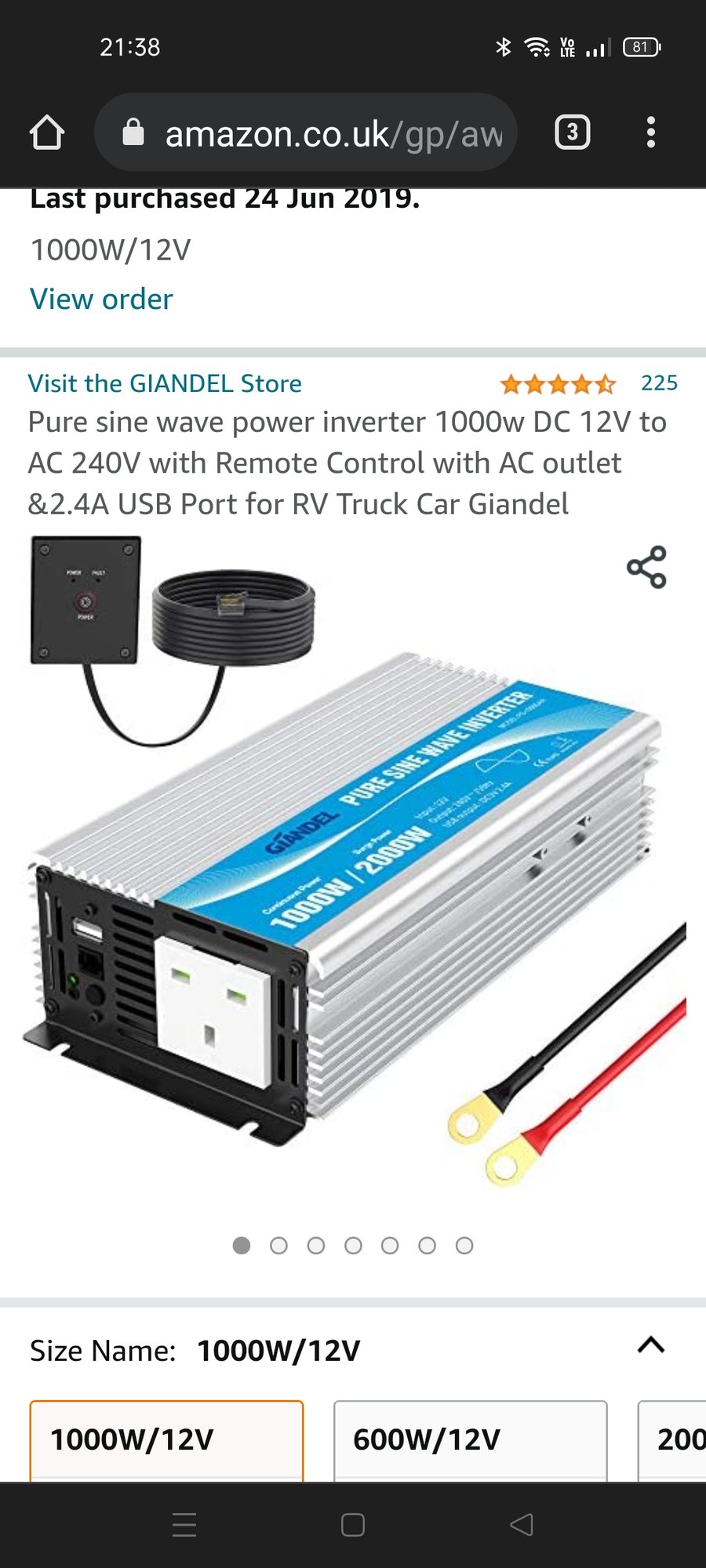

The only use of my inverter is to run the bosses hair straighteners first thing in the morning. It's better to have Happy than Grumpy about, don't see any of the other dwarves about mind :unsure:
How many watts or amps does the head tool burn, always double the inverter size as many are only good for short runs at continuous power
We installed a calorifier in my daughters sprinter van (piped from heater matrix) and it’s been great.
Straighteners 150w
Inverter 1000w
2000w peak
This soft star smart inverter would be better if you can pick one up.
