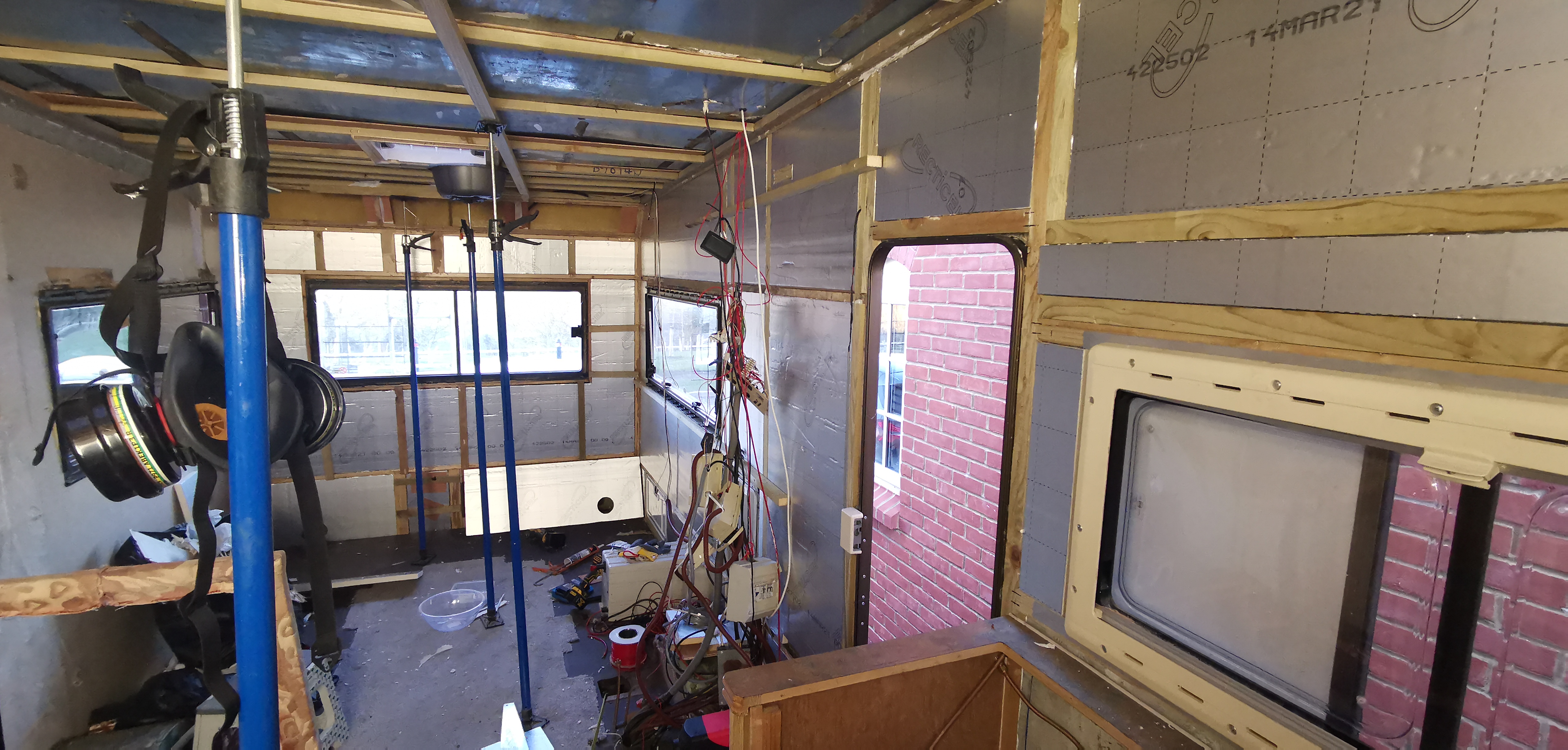

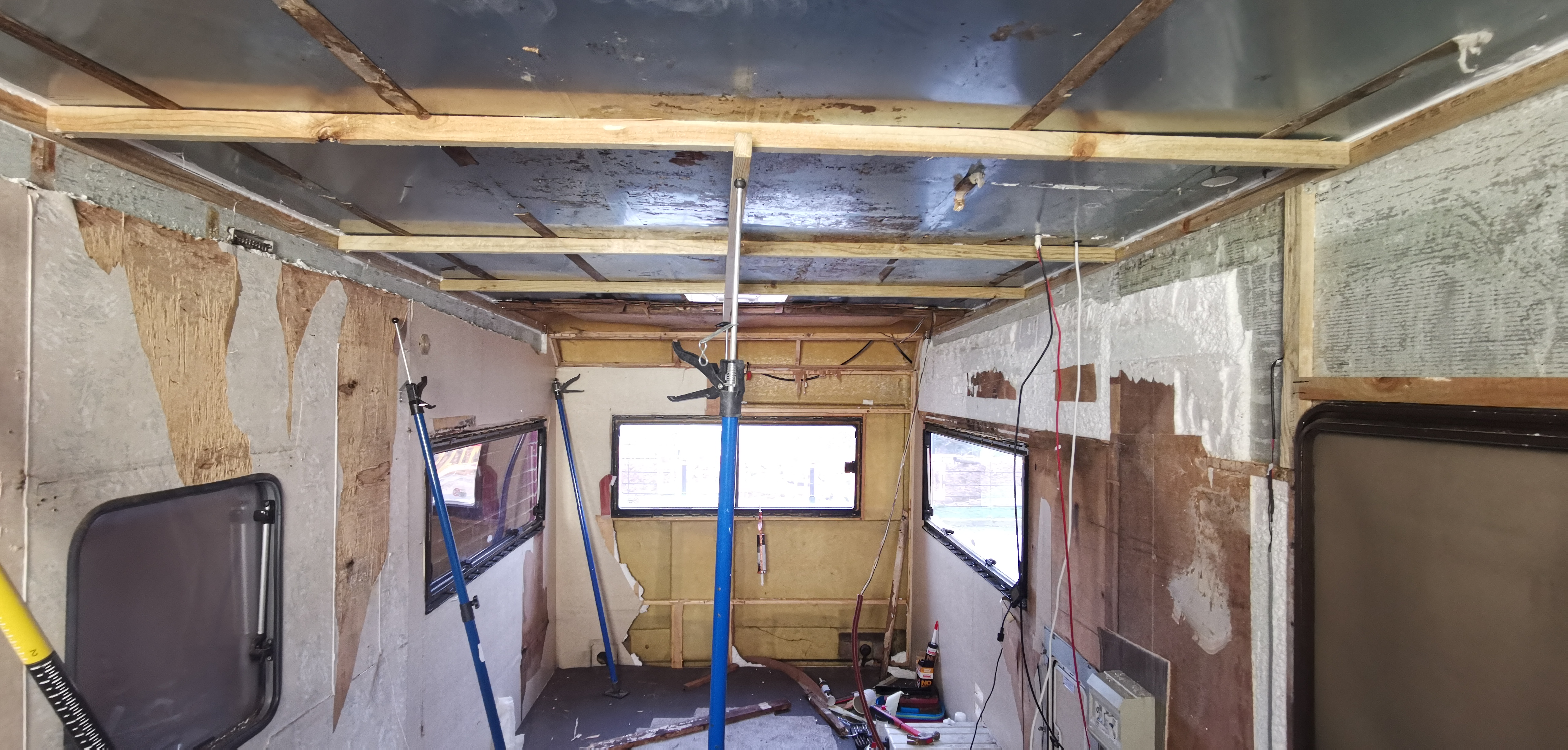

Yes, the material above is ally and this picture that you see there was an early one, I now have trusses a bit more frequently but it still sags, I can't go anymore that 25mm otherwise I would have to completely reconfigure the interior as the cupboards would no longer fit.
This is a more recent pic and when I'm done there will also be 4mm plywood above the trusses and below the aluminium skin.
I'd like to go with a harder wood I rekon but not sure what to go for, any ideas?

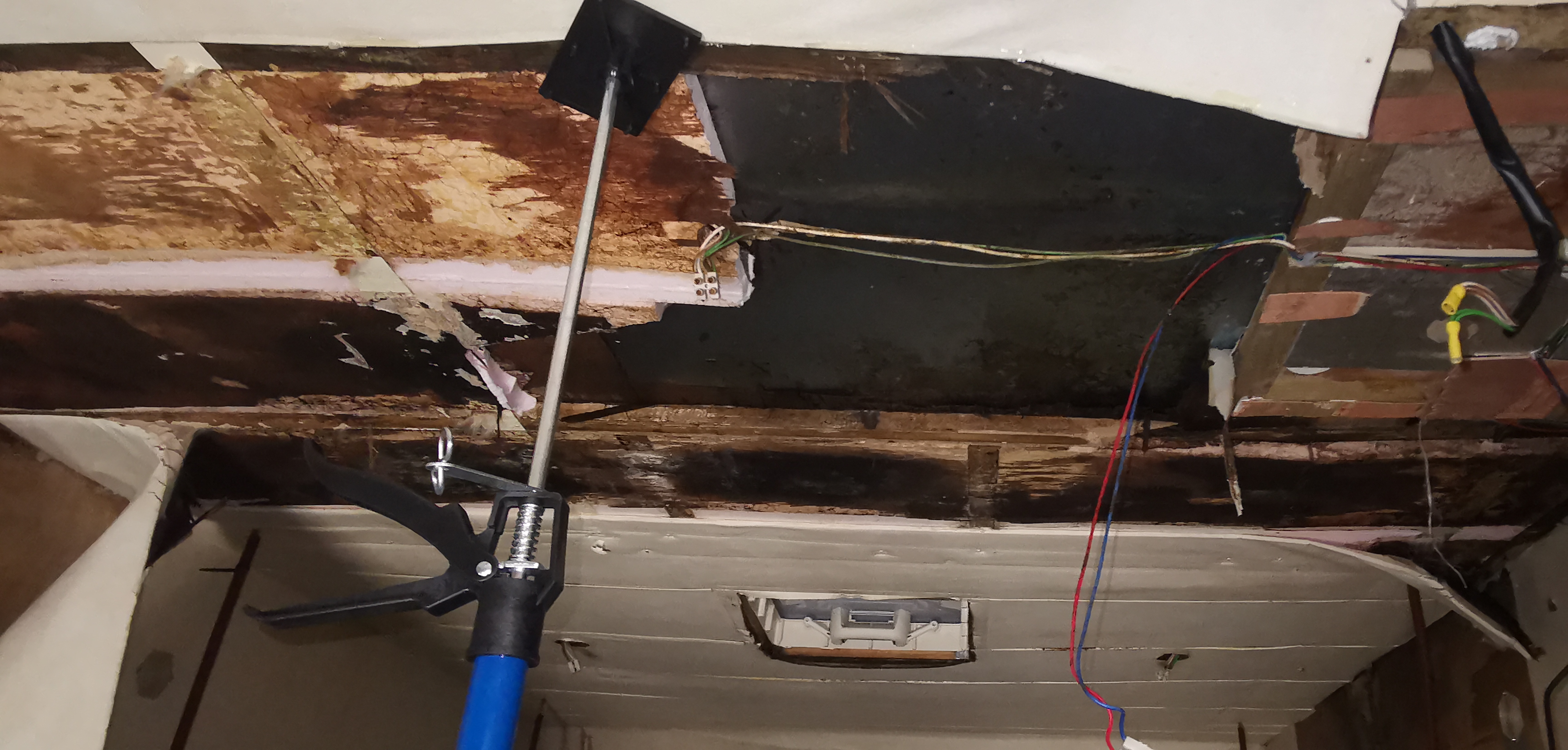

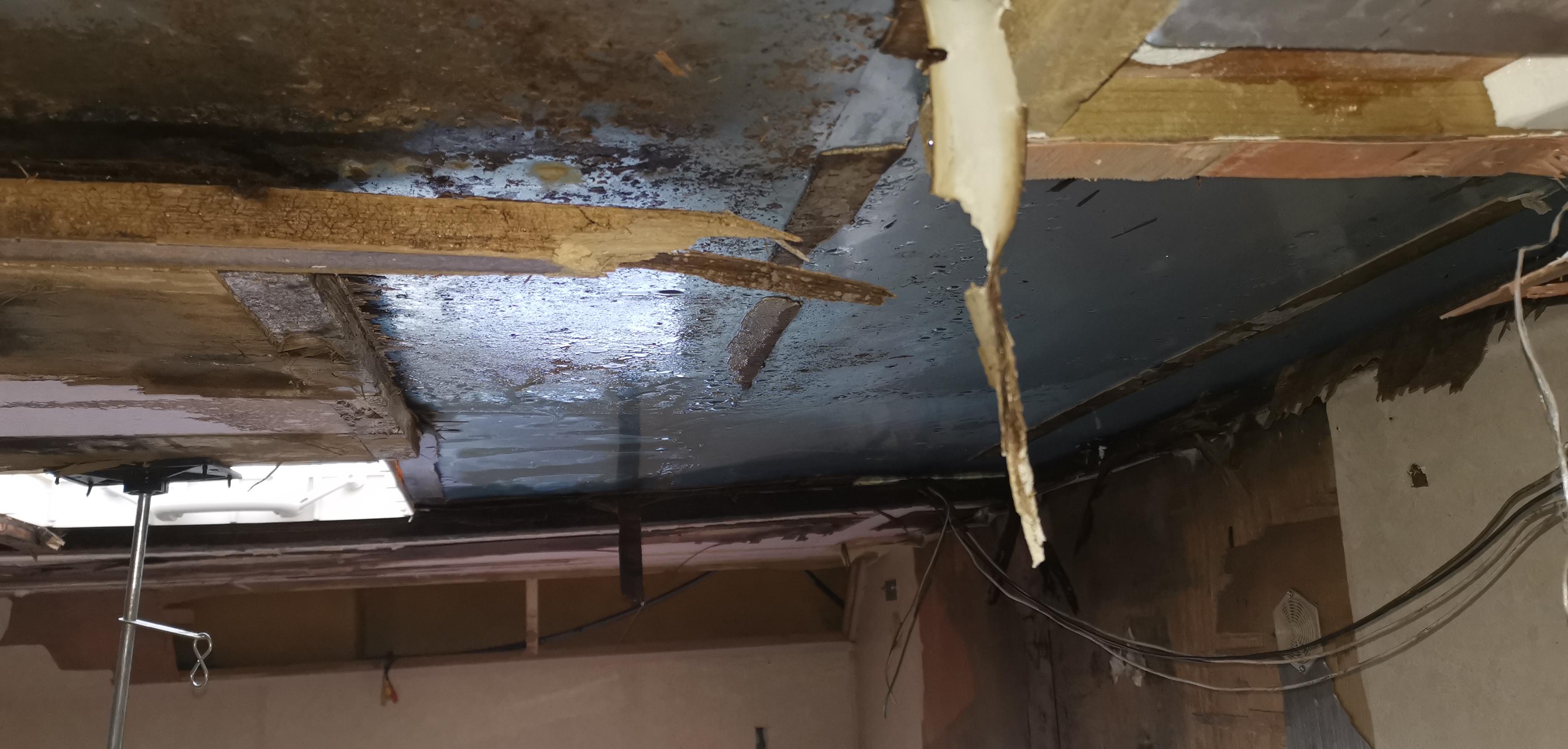

Yes, so above the trusses it was 4mm ply then the trusses glued to the ply then rigid insulation between the trusses and then vinyl lined ply sheets glued to the underside, please see below images.
No, I haven't fitted the cross pieces permanently yet as I still have to take them back out to get the ply above them, do you think the strength will come when it's all glued together?
My main concern is that the sag remains once all glued together and then I've got a real problem on my hands as I'd have to wreck all of the insulation, the plywood and the finished ceiling to put right.
