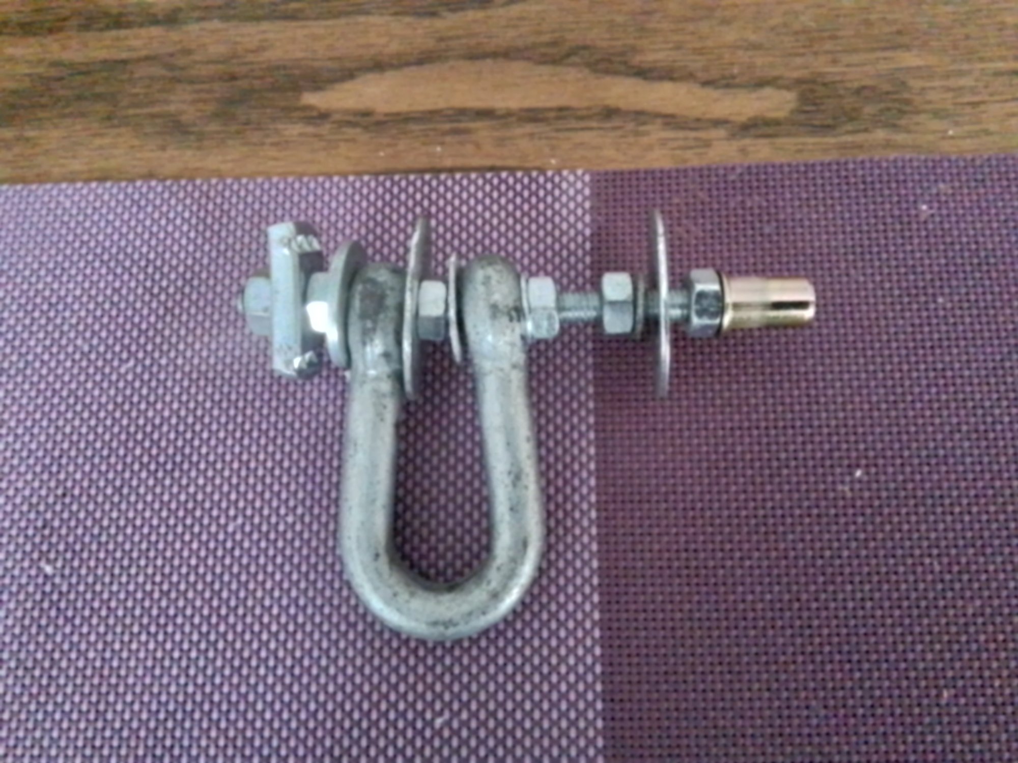

I'm in need of a rivnut tool.

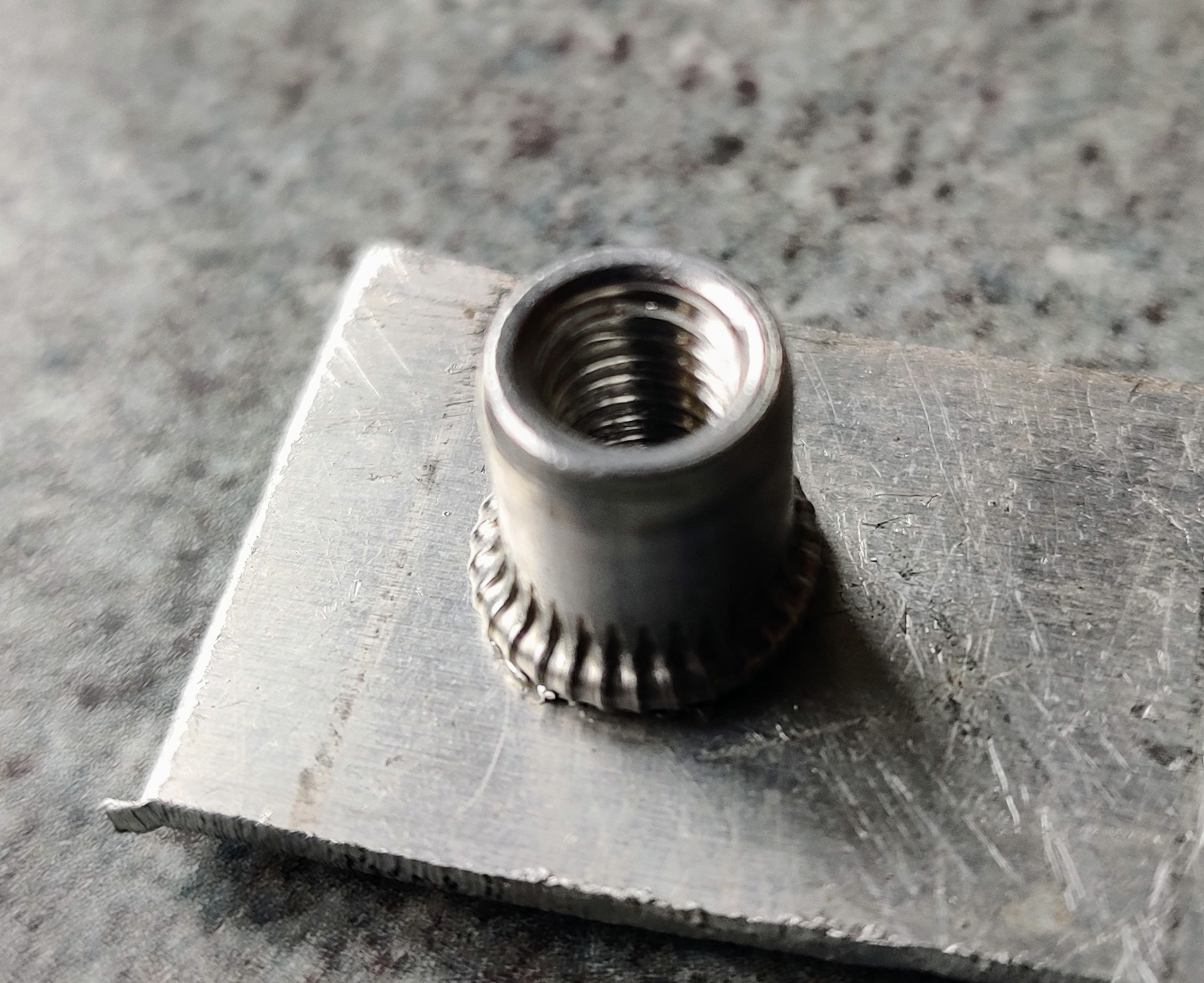

nice one Colin ,only thing i'd add ,is to cut a small notch or two in the edge of the hole after drilling , with a jigsaw or file . the rivnut will squeeze into these and prevent rotation , and make setting ,and future removal a bit easier . my daughter's ambulance had hundreds of rivnuts , none of them were notched ,and about 50% of them spun when i tried to undo them .

What a brilliant idea. The rivet nuts holding the light cluster lenses on the back of the Laika started turning when I needed to change a bulb. What a job getting to the back to hold it while I undid the screw in the lens. Some idiot in a factory decided that steel ones were good. Trouble is they can get wet and damp and of course steel rusts and bingo seized solid.
Notching the hole is a good idea should you ever want to remove the rivnut and/or bolt. I'll remember that one, Nigel.
