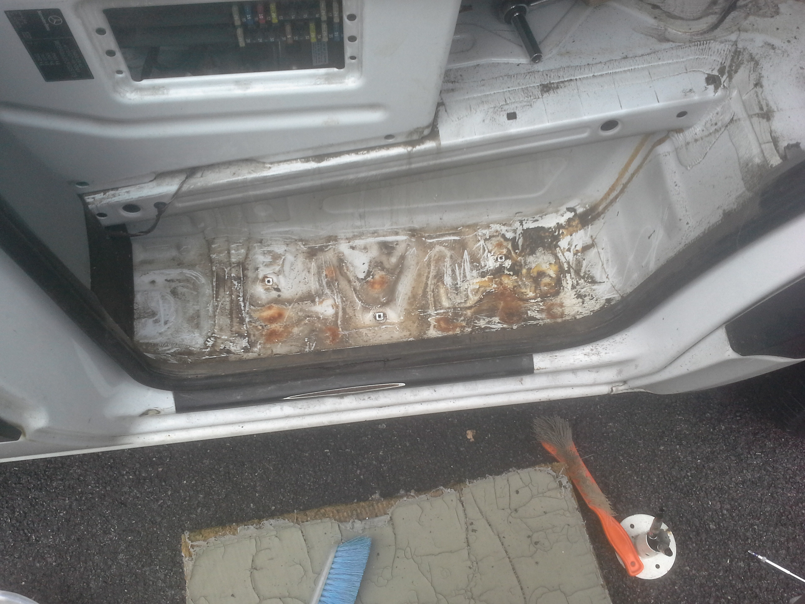

I had a look at the photos I took from when I started my conversion and it would look like I never had reason to take the step covers off? I thought I might have done to remove the floor covering but it would seem not. The following picture may be of some interest as it shows the cover without any flooring in place

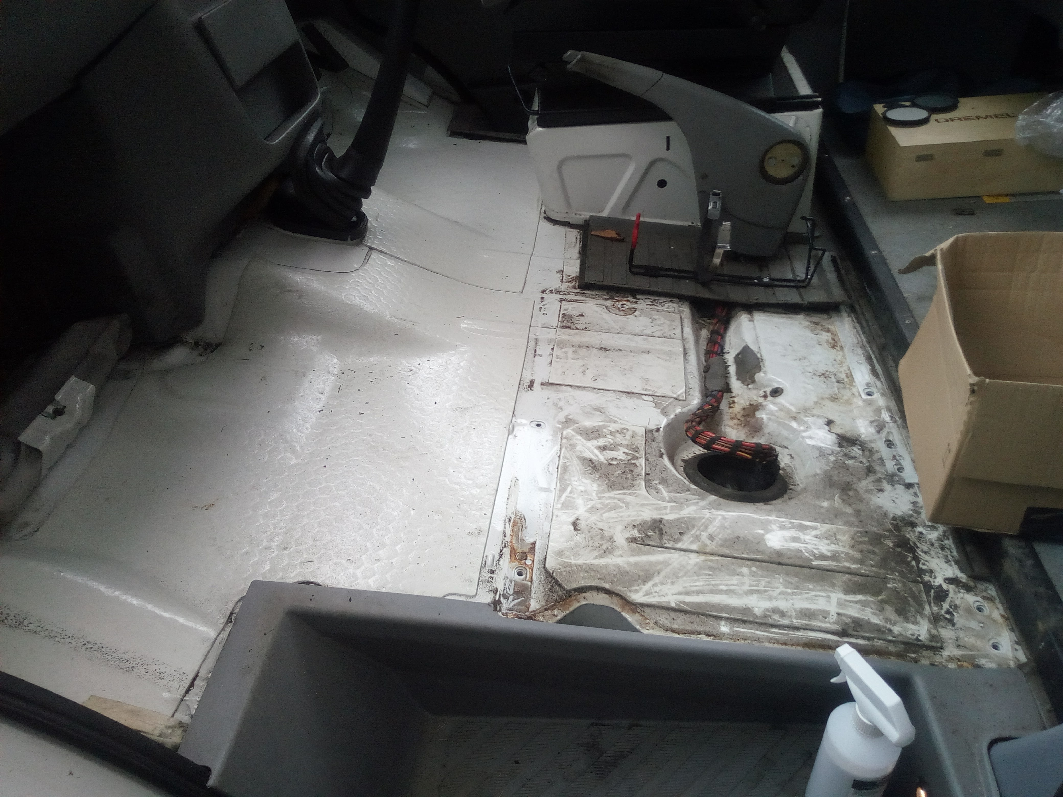

This is my T4 with the step off -
the top 3 rectangular white bits are where moulded clips on the step cover push in; the bottom 2 (should be one in the middle as well but rusted off) are clips that would be attached to the step and then push into little grommets in holes in the floor.

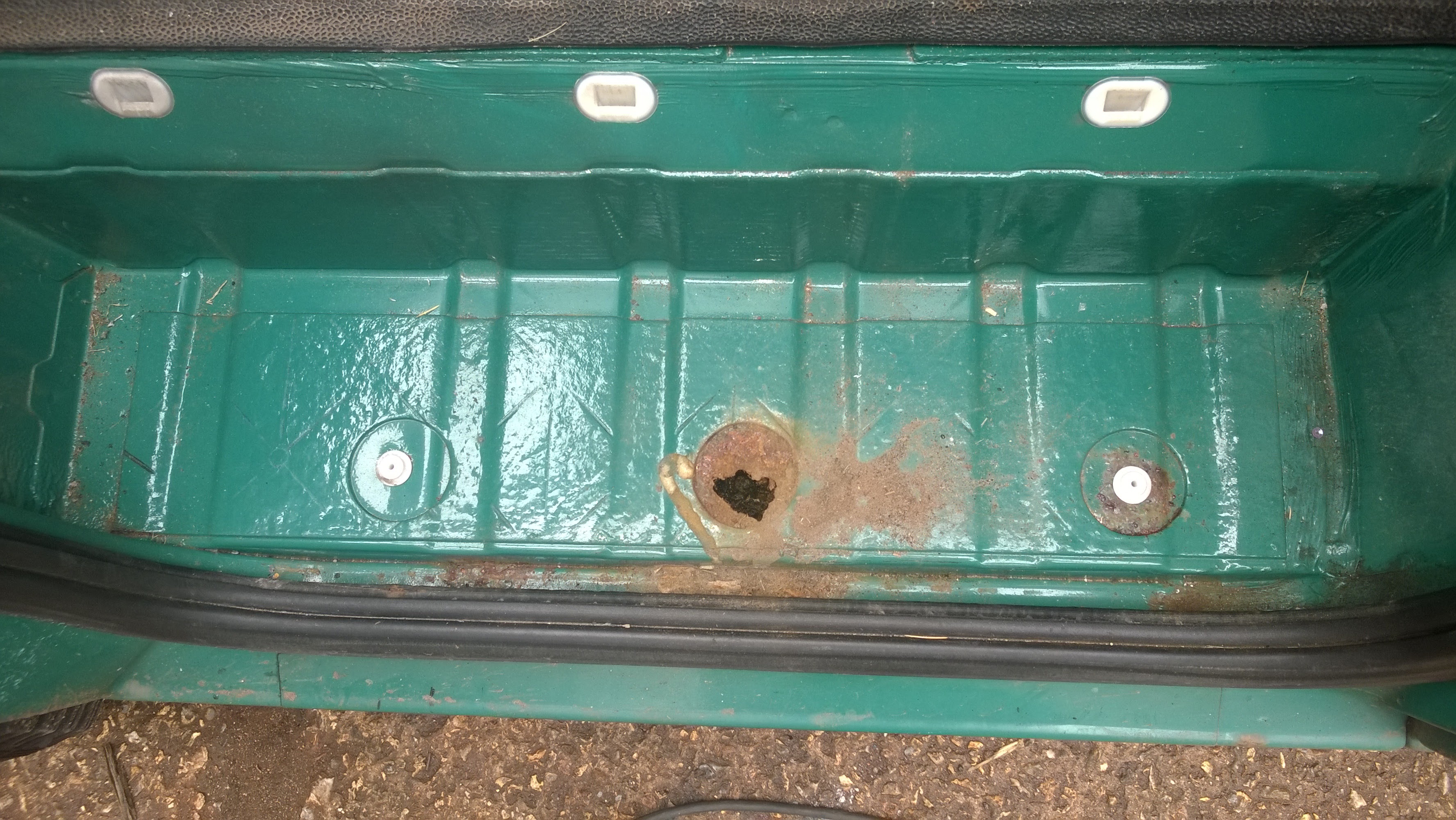

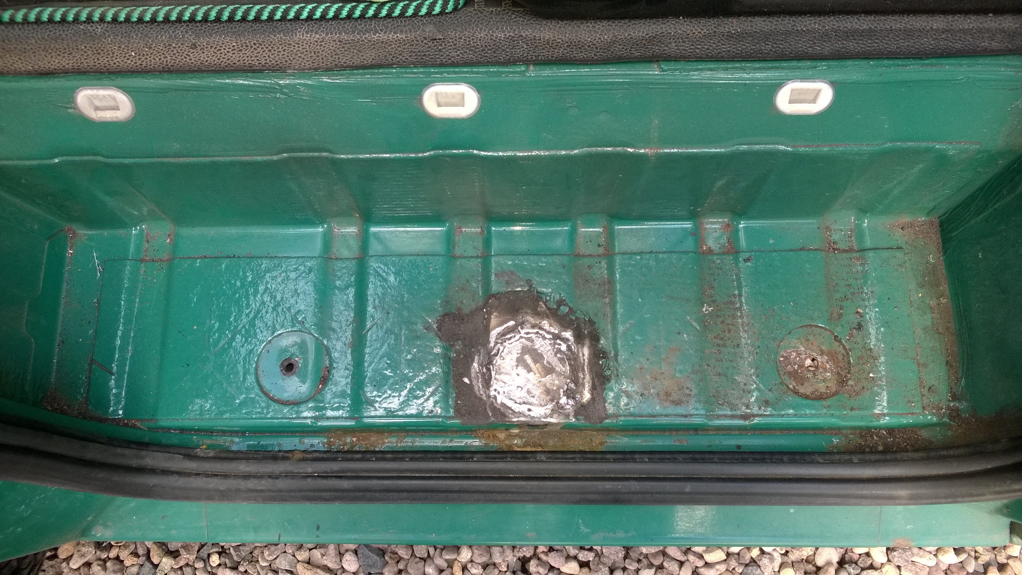

Its only thin metal. So as above , fill for the screws from under neath on outside. To find blanking caps. Evan the newer ones have problem's as no drainage at step.
I've also only done drivers side. I used wire brush attachments on drill to clean as its sort of corrugated for strength.

I have just looked at my T1n and there are three round covers on the tread plate, this is on both the driver's and passenger side. (y)

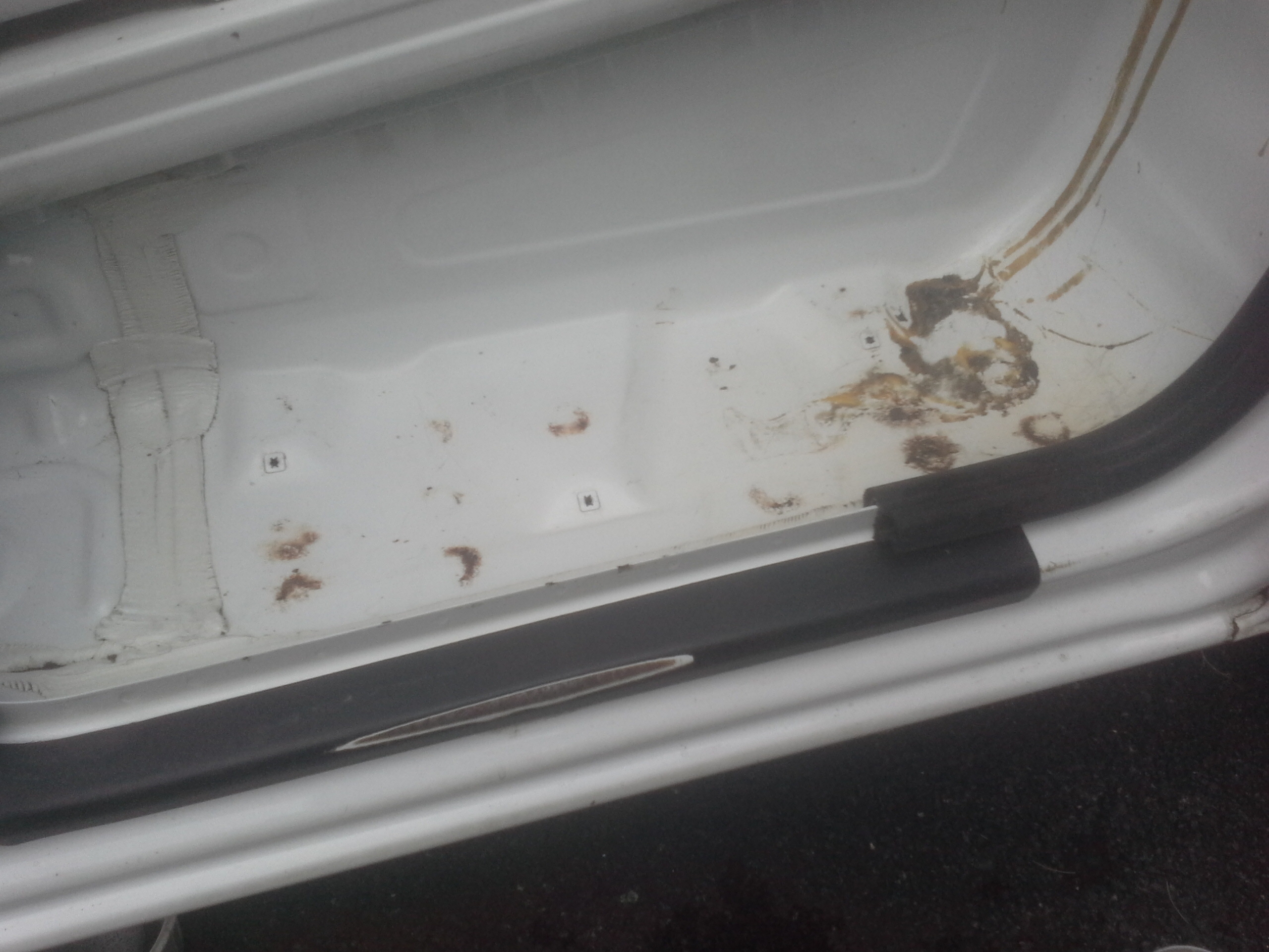

Did a search there myself now ..... There are some very worrying photos of what lurks beneath! looks like it is a real water/rust trap!
On my door step cill, I just needed a tiny repair of a little disc which my niece welded in for me. Sounds like the Sprinters need a drain added?

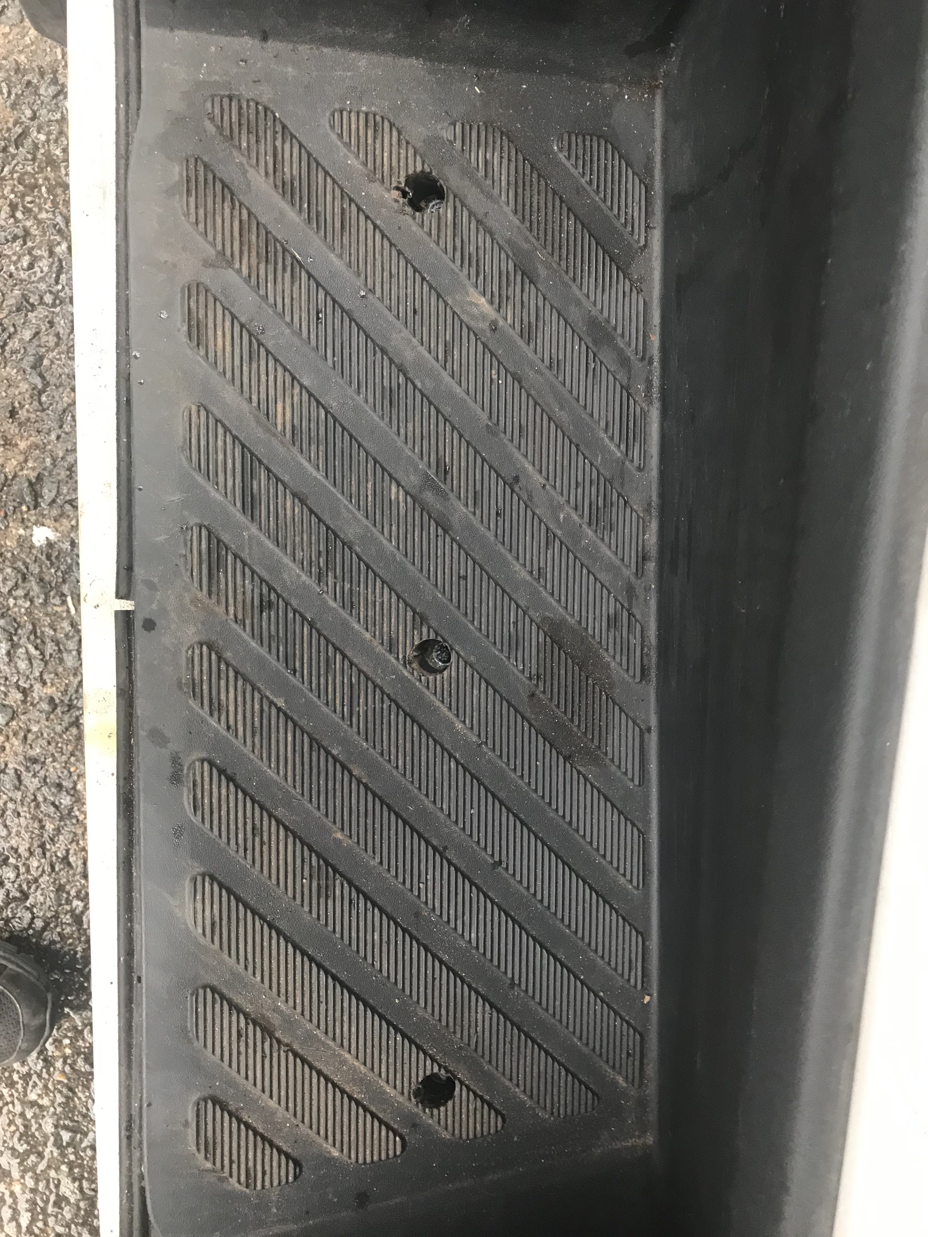

I was about to take a pic to post showing there was nothing there when I spotted one in the middle. Bit more looking and I spotted the other two. The bungs that went in were a perfect match and very hard to see even with my glasses on. Took bungs out and then took a pic in case anyone needs to know where they are in future.
Thanks folks, I would never have spotted them without your input

I would be interested to know what condition the metal underneath is in as I expect mine may be similar?

I couldn’t find the right size star driver yesterday so son in law bringing his over this morning. I know drivers side is very good apart from dust and dirt that had got behind it but it wiped off okay, hopefully this side will be similar but I will report back 👍
Had the trim out to run the cable I wanted and it is almost like new underneath it. There is a drain towards the right end in the centre of the step.
